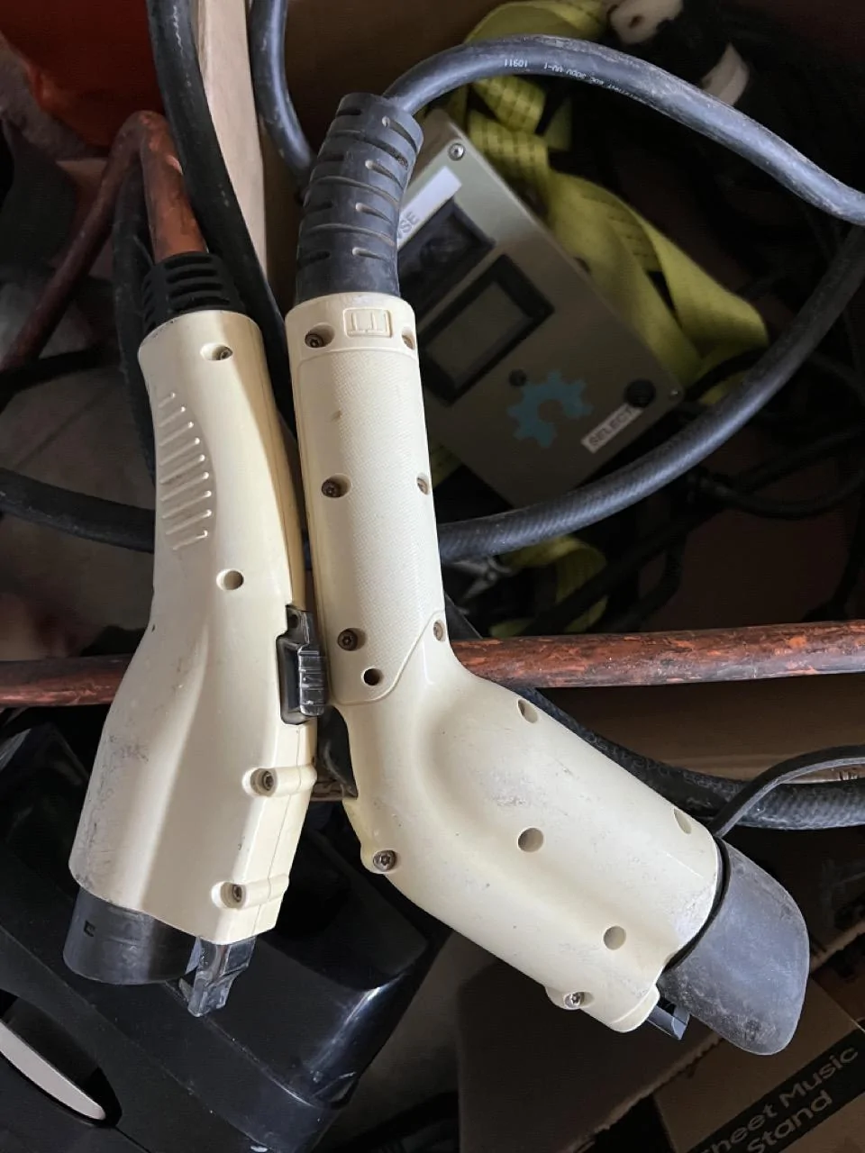

Insurance concerns aside, there's nothing esoteric about changing out the J1772 head (J1772 is the standard). I've built several EVSEs. Aftermarket heads are easily swappable although Ford's mobile charger has a sealed one and the FCSP likely does, too. But if you're worried about liability then sell the FSCP and buy a much smaller EVSE. You can see one of my older ones in the background--it's smaller than a shoebox compared to the torso sized FCSP.
Ford F-150 Lightning Anyone replace the CCS for J1772 cable on the Charge Station Pro? IMG_4374 Lar
