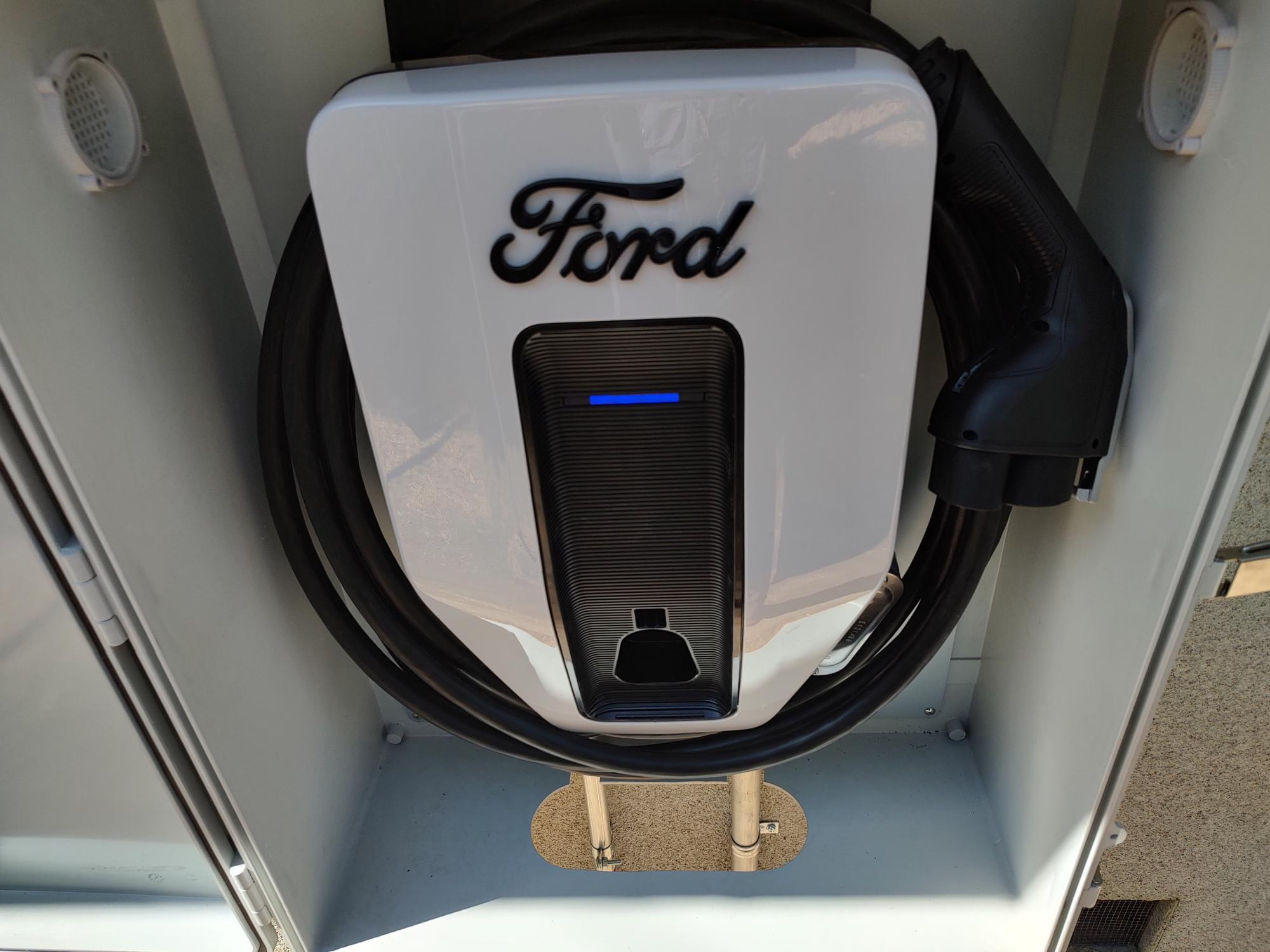

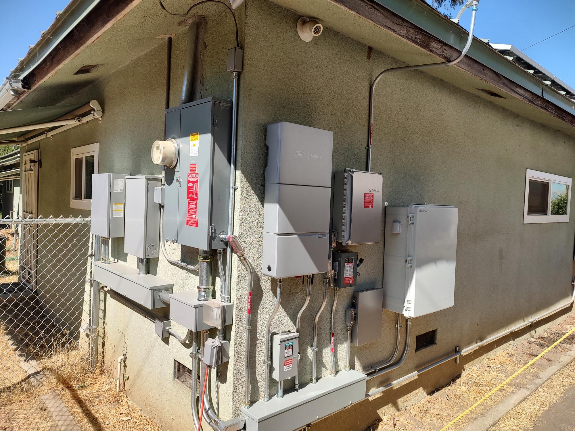

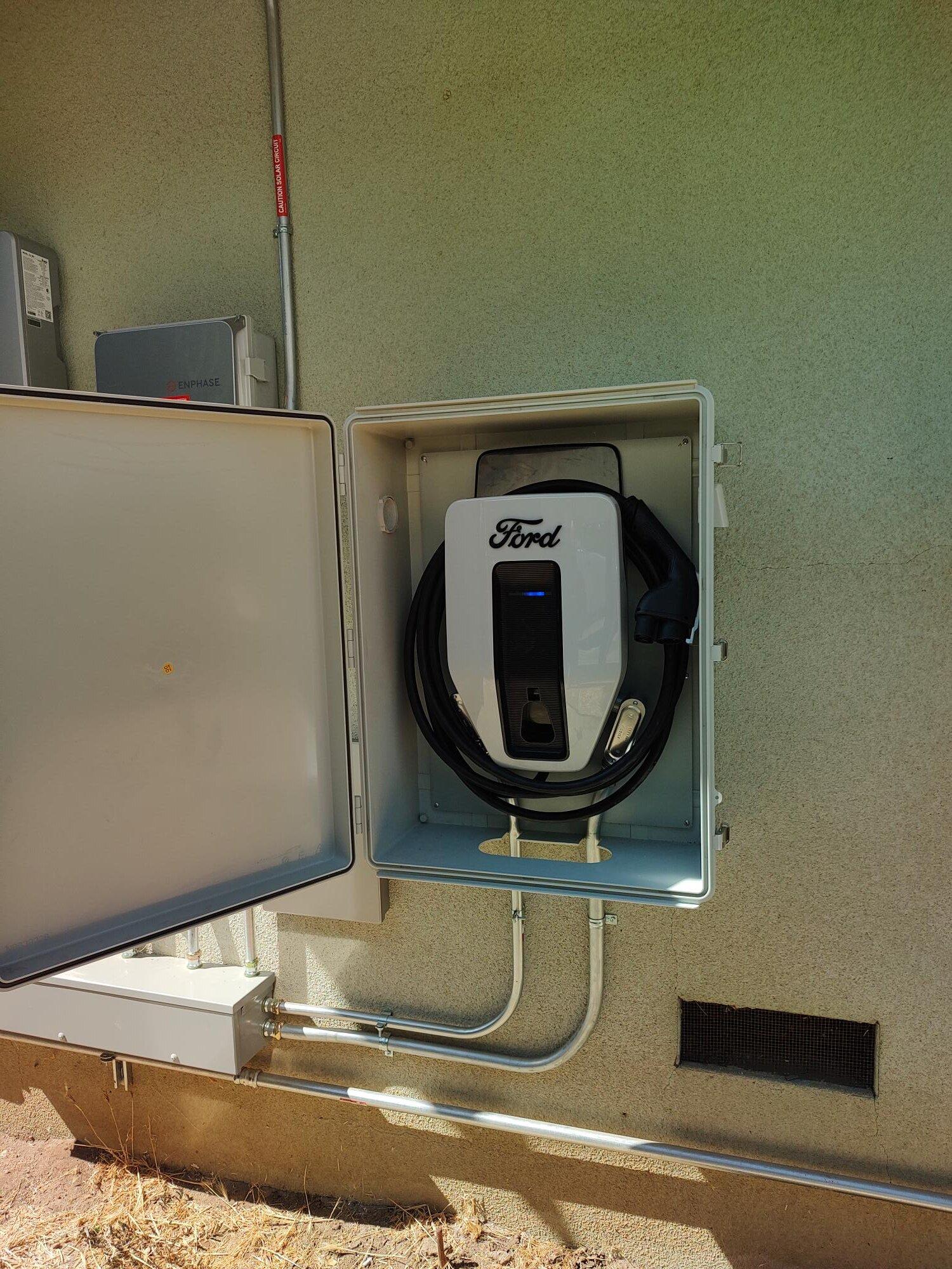

Installation is complete as shown in attached photos. The original plan was to install the Ford Charge Station Pro (FCSP) and all of the Home Integration System (HIS) inside my air-conditioned utility room with a feedthrough tunnel in the wall that would allow passing my 80A power cable/connector to the truck parked in my driveway just outside. A weatherproof box, covering the feedthrough tunnel opening on the outside, would both insulate my utility room and provide a protected hanger for my 80A power cable/connector when not connected to the truck.
However, I determined the feedthrough tunnel idea violates code (NEC 2011 400.8(3) which states that flexible electrical cords of any kind may not be passed through windows, ports or any other opening in a wall.)
New plan realized: Entire system installed on the outside wall with a weatherproof enclosure housing the FCSP (shown in photo). Screw the elements, I'll rely on the Ford warranties if heat becomes a problem. Ford Sunrun installed the system, and they liked my plastic enclosure* for the FCSP. It's working well. The bi-directional inverter works well, providing 80A fast charging to the truck, and (simulation-tested) backup power to all house circuits.
The only hitch in the installation is that I have not yet successfully synchronized the FCSP app with the Ford Pass app. Ford Sunrun was baffled and the installers left after demonstrating that the system was otherwise functional. I have an open "case number" that Ford Sunrun initiated with Ford. (Ford said, "call Siemens" and Siemens said, "call Ford." However, @FlasherZ has provided the probable solution, above in this thread. Since I currently have full 80A charging and HIS power backup for my home, I'll wait until power grid outages are less likely before I "reset and start over" on the app syncing.
* The enclosure is a UV-stabilized PC/ABS plastic with a steel backing plate that allows Wi-Fi connection to the FCSP unit that it houses. Weatherproof air vents were added on the sides near the top for heat escape, cross-ventilation and membrane dust protection. A 3.5 in x 10 in slot was cut in the bottom to allow the 80A cable and connector pass-through for weather protection and privacy during connection with the truck. This enclosure is "Qilipsu Waterproof Outdoor Junction Box 32.7 x 24.8 x 11.1 in" and IPV-1115 vents, all purchased from Amazon. (This box was 1/3 the price of the USA-made (Bud Ind.) NBG-20011 with IPV-65100-W vents.) The advantage of the Bud Ind. box would be a removeable, hinged swing-out door whereas the Qilipsu box door is not removeable. The box is not deep enough to allow the connector to be docked in the FCSP holder. However, (as shown) the connector can be securely placed atop the cable coil when stored. I'm satisfied with the protection and privacy afforded by my box.
