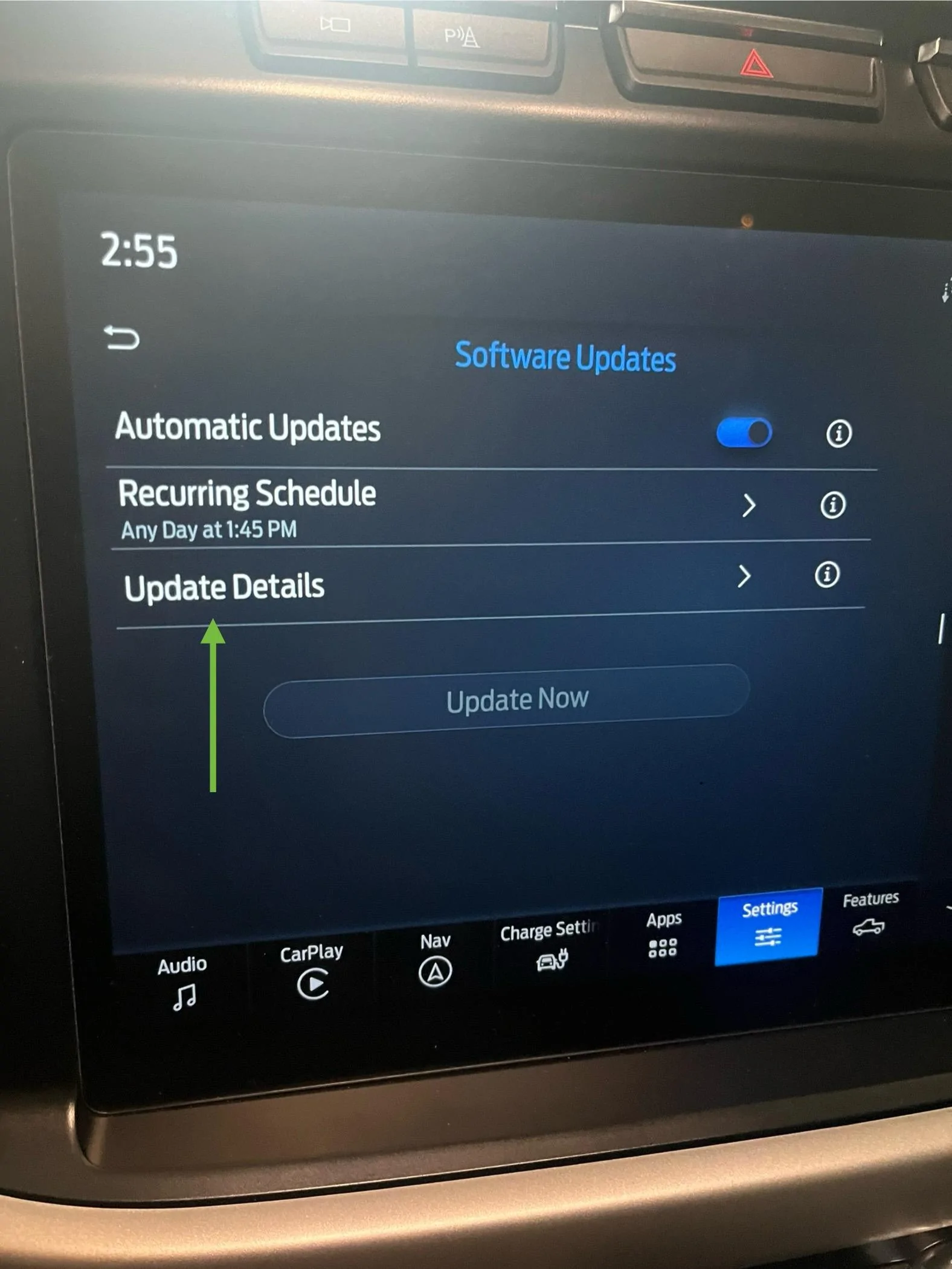

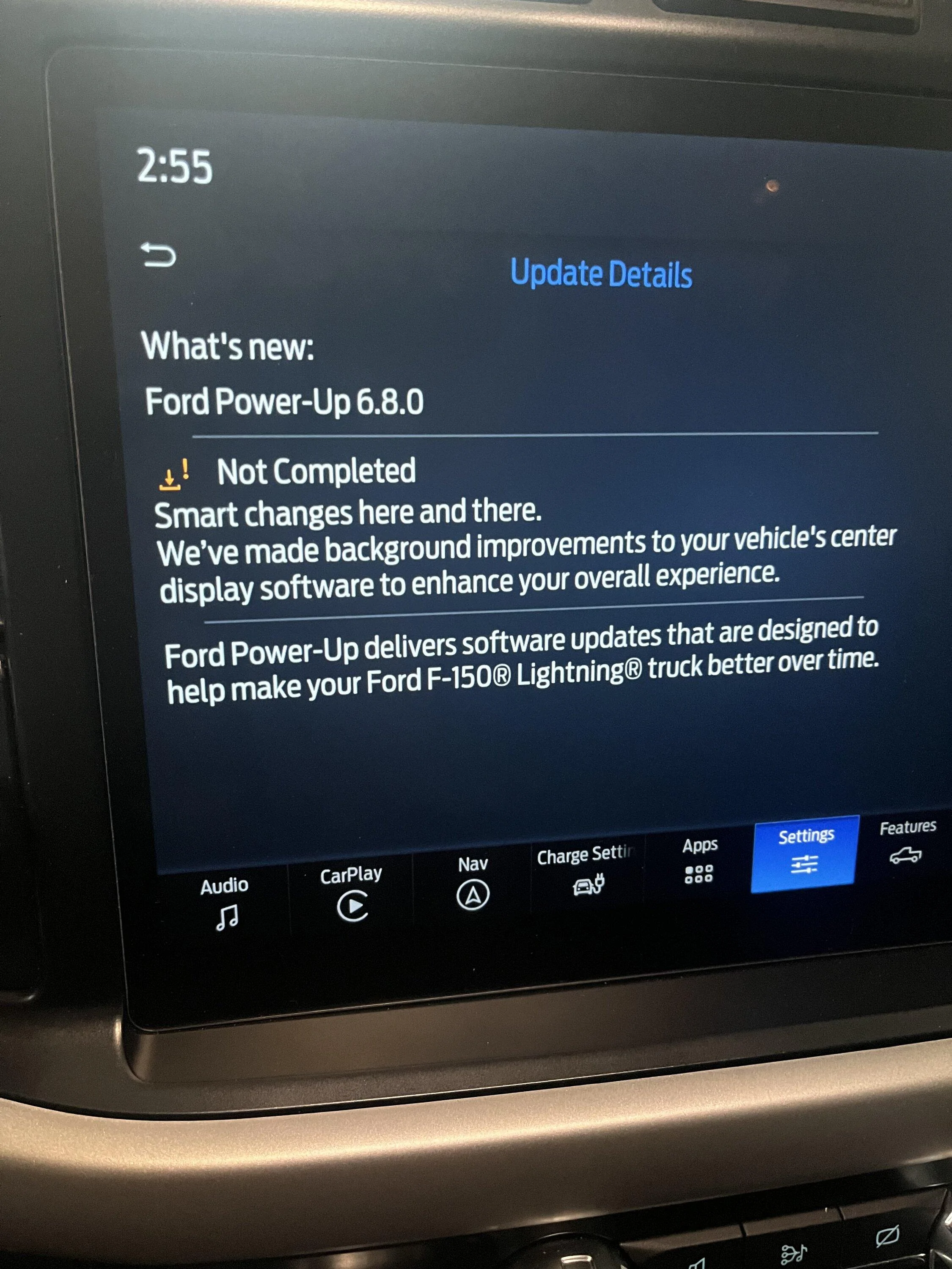

Here is a picture of mine
That is different than the update version shown in my previous post.
I suggest looking at the Software update version under the settings tab.
I guess I am a it incredulous if that is the version that you are on. if so @Ford Motor Company needs to fix their broken system

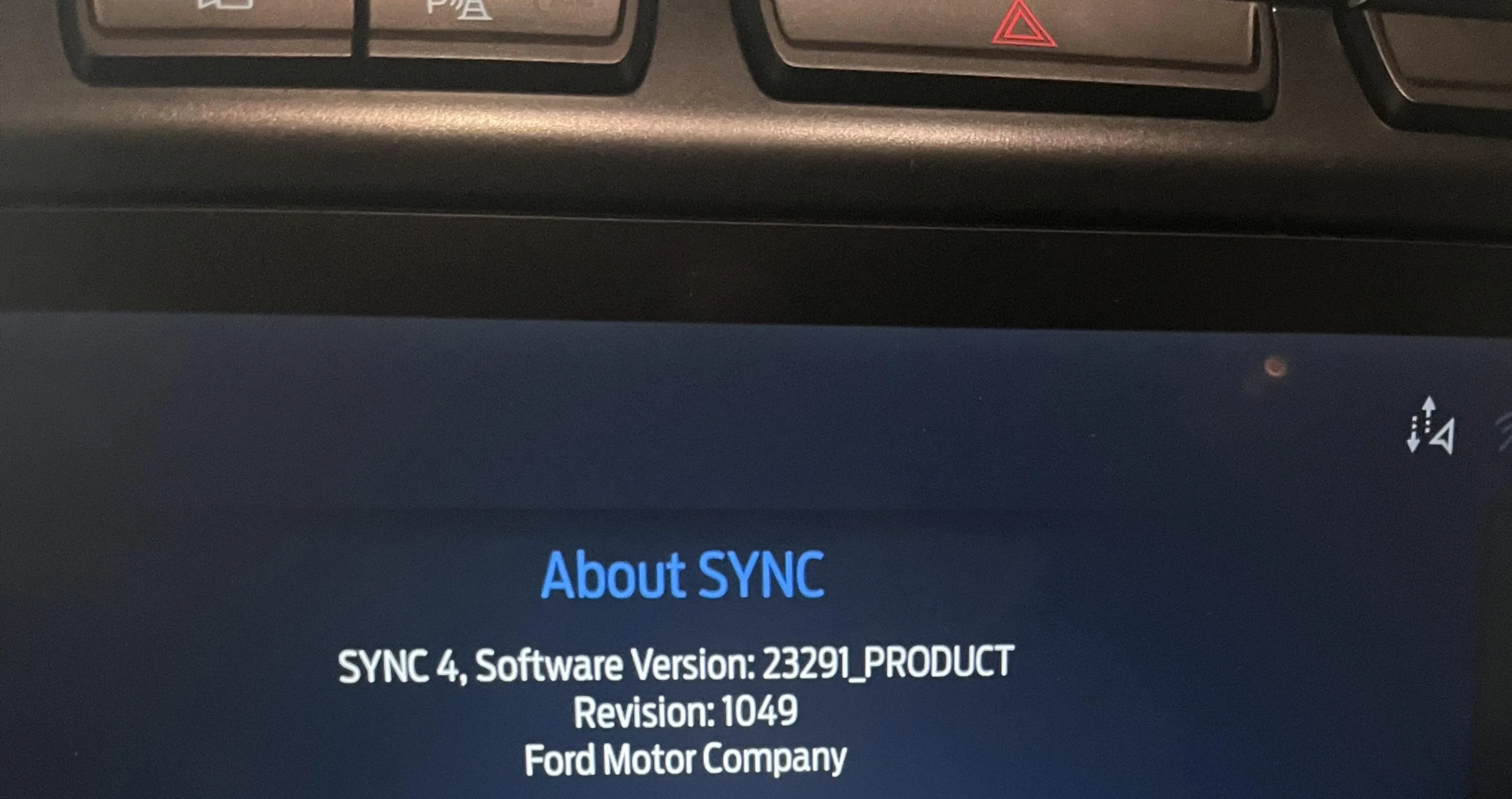

4.0.23031 is your SYNC version. And it can be seen in Settings > General > About.
Mine shows SYNC 4 Software Version 22326. So you are ahead of me. Those that have a blend date around May have not received any type of update. So this is the version that came with my truck. SYNC is just the infotainment system.
6.x.x describes the Power Up version. These are collections of module updates. And rollouts of these types of updates are not necessary in order. Some people report getting them out of order.
When your dealer says your truck is up to date or has no updates, what they mean is that what ever rollout strategy Ford is using has not yet selected your Lightning as eligible for update.

is that what you see when you check as shown in the pics below?
