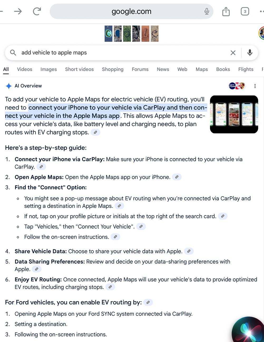

I have been trying to add my lightning to my Apple Maps to be able get the charge routing depending on my trip. I can’t figure it out in any way. The info given on Apple and google say there should be a “add vehicle” option but can’t see it ANYWHERE. Any help with this would be great.

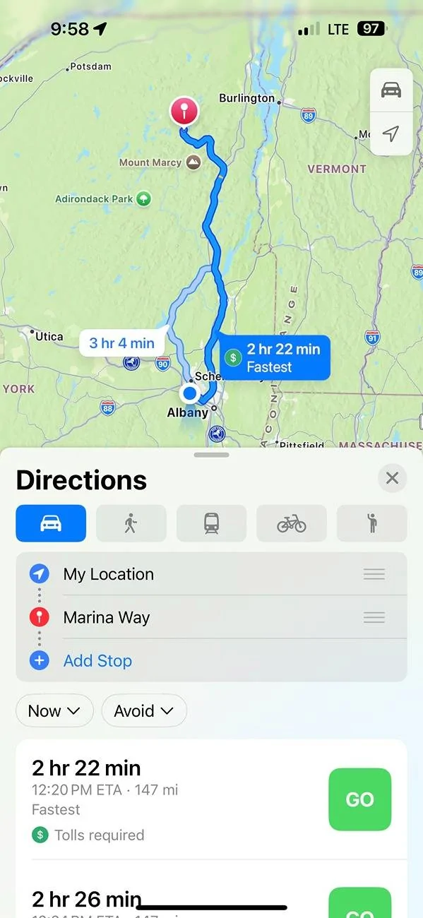

I cannot get the "connect" option to appear in Apple Maps that will allow me to add my Lightning.
Here's my info:
  • 23 Lariat SR running SYNC 4 Software Version 23159_PRODUCT, Revision: 915
  • Apple iPhone 15 Pro Max running iOS v18.4.1
Followed instructions listed on Apple website here.
Connected to Apple Carplay while sitting in truck.
"Connect" option does not appear after getting directions. Used both Apple Maps app on phone and Carplay. No "Connect" option appears after setting destination. See screenshot below.
Deleted Apple Maps app from phone and reinstalled. Still no "Connect" option.
Clicked on my profile in Apple Maps. No "Vehicles" sub-option available.
Deleted phone from SYNC and added again. Still no "Connect" option.
Went to the How do I use Apple Maps EV Routing for Apple CarPlay? on the Ford website. Noticed it states this:
2022 and 2023 MY F-150 Lightning vehicles may require a software update.
No updates available when I check the Software Update location on my truck's screen.
What do I have to do to get the ability to add my truck to Apple Maps?

I figured out the most important step is you HAVE to have connected to the In truck “sync” system. That’s what allows the two things to talk.
Cvh8601
Jun 22, 2024
81
109
2023 Lightning Lariat
Do you happen to know what software updates youve received? Apple maps integration was added in I think 6.3.
do you have your truck connected to your home WiFi and is the 12V > 85%? I’d assume you’d have gotten that update by now but if not giving the truck a chance to catch up could be worthwhile. Or a dealer visit to get caught up
