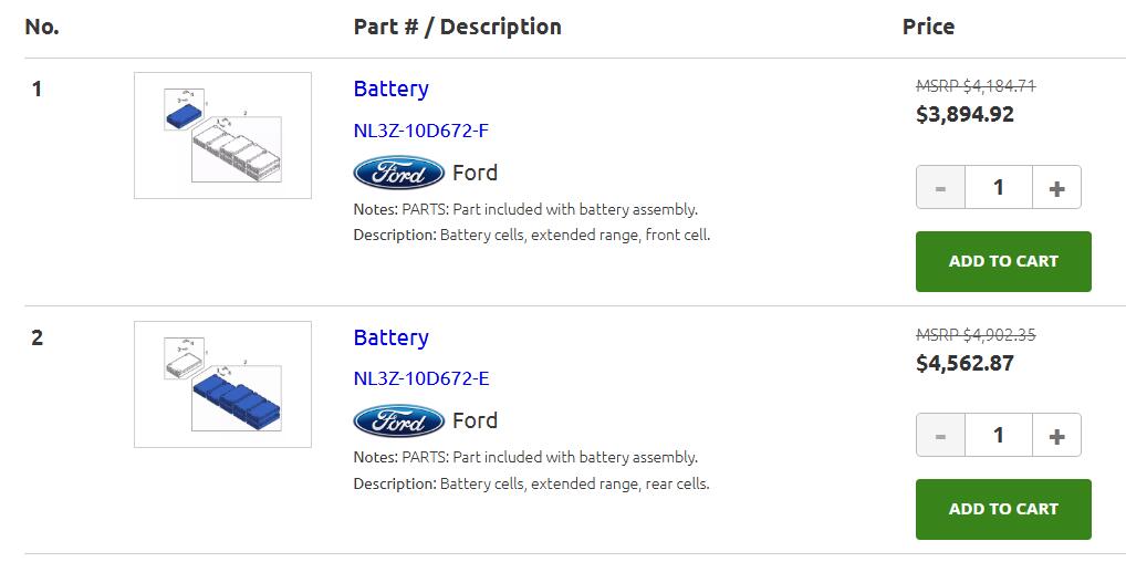

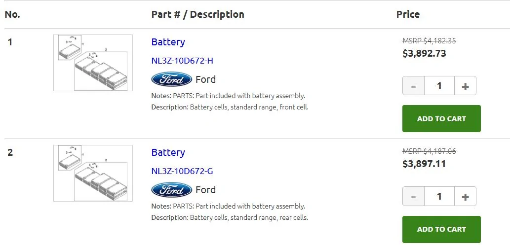

I get about $40,400 for the ER battery module parts from this list (1 of part #1 + 8 of part #2). I also got an unofficial estimate from a Ford dealership at about $49,000 for a total ER battery pack replacement.
Right, the top of the list on that URL shows complete pack cost, but it's more likely we'll experience one or so module failures not all nine of them.

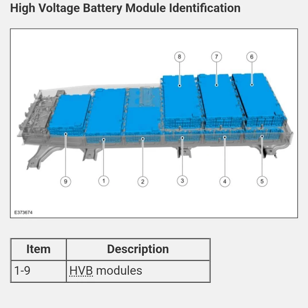

Just picked up my truck a few days ago after 22-days at the dealership for replacement of battery module #6. My invoice listed the repair cost total at just over $4,000. About half of that was the battery module.
Is module 6 smaller than others?
