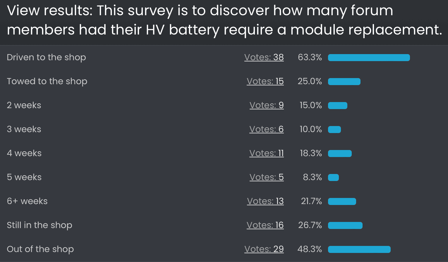

Ford F-150 Lightning Battery Replacement Module Survey ?? 1716214742364-rq
53 drove or towed their truck to the shop but 45 have their truck in or out of the shop. What happens to remaining eight?
