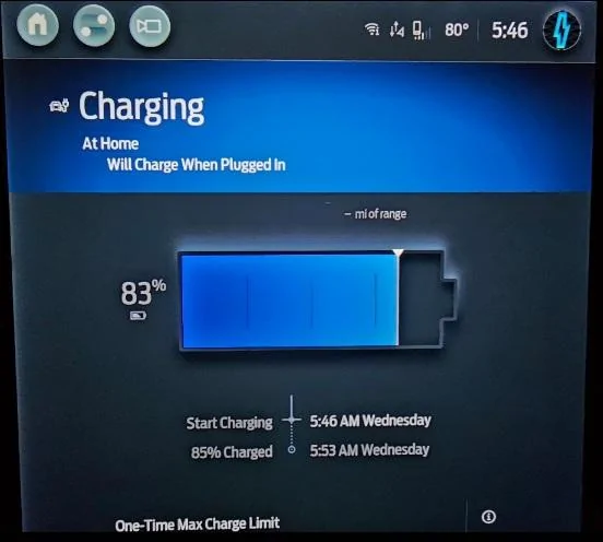

Well, I found my missing battery percentage.
Charged to 85% last night. As soon as I unplugged, it dropped to 83%.
And, ironically, I had my best efficiency ever this morning on my commute.
I always charge to 80%. I’ve noticed lately that as soon as I back out of the driveway, it’s 79%. It didn’t used to do this. Sometimes I’d drive 3-5 miles before losing the first %. It’s almost like charging used to overshoot a bit, but now stops exactly at 80. I know that temperature changes can play a role here, too.

I didn't even move when it dropped. All I did was hit the start button.
I think Ford messed something up with the charging software in the latest updates. I swear, it's one step forward and two steps back with this company. Nothing can ever get fixed without screwing something else up.

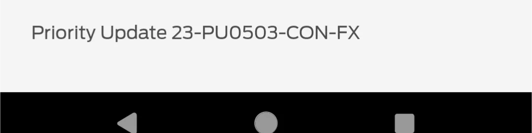

DO you recall which of the various recent updates brought on this issue?
I'm about to get this, and curious if I'll see a change like you are exeperiencing.
I can't say exactly which one did it. I got them all back to back and didn't really notice which one set it off.

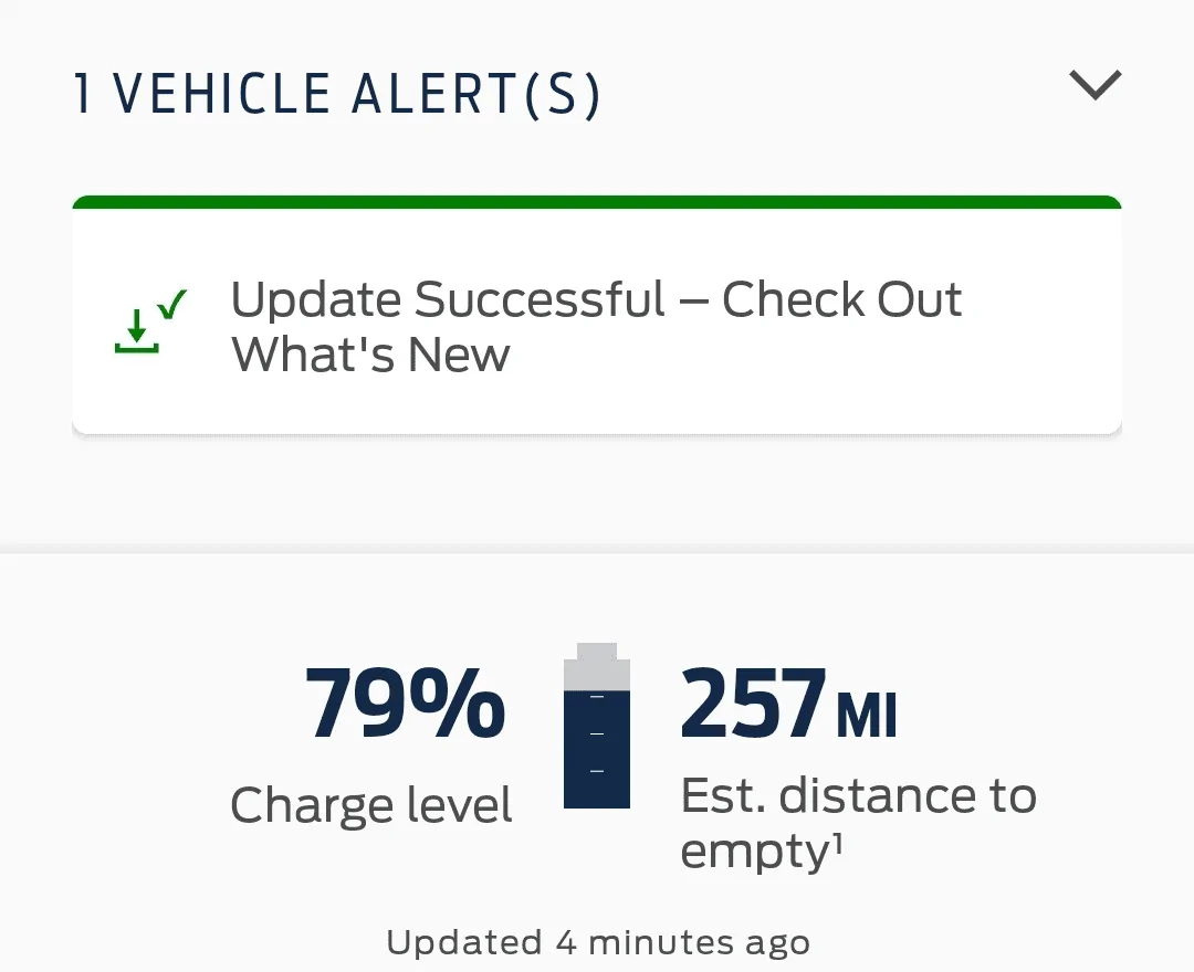

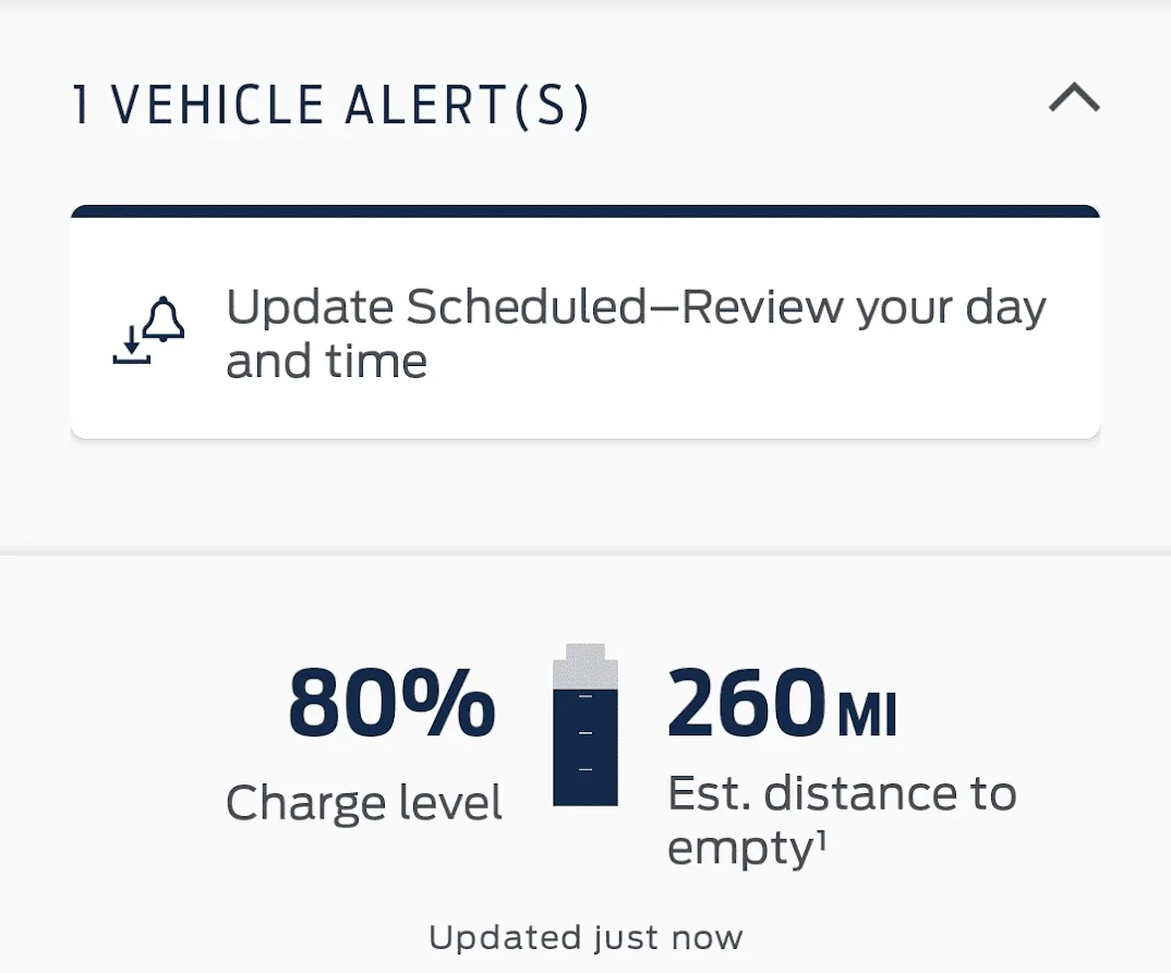

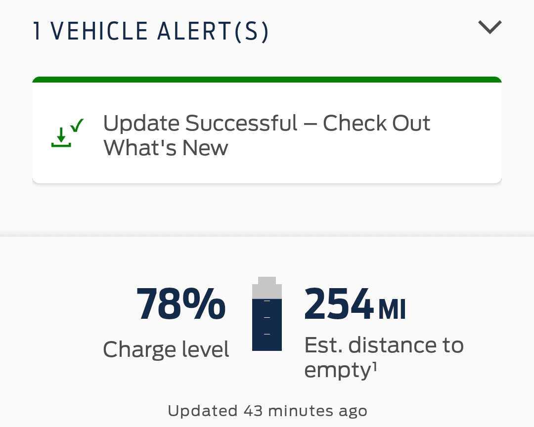

The above updated post flawlessly last night, this morning my SOC and projected range was not grossly affected.
SOC last night before update posted..........SOC this morning after 1.7 mile trip.

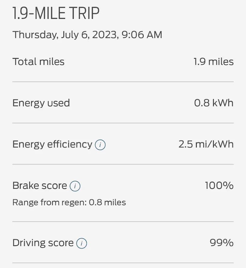

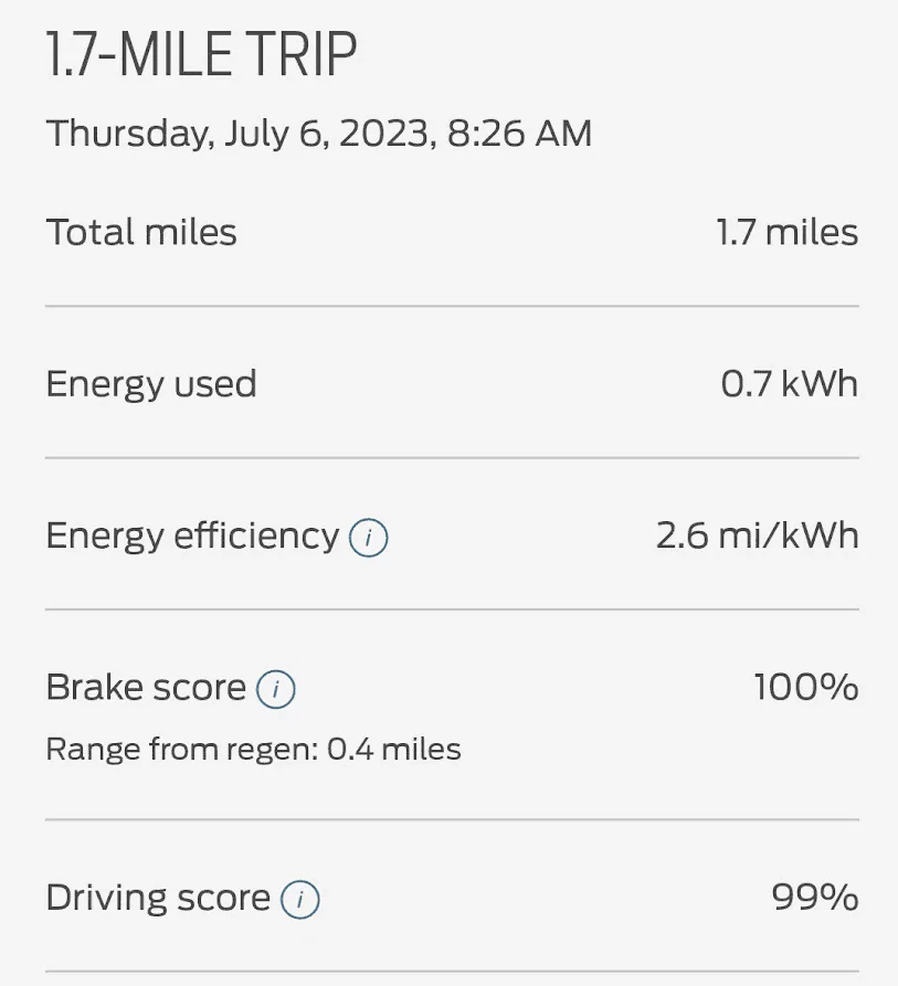

But like others have pointed out my SOC dropped from 80% to 79% in several hundred feet from the house. Got to destination still at 79%, then we returned home, SOC settled at 78% at the destination. Not using departure times, or remote start. It is a warm day, though the truck was in the garage overnight so she was not boiling hot, but sitting at the breakfast place ambient temp was already 85°
Both trip logs from the breakfast run:

SOC after getting home remaining range is within approximations of consumption, all things being equal.

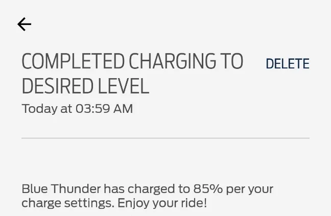

I forgot to look when I parked but checked a little while ago and my typical morning commute seems to be off. I got the notification that I hit my 85% target this morning, shortly after the PAAK update was applied. FordPass still indicated 85% charge when I checked while getting ready for work. I did not look to see what the truck displayed after unplugging (Ford needs to get off their lazy butts and give us SoC on EVERY SCREEN).
Bottom line, my morning commute has always taken 7-8% charge. Today it seems to have taken 11%. The drive log says I used 9.2kWh which is right in line with my normal commute. I have no explanation for where the other 4% charge disappeared to.
