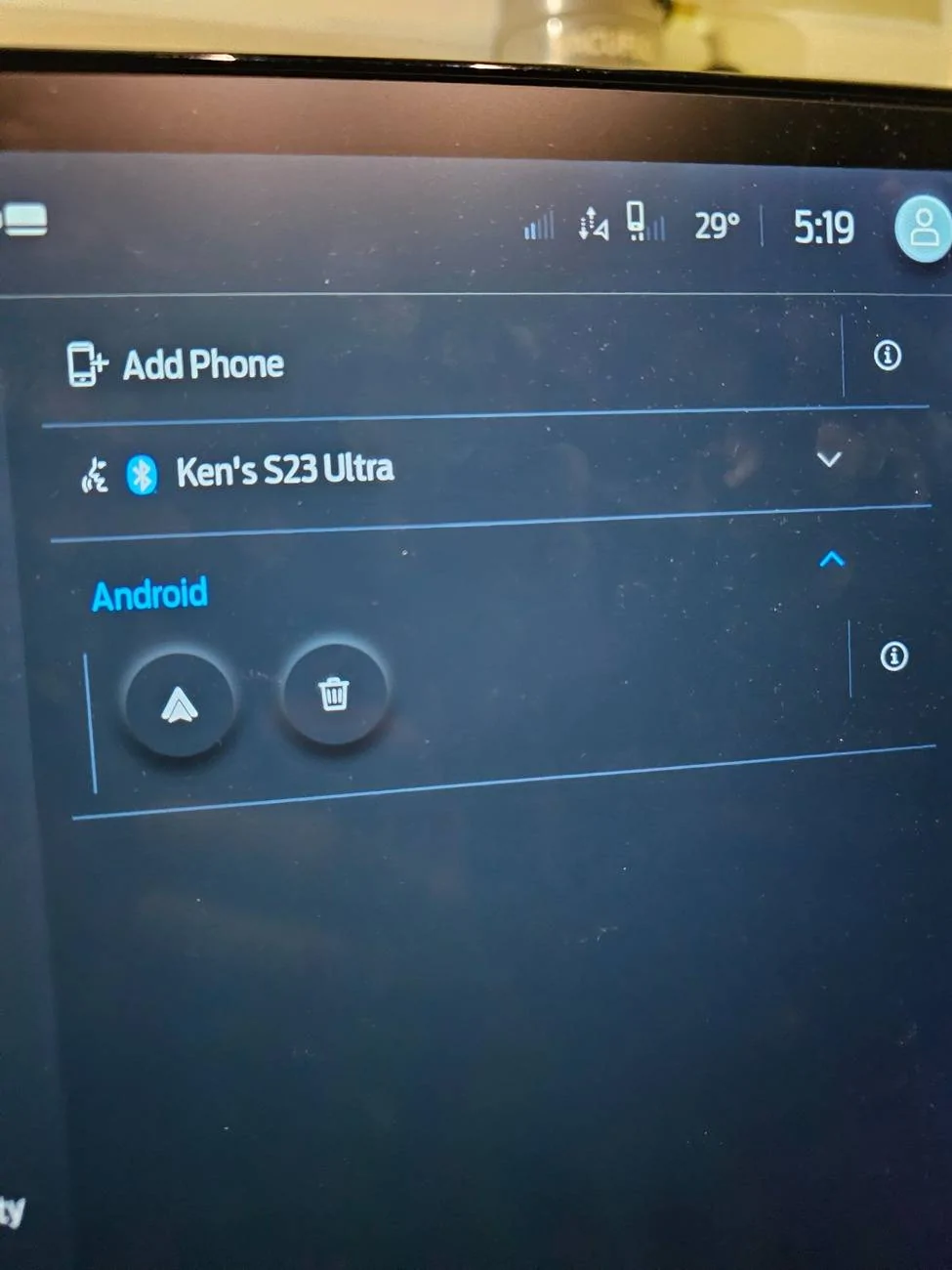

Update: my Carlinkit stopped working. I honestly think Ford did something accidentally or on purpose to disable it. Under the phone list, it was still there, but wouldn't connect, and there was a new "android" item listed that only had an Android auto option, listed below my phone.
I know it's still working in principle, because my phone connects to the carlinkit Bluetooth when I plug it in. But the truck never registers a carplay connection.
It was even heavily requesting that I enable my wireless android auto connection when I plugged it in.
Thoughts?

I've been meaning to post the same. I forget the exact message , but it was something along the lines of the Sync system does not support this android device. I will plug carlink back in & get exact message tomorrow.
Oh , and I still don't have wireless Android auto & even connecting w/ USB , it disconnects / reconnects randomly . I change vehicles very frequently , but this is my 1st & last Ford. It's been to the dealership 7 times all for different items , in the 13 months I've owned it . 11k miles
