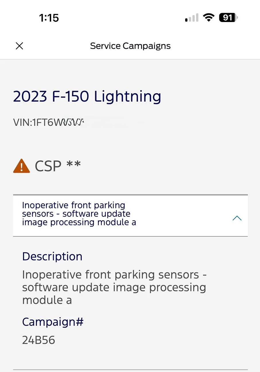

Can anyone confirm getting BC 1.4 without getting the CSP for the front sensors done?
I’m hoping to avoid dropping my truck off at the dealership to spend a day in door-ding alley.

Others have reported that they've received BC 1.4 without having any of the CSPs done so they don't seem to be required. Unless you're in EAP, I wouldn't be expecting 1.4 for some time.
Ok good to hear. I am in EAP.
I'm guessing/hoping the 1.4 update supercedes the sensor CSP since it updates the same modules.
Any idea if that's the case @Mike G @rugedraw @TaxmanHog ?
@Mike G can you please share a breakdown like you shared here https://www.f150lightningforum.com/...train-battery-parking-brake.24247/post-469128
Between the CSP IPMA update and the 1.4 update? Curious if the 1.4 supercedes the CSP or not and hoping to avoid the CSP dealer visit if possible. Thanks!
It's the same update. The only difference is the OTA version enables the new BC features and the CSP does not. The IPMA and PSCM are the modules updated.
