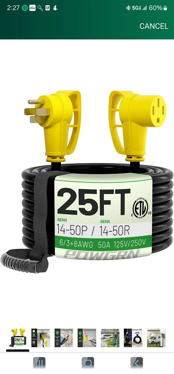

The list of adapters kept in our Lightning:
  • 6-50P to 14-50R -- for connecting to welder outlets.
  • L14-30P to 14-50R -- for charging other EVs from the Lightning
  • 14-50P to 3x 5-20R (T-slot) -- for distributing the Lightning's 30A to 120v appliances
  • TT-30P to 5-20R -- for charging at a 30A RV site
  • 25 foot 10-Ga exterior extension cord -- For when the L1 cord isn't long enough
  • TT-30 extension -- for when the 30A RV site electrical post is far from where I'm parking
  • 14-50 extension -- For when the 50A RV site electrical post is far from where I'm parking
  • A2ZEV DCFC NACS adapter
  • Teslatap L2 NACS adapter
A few other miscellaneous adapters that are for unique charging situations.
