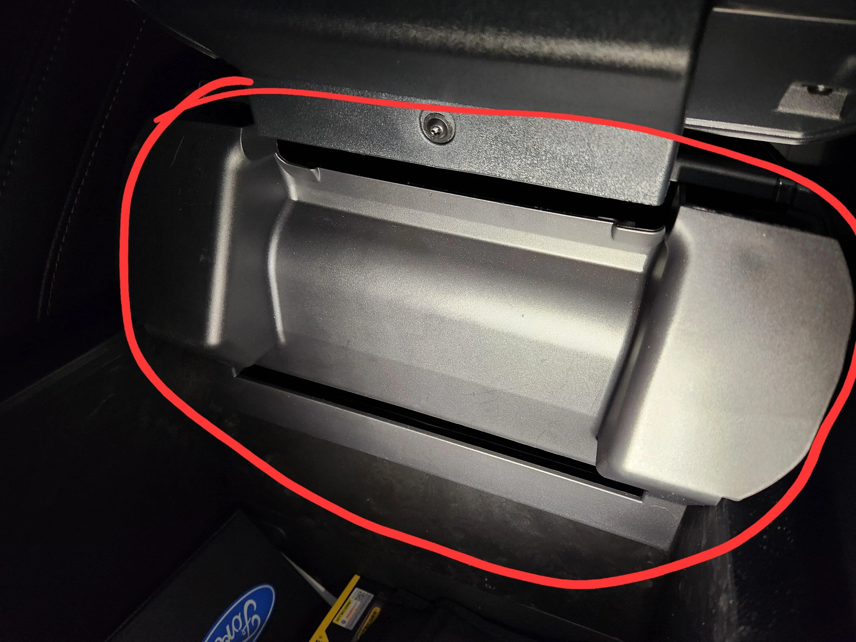

2. Working carefully using a trim removal tool, remove the trim panel located right below the hinge on the inside of the compartment. (Optional, but I recommend it for better access)

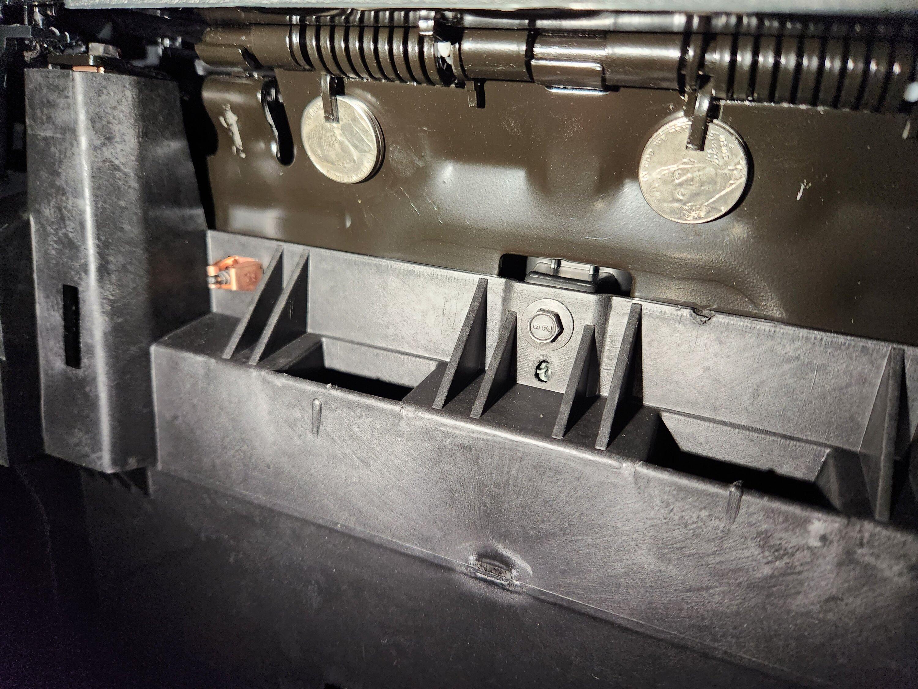

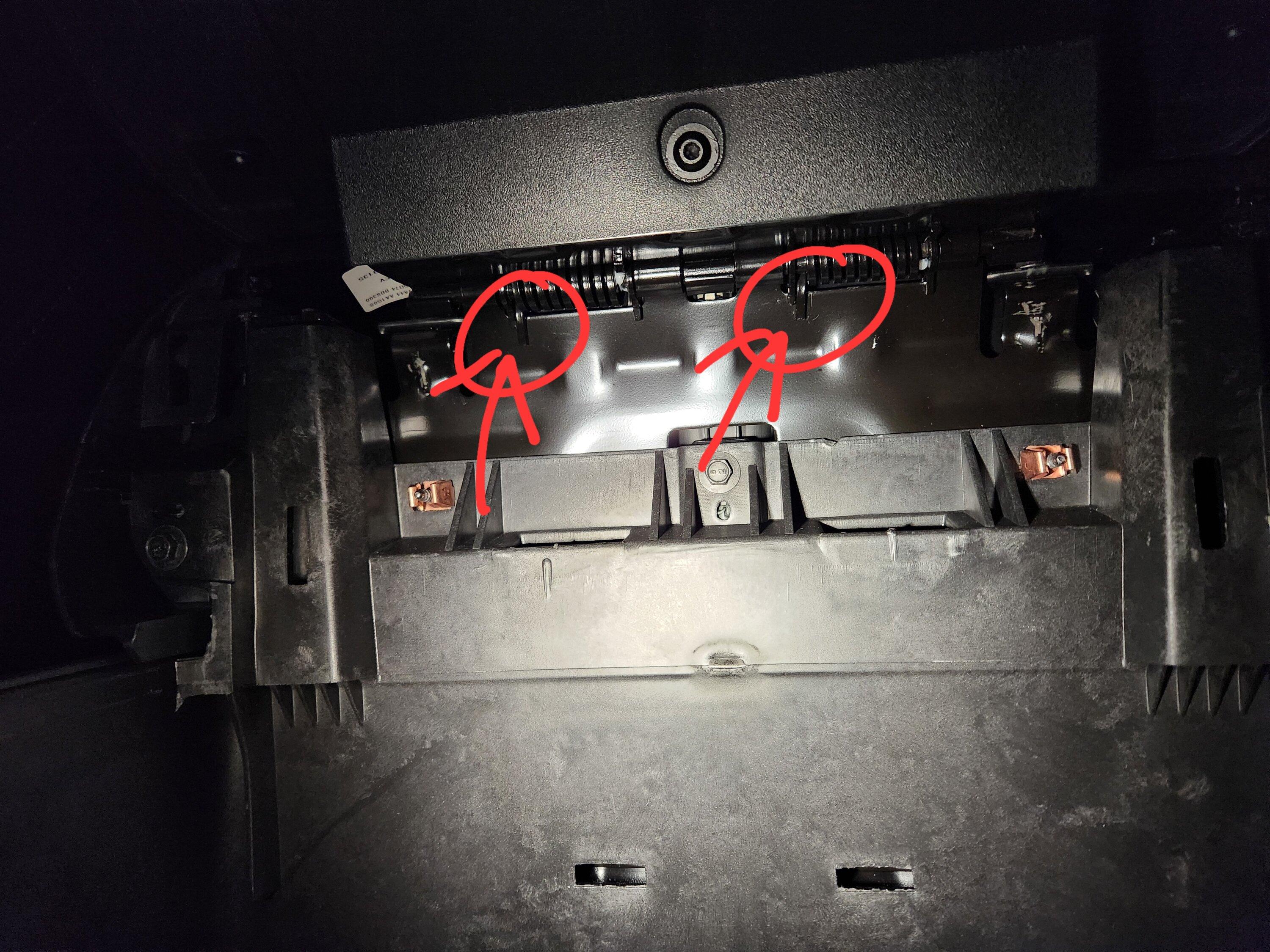

3. Now with better direct access to the hinge, locate the exposed ends of the springs.
4. Using your hooked metal plastic retainer removal too, gently lift up one of the spring ends and slip two nickels under it. Hold the nickels in place while slowly releasing the spring until the spring pressure is firmly holding them in place. Repeat for the other spring.
