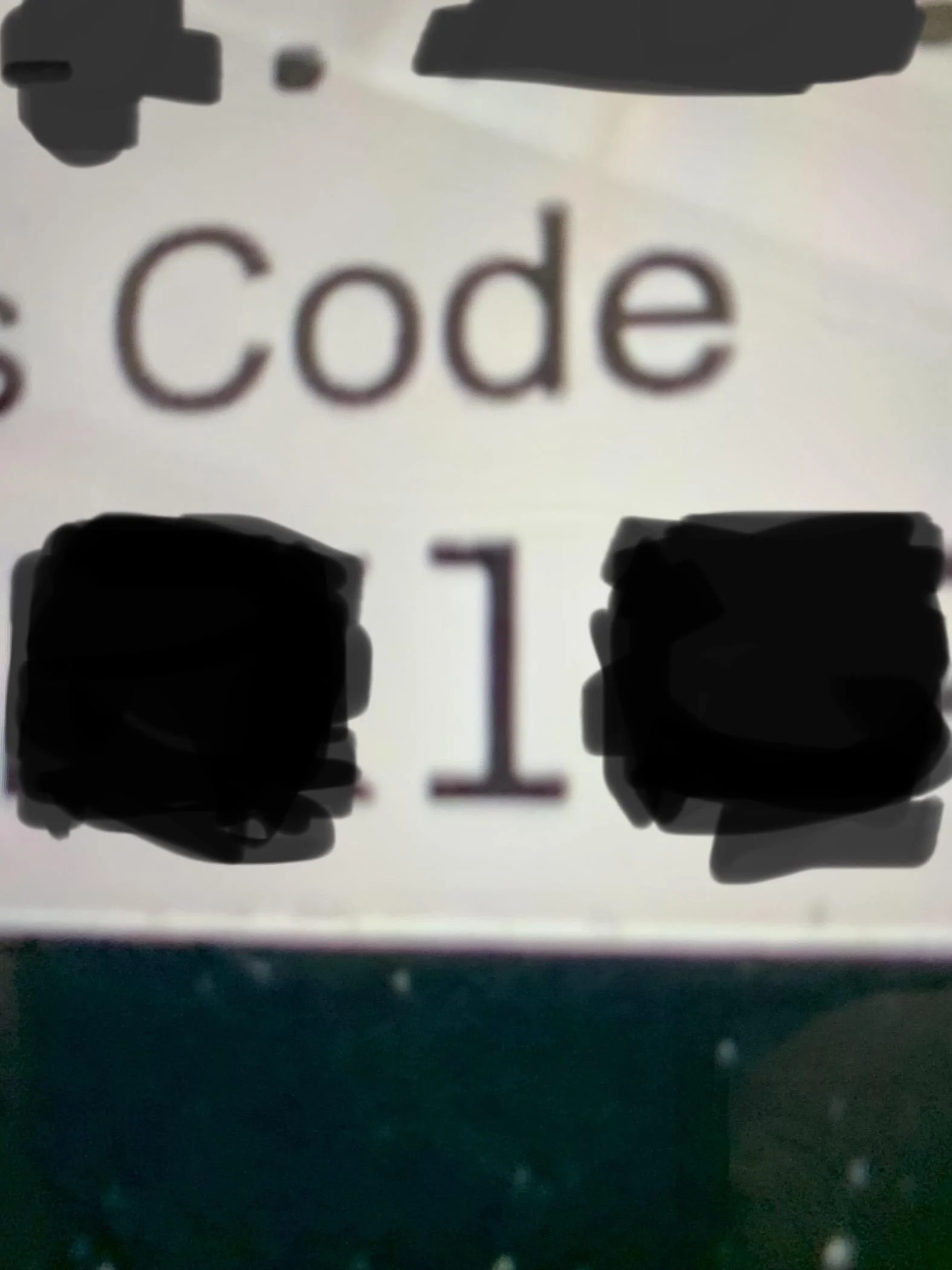

If the corrective action is going to be OTA, I will not be able to receive it if it comes through Ford Pass. Please see the picture of my charger sticker which only has an access code which does not work when I try to enter it into the charger network SWA32KCM. How do Get a password? THanks
The access code is also your password. You might want to delete that image, as someone can register your unit.
FYi, The Access code is likley capitol i's not 1's.
Highly recommend you delete that image when you get a second. Other folks could bind their ford pass to your unit like that (or god knows what else).
Hi, you may have tried this, but sometimes fonts can be misleading. Won't be the first time this has happened! I'd try the following -
1) see DM
2) see DM
3) see DM
4) see DM
note: lower case L and upper case EYE look the same in many fonts so if they appear twice try all four combinations. Likewise for O and 0 which is less frequent but can happen.
I bet you (two Platinum active multi-contour seat w/max recline)one of these works!
I think you are right. I just found the difference between the upper case i, and 1….thanks! Will try next time I get a chance.

Would be funny if @CTBob issue was I and 1 . I already explained O and 0 to him a few pages back .

Please give your best guess what letter this is? It is part of my access code and it’s not a number 1.
