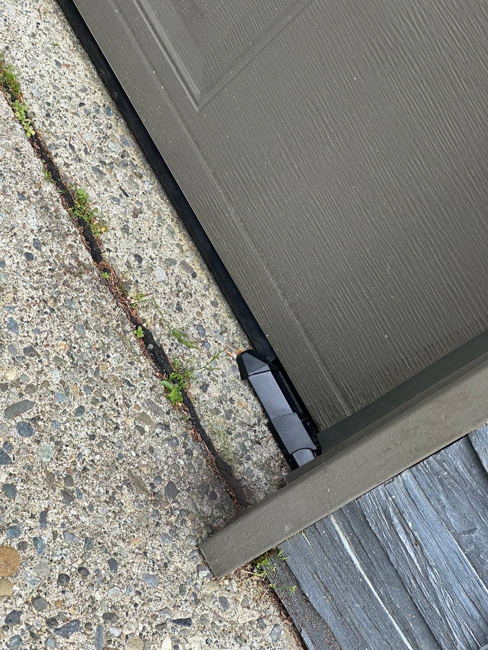

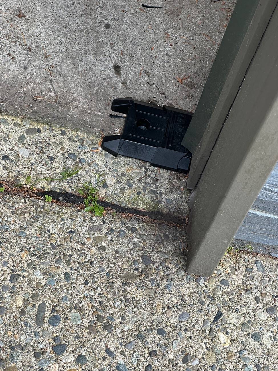

Works absolutely great. You will need to replace rubber gasket at bottom of the garage door with a thicker one.
https://a.co/d/fUdQEfx
I’ve been considering this as a solution. My garage has a concrete lip that the door closes in front of, I’m not sure how well the Undoor would work without grinding a little concrete on the lip. From an install video it seems like I’d need to install something of similar height on the other side so the door stays even. I could make a block at home with a rubber plug to mimic the function.

No need to have something else with similar height on the other side, as as long as you use the proper gasket, and you set the garage door stopping point. Worst case scenario, is that you add a second Undor to the other side. They come in a box of two anyway.
Their website and installation videos recommend installing both to prevent garage door damage. Not a big deal, but I’d never use one on the opposite side of the door away from the charger.
☝ This is the answer. It's a permanent solution, doesn't damage the door or cable, and keeps critters out. The only downside is you have to adjust the door and install a new seal. It's a one or two hours job. Some people might not be comfortable doing that.

I have the Undor system too and it works great. The door seal was a pain in the butt, not the end of the world though. And I only have one side installed, with the new seal and adjusting the travel it seals up pretty well.
