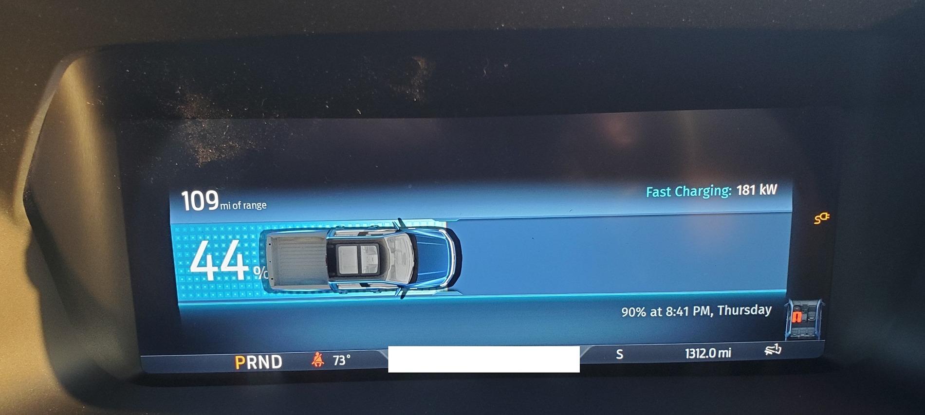

One difference apparently 2024s got is showing the real-time charge rate in the upper-right of the IPC screen. Also, my IPC shows the SoC on the left side charge status indicator, which some have and some do not have.
Can you get a snapshot of the charge rate? I'd love to see what they added so I can dream about an OTA for the rest of us. :)

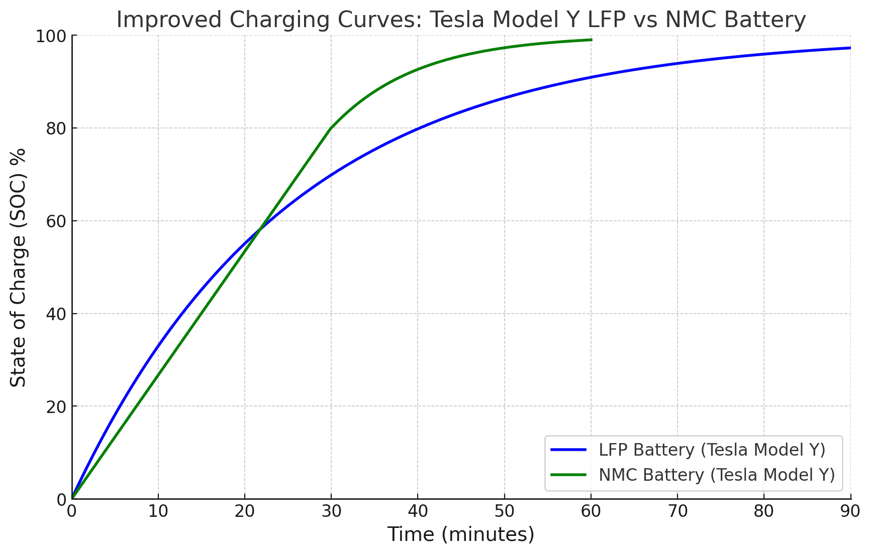

It will be interesting to see charge rates for the future LFP (lithium iron phosphate) batteries vs. our LiNMC (lithium nickel manganese cobalt) batteries. LFP do not deteriorate as much going to 100%, I think.
Ford F-150 Lightning Fast charging question 240820 chatgpt improved tesla charging rate curves comparing LFP vs NMC battery 8a4844db-bdf9-
