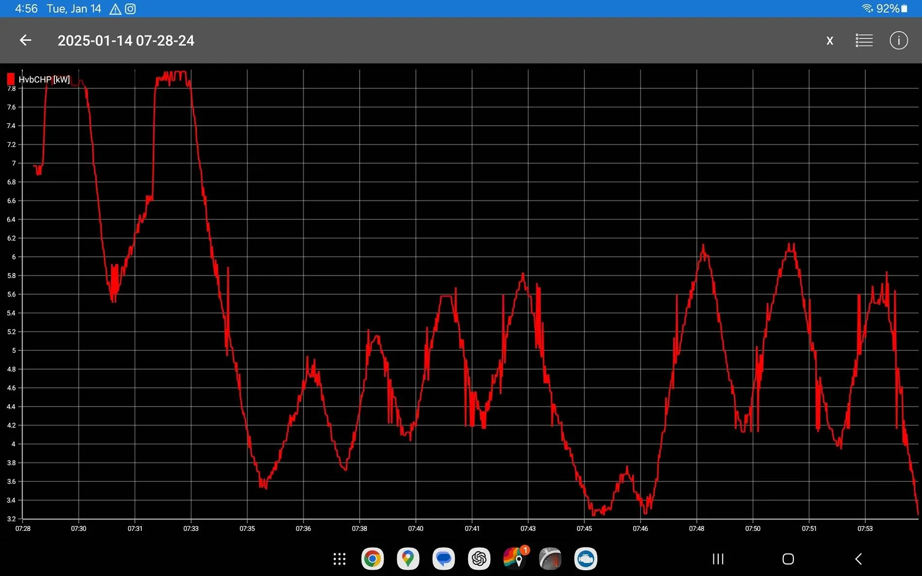

Short drive testing Auto 1 vs Auto 3 in 7 degrees F.
Ford F-150 Lightning Cold Weather, Hot Data: Heater Power Usage and Exterior Temp Screenshot_20250114_165635
Beginning is warmup as I left my house.
The second bit, 735-745, was Auto 3 at 70mph (ish).
The beginning of the third bit (747-75) was Auto 1, also at 70mph (ish). The last bit was Auto 3 again.

Yeah
What is unusual to me is that Auto 1 appears to use more energy than Auto 3.
Of note, today when leaving work with cold soaked battery the heating system did not warm the battery, even though power was even limited due to temp.

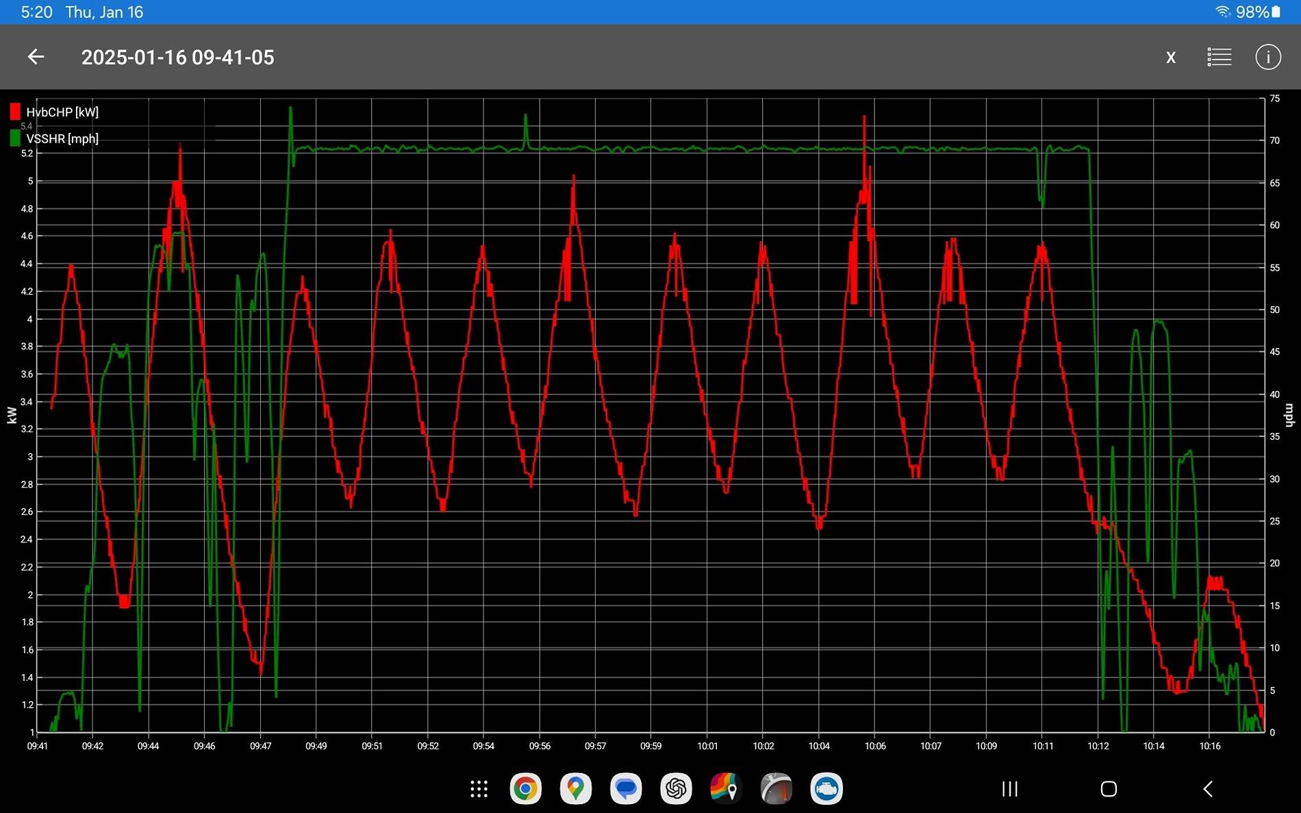

Ford F-150 Lightning Cold Weather, Hot Data: Heater Power Usage and Exterior Temp Screenshot_20250116_172009
Had a 40 minute highway drive so tracked heater usage again.
I used some portion of the drive on Auto 3, and some portion on Auto 1, switching at the halfway point. Care to guess which section is which?
I think we can see that which Auto setting you choose doesn't matter. Which makes sense, the truck is losing BTUs and needs to make up for that, how much it loses isn't determined by which setting you choose.

I haven't digested this thread, but the parts I've read and my personal experience for performance of the Heat or AC is to forget those Auto settings. They are worthless at controlling the HVAC in any manner they might suggest.
I rarely have enough fan for either heat or AC. Turning the fan up manually to 3 to push the heat out seems to be much more effective than either Auto that seems to blow nothing, regardless of how much power is being consumed by the heater.
Firn
Firn
Aug 26, 2024
885
1,024
23 Pro ER
To each their own. Auto 1 is my preferred setting and it works fine for me. The fan kicks on initially and then slows down, I'm comfortable and I don't hear the fan. I'll hit the button on occasion for various reasons, then ending up driving like that for days or weeks because I didn't realize it was not Auto 1 like I prefer.
Regardless of the fan speed the heater usage should be the same if the temp is set. More, lower temp air, or less, higher temp air, it's all just trying to replace btu loss.

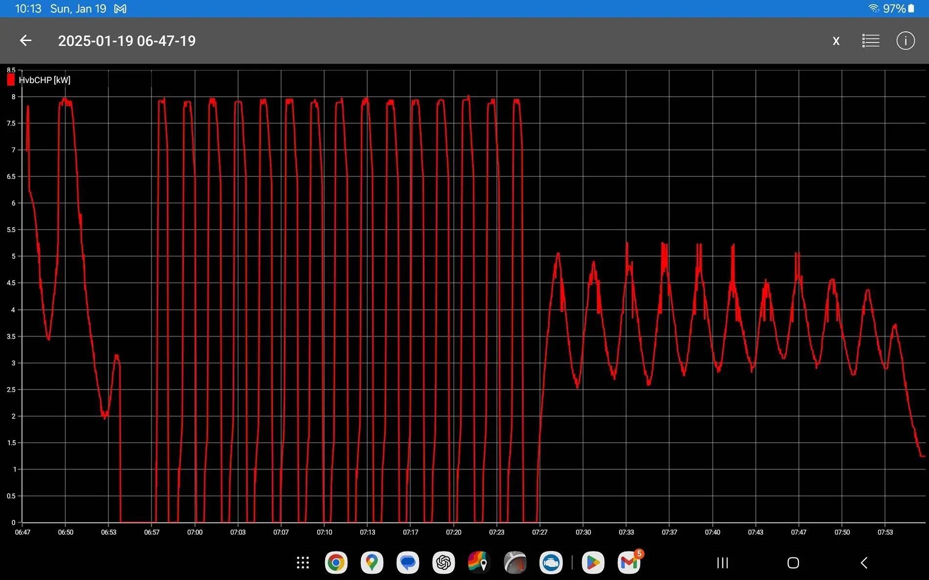

Did the 1 hour drive again today and the heater was a bit different. This time it started off alternating between off and max, then at the halfway point switched to what we have seen before.
Test was 70mph in 21-23 F exterior temps. Hvac on Auto 1.

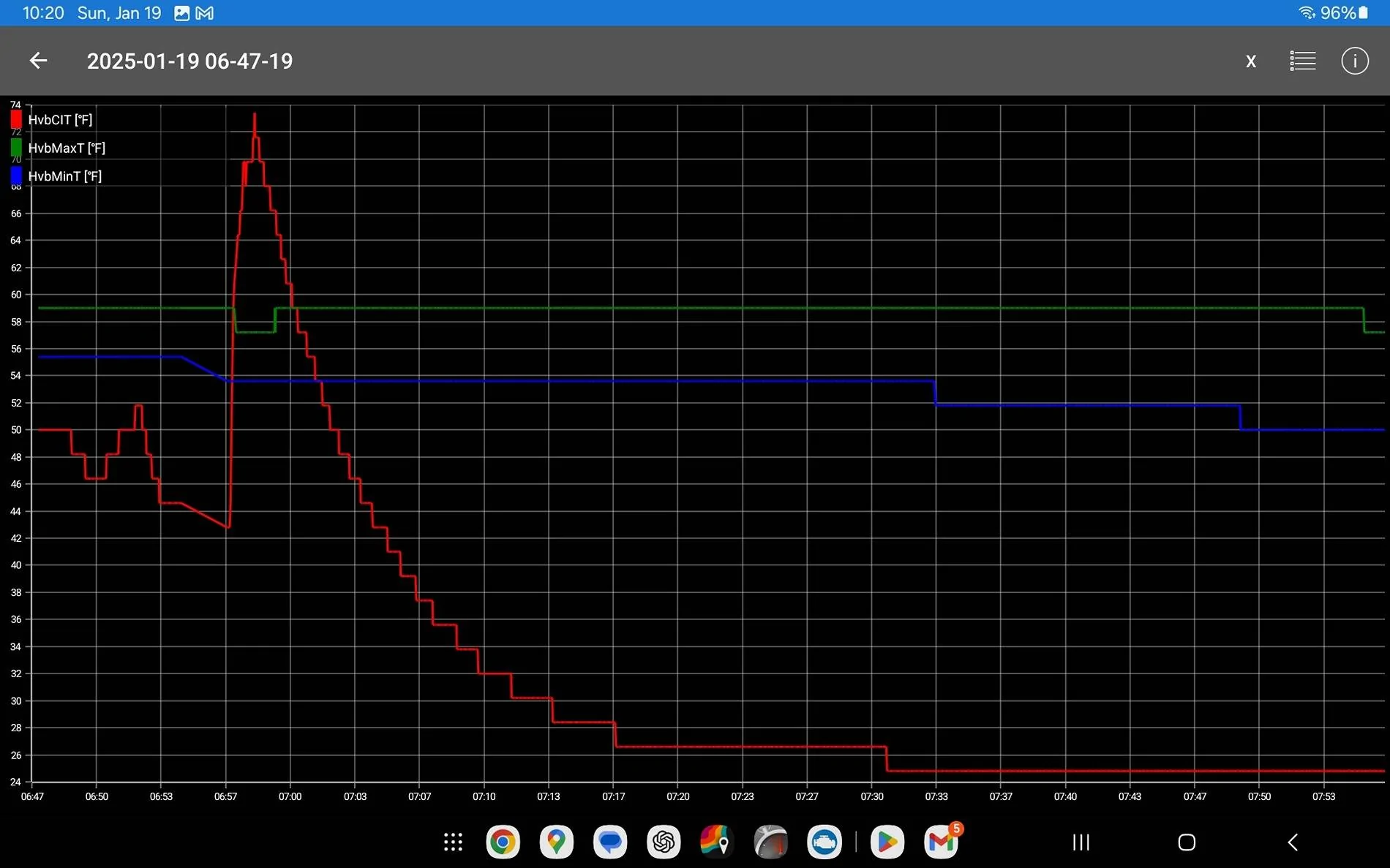

Oddly enough, today there was a short burst of heating directed towards the battery.
Ford F-150 Lightning Cold Weather, Hot Data: Heater Power Usage and Exterior Temp Screenshot_20250119_101319
Coolant inlet temp vs battery min and max temp. Spike in temp directly correlates to me restarting the truck after getting setup at the local park, prior to that was me leaving my garage and driving to the park.
