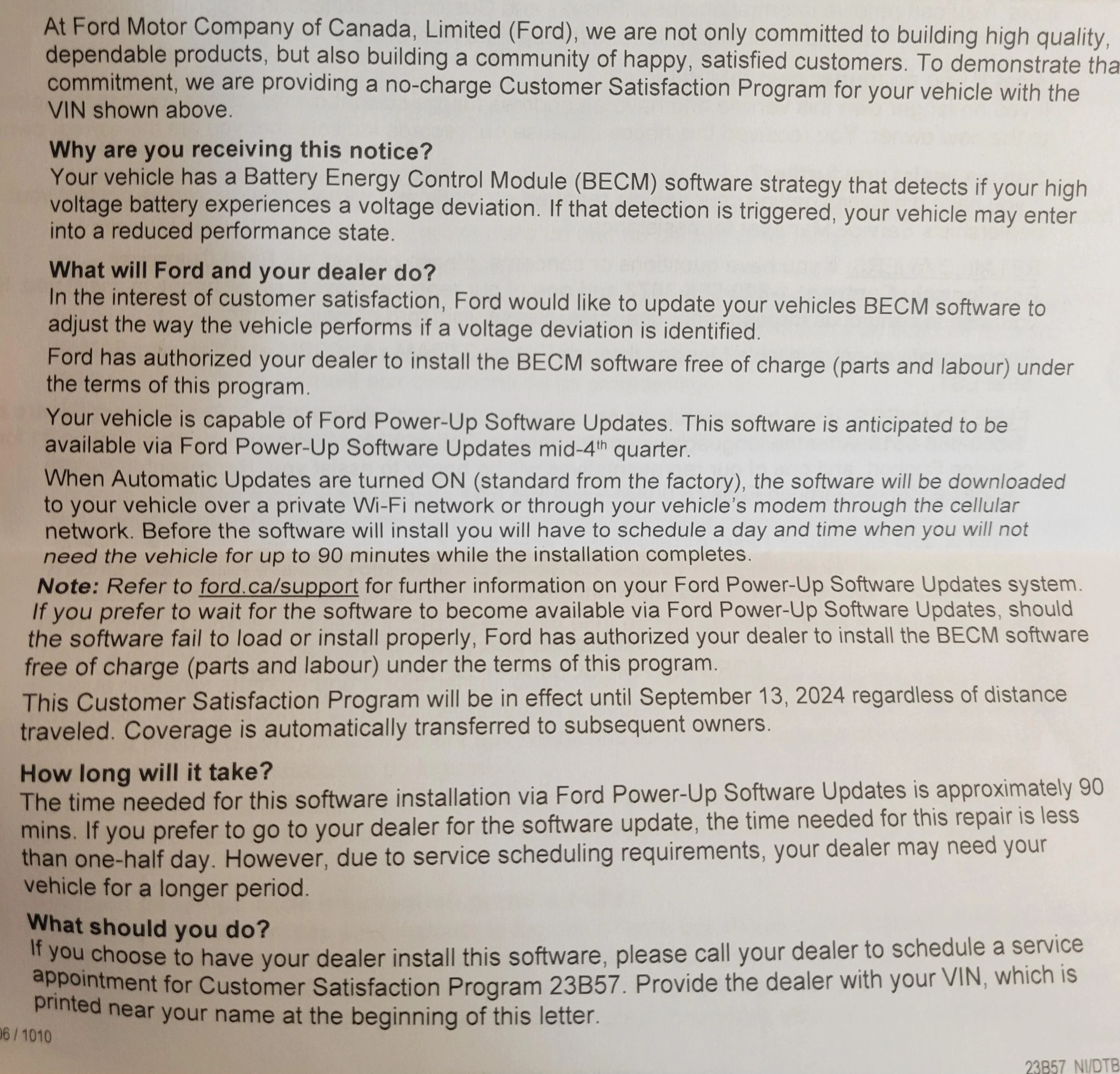

Received in the mail today from Ford Canada. I had the reduced power error once back in early August and nothing since. June 22' build date. 💪

I do think Ford dealers/Techs are confused about this TSB. I finally got my truck back but without this Software update.
I tried explaining to them that there was no need to replace the module if there was no indication that it was malfunctioning.
They never plugged in the Truck to have the software diagnostics, they just assumed the TSB said to replace the module which is why they were waiting on Ford Support. I pulled the truck out of the dealer with just the Lightbar replacement and Mat.
2,208
2,313
Mine assumed it was the same as the MME notice. After I pointed out that I'd read it myself (thanks to this forum as I hadn't received my letter yet) and that module replace was only required AFTER the software update says so, did they agree and just apply the update. Or at least I hope they did, the notice is still in FordPass and I had the update a few weeks ago.

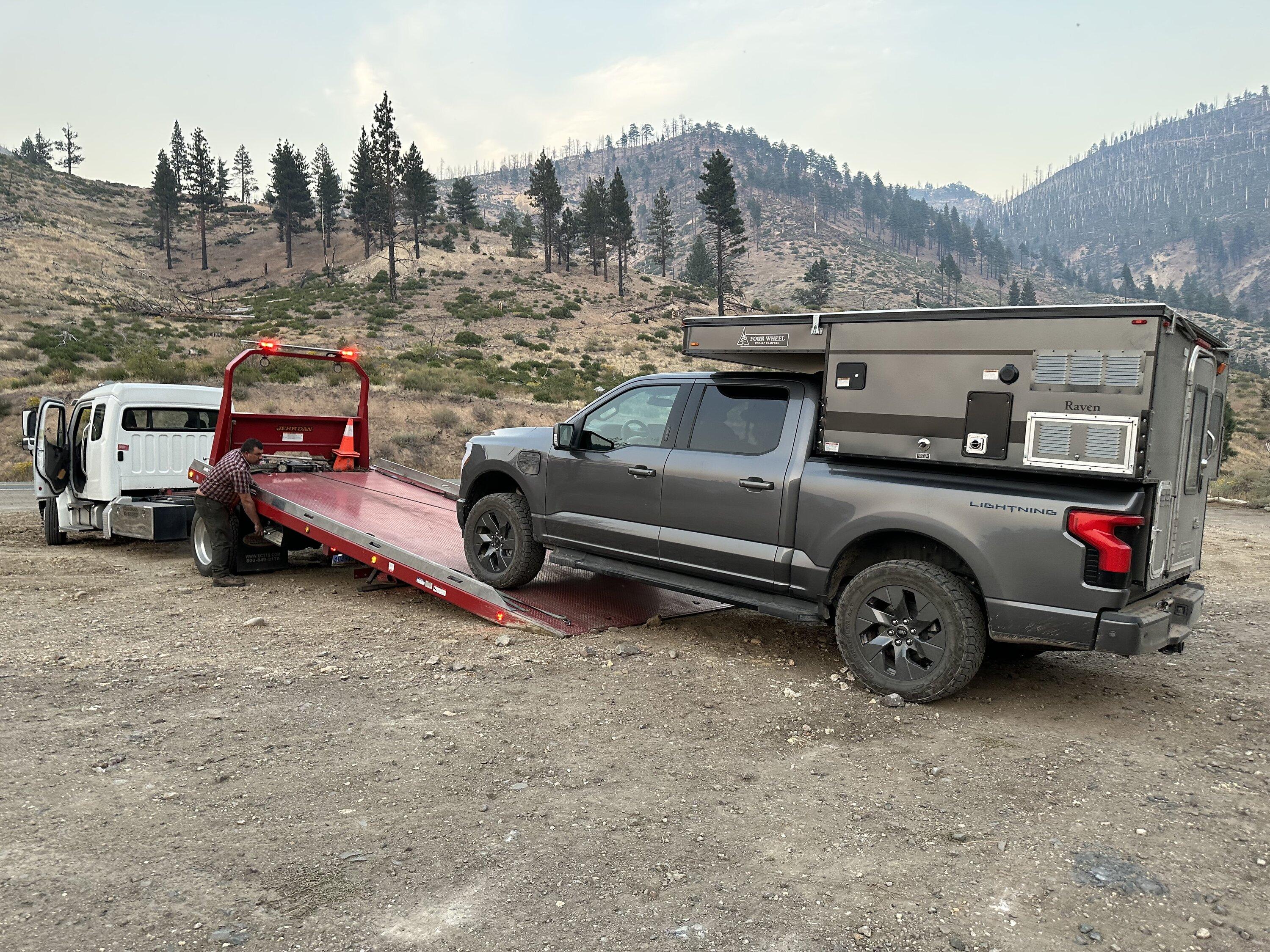

Yeah! I think I need to take mine in. A few mornings ago I was ready to leave a campsite and it said to pull over and go for maintenance. It only crawled, so I ordered up a flatbed tow. About an hour later after getting in and out of the truck it started running again with no dummy light errors. Cancelled the tow.
I’ve noticed my battery would charge to 100% at home before a long trip, then once it hit the road it would go down to 96 then 92%. Now it goes straight from 100% to 86% after unplugging. Temp was 60 degrees.

Update: I got a call that came in saying “Ford Recall”, so I definitely picked it up. Lady over the phone said my truck had been identified as a recall for the main battery and asked what dealership I wanted the work done at. I told her the one I had it towed to in Carson City 😂. She looked it up and said it would take two weeks to mail the part out and that I was entitled to a rental while I wait.
I will update how long it takes. I need to find a ride to get my rental now.
