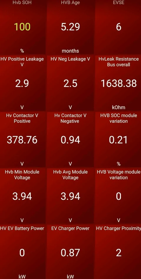

I received delivery of mine two months ago. I have the CSP notice on ford's site. I checked the battery SOH on OBD and it says 100% with the min and avg cell voltage.
Ford F-150 Lightning CSP-23B57 for High Voltage Battery Notice 1696480748802
I think I'll wait for the OTA and ask them about it on my first service appointment.
