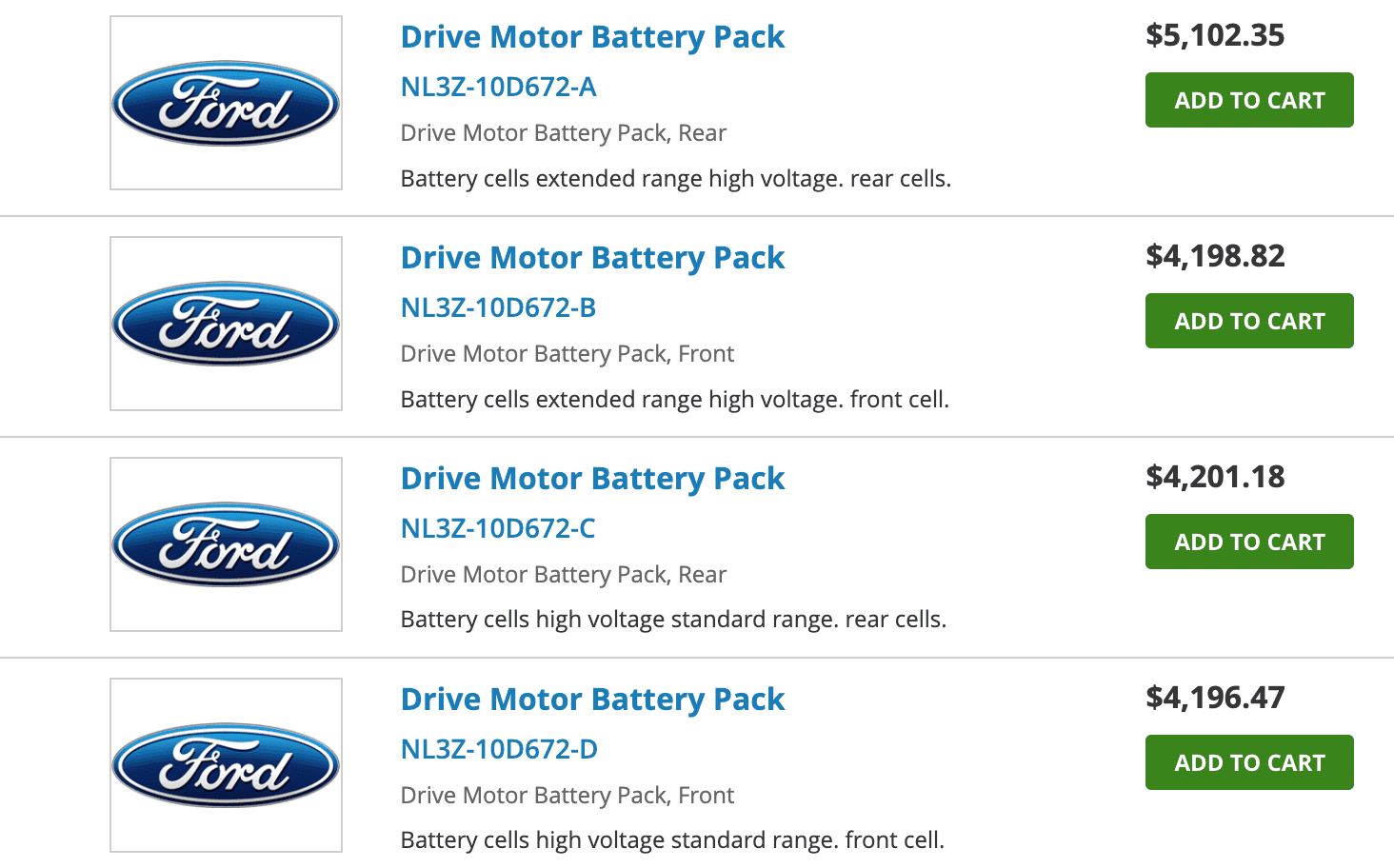

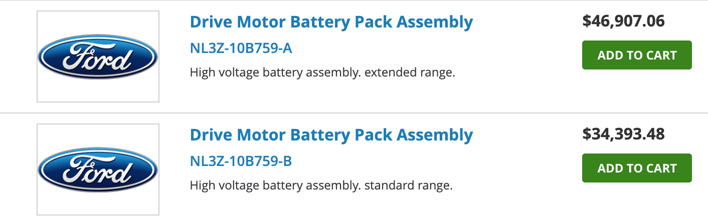

Entire pack MSRP is like $30K. This price sounds plausible for a module.
I was poking through parts at one of my local dealer's online catalogues. Looks like they're a bit more than that.
Ford F-150 Lightning CSP-23B57 for High Voltage Battery Notice 1699303752403
And the module prices depend on placement and pack size.
Ford F-150 Lightning CSP-23B57 for High Voltage Battery Notice 1699303800415
Source LINK. LINK
Source LINK. LINK
They do indeed...I'll wait till they show up on Amazon...
