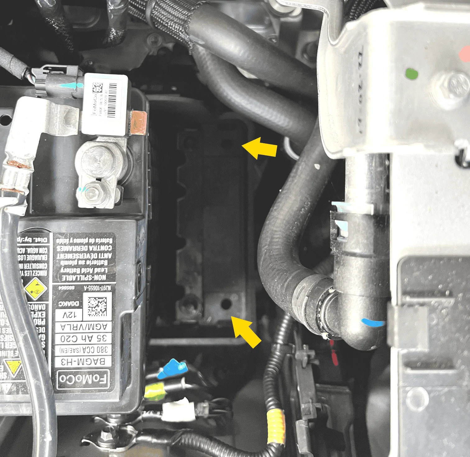

There have been folks who changed that threshold using FORSCAN (it's an asbuilt value) to cause the DC-DC to start recharging sooner. I haven't done it. I get why they're doing it but I don't think it would help as much as getting a battery with higher Ah. (like the 40Ah Diehard from Advance Auto). While programming my MME yesterday and noticed that the hold down bracket for the battery could be shifted over to a second set of holes to allow for a larger formfactor case than the current "H3" battery that's in there. I'm wondering what other formfactor sizes were under consideration before they decided to go with the H3 and particularly important for anybody who lives where it gets really cold...if they were considering a larger battery for colder climates?

Pretty sure the Lightning's battery tray is the same. I fully intend on replacing both the batteries in my MME and Lightning with the Diehard 40Ah battery when my factory batteries eventually die. (Unless I find something that will fit in that battery tray that's got even more Ah).

H3 Stock fitment
Ford F-150 Lightning CSP-23B57 for High Voltage Battery Notice 1700233607607
H4 Would this fit??
Ford F-150 Lightning CSP-23B57 for High Voltage Battery Notice 1700233583313
H5 Is this to long at 9.562 for the expansion position?
Ford F-150 Lightning CSP-23B57 for High Voltage Battery Notice 1700233546586

So I haven't examined it closely, but when I went to check if the slightly upside battery I bought would fit, it didn't seem to and I didn't see any slots to slide over into. I'll have to check again when I get the chance.

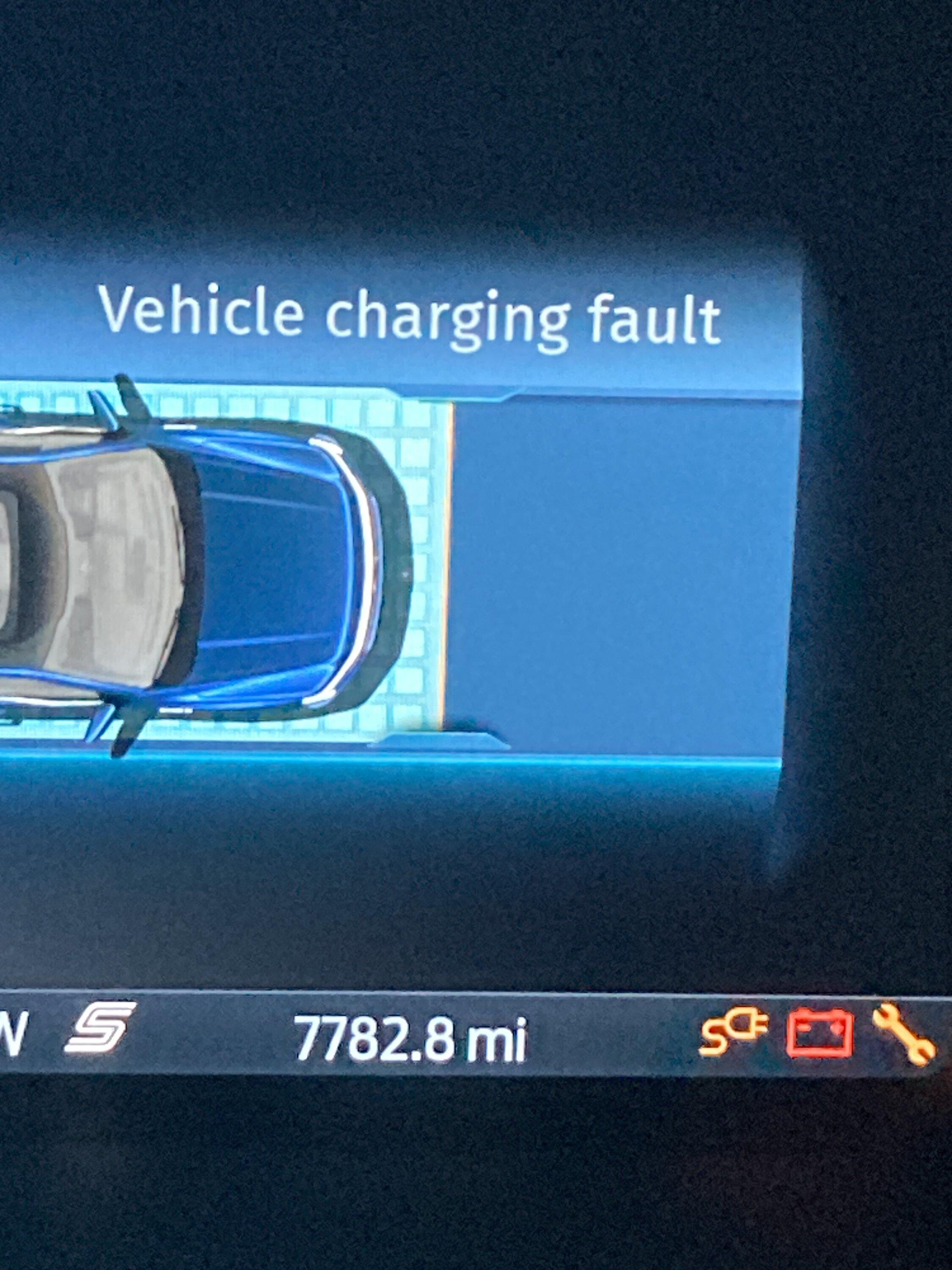

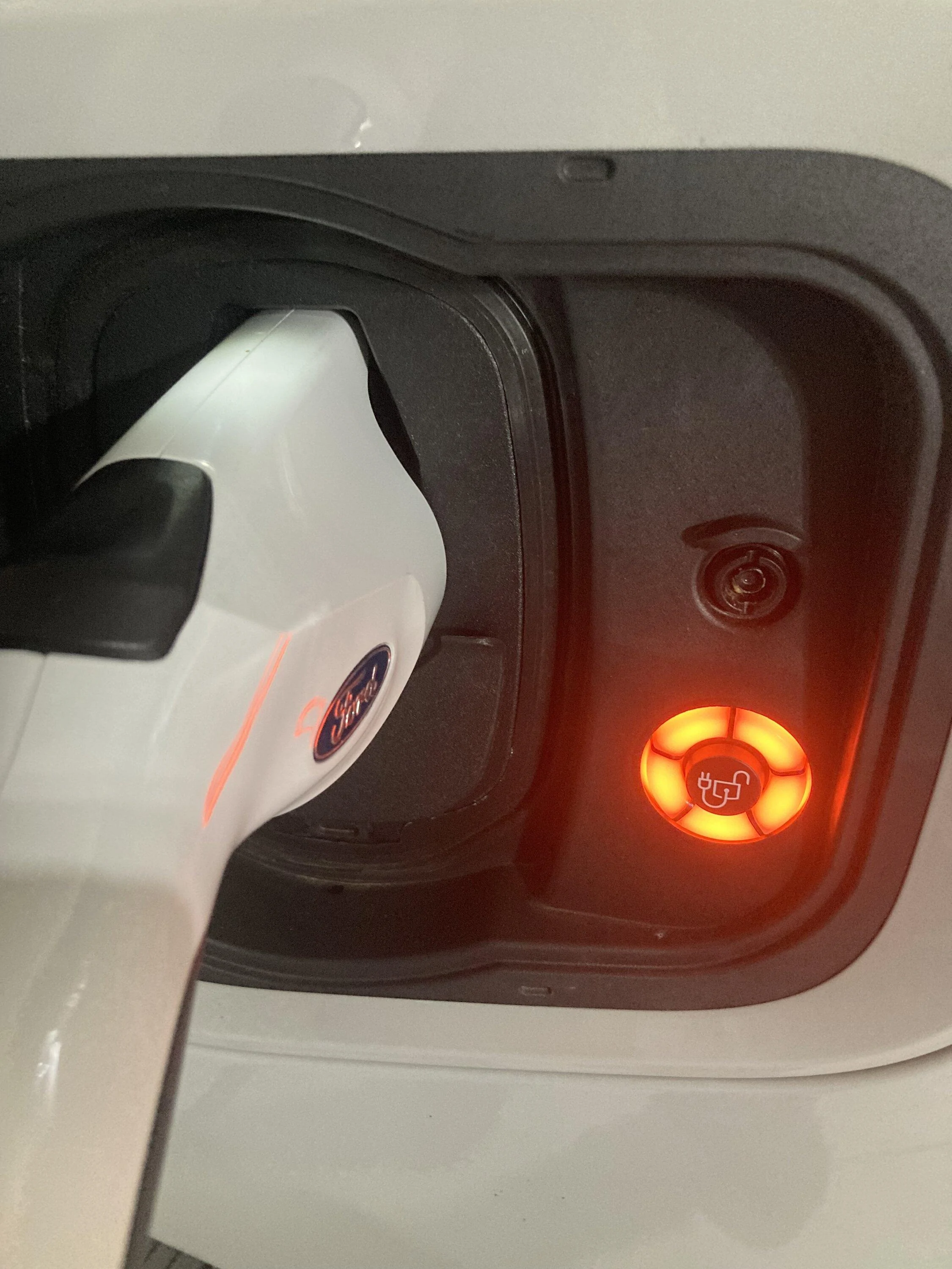

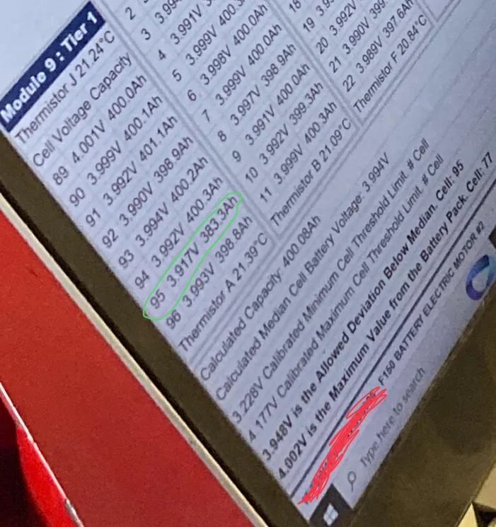

I was going to wait also thinking surely I am not one of the 4% with a bad pack in a module. lol nope I was. My gripe is not being reduced power 57% as I don’t even notice it. I’m still driving it in town only until parts arrive or battery gets to 20% is my plan, then get a loaner. My gripe is red ring of death and no way to charge battery. That is the part that sucks, no way to charge truck if a single pack. 1 out of 96 is out of spec, you cannot charge your truck. 😩
Yes you can charge, it's just limited to a lower value to protect the battery
wish I could charge however even after clearing fault code it comes back immediately so not allowing my truck to charge.
It almost seems like you're extra unlucky and have both the battery module failure and the on-board charger fault. I'm not recommending it, but have you tried DC fast charging?
