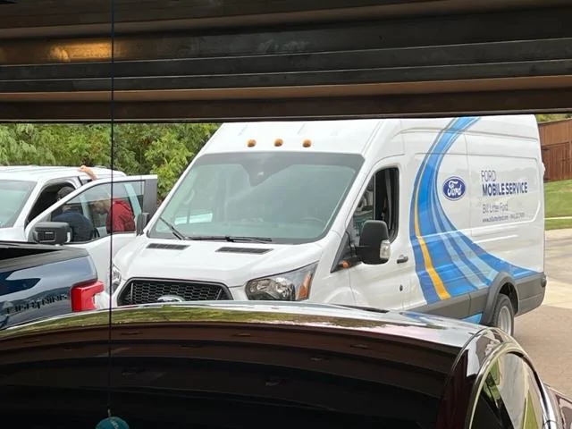

Dang, now it shows on my wife's truck as well. Called the dealer back and they may try it mobile at noon today.
OK.. So mobile service came to the house at noon. He updated both trucks for the CSP. It also included updates for 4 other modules. Nothing indicated that a battery module needed to be replaced. So appears to be good to go. Maybe this is a software update to mitigate the issue :unsure:
That is awesome that your dealer is up on customer service and will come to you.
I believe the update is to prevent the truck from sending the dreaded ‘ Pull over and Stop as Soon as it is Safe to do so’ Message.
It will now reduce power to something like 20% and let you limp home or to a dealer if it detects a bad module.

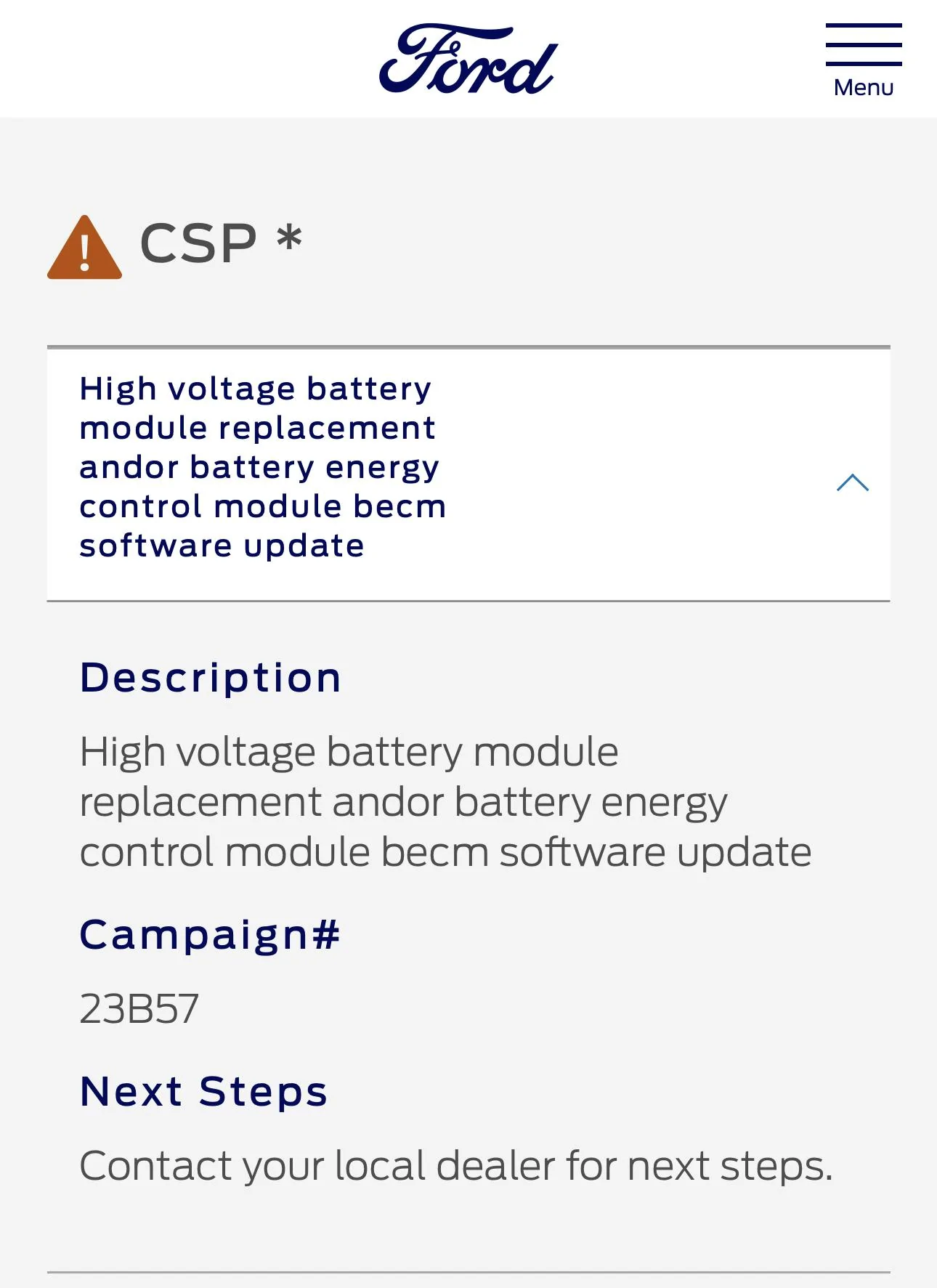

Just curious if any of you have received this. Today I logged into my Ford account and found two recalls. The first one I knew about, the rear light, but now I also had the below High voltage battery module or software recall.
Anybody else get this? My plan was to wait until the rear light parts are available and then make an appointment. Is this something serious or just a software update?
No warning in the truck or otherwise notifications.
Copied from website text below:
"High voltage battery module replacement andor battery energy control module becm software update
Description
Campaign#
23B57
Next Steps
Contact your local dealer for next steps."
Just received mine today, but had to do a specific vin search not using the dashboard.

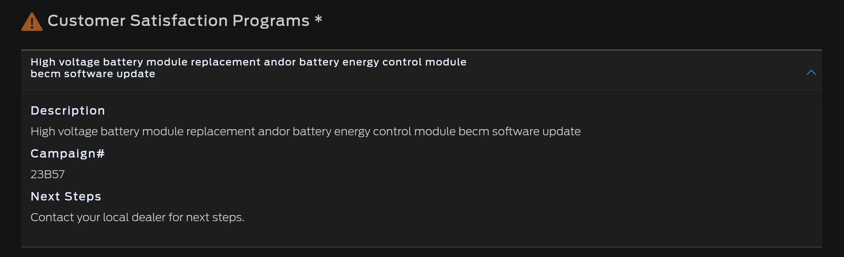

So my truck has never had an issue with the battery modules or experiencing the reduced power fault or anything, but on a whim I decided to punch my VIN into Ford's recall checker. My truck popped up as either needing a module replacement or software update.
What should I do? I've had my truck for over a year and never had a single major issue with it. I just really don't want to drop my truck off and find myself without it for weeks. Hearing all the horror stories here has me concerned. Especially since I haven't had a single issue with it ?
Have any of you found your Lightnings listed for the CSP? And if your truck had zero issues, what if anything did the dealer do?
https://www.ford.com/support/recalls/
You should contact your dealer and have them schedule to fix it. ?

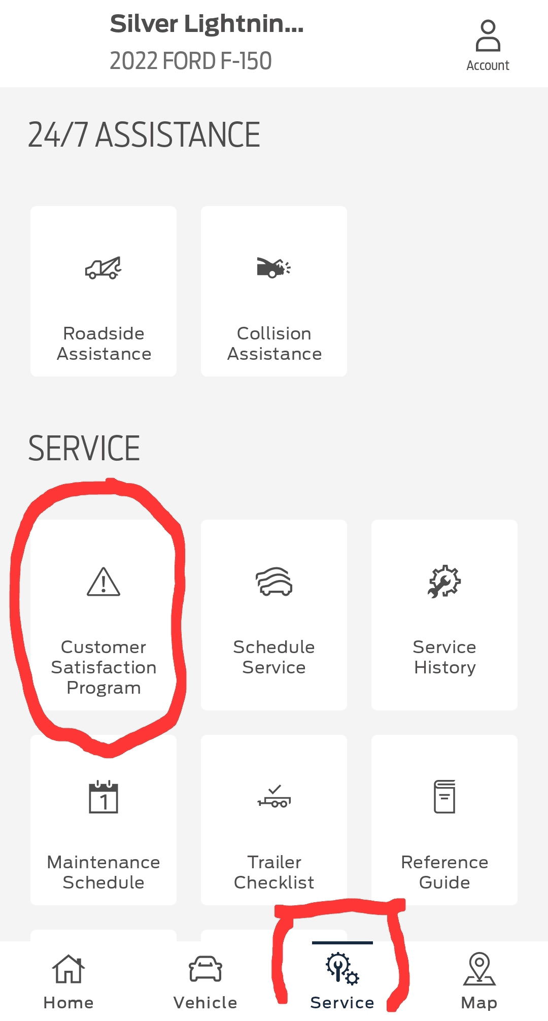

Yup, many are finding this alert, even many of the new builds still sitting at the factory waiting to be shipped.
BTW, easy method for looking up your CSP's using Fordpass, click Service, then Custom Satisfaction Program tile, it will show an overview, then click it to see the details.
Oh yeah thanks for the tip, man! But I'm the "TCU disconnected, don't use FordPass" guy, so a manual lookup was the only way I discovered this!
