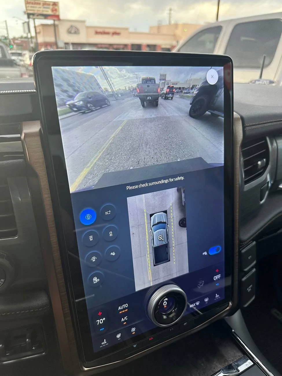

22 platinum. Done today. Took three hours. Said 12v went down to 33% and had to wait for it to be above 70% to do the frunk fix.
360 camera looks like this now:
My camera has been like this since December after the 6.14 fix. It's just pathetic......

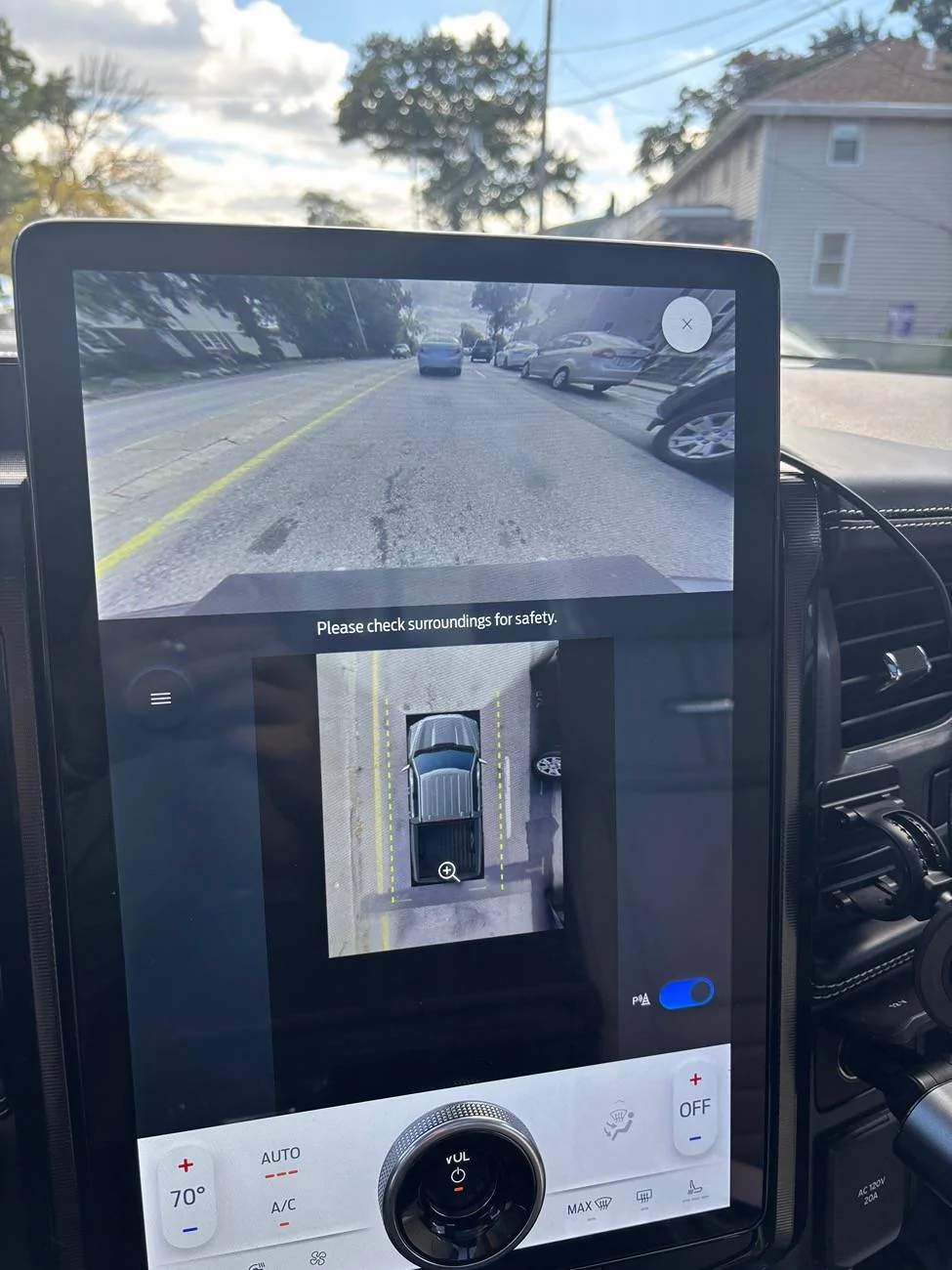

I got my Lightning back from the service center, I had my 30,000 mile service and I had the CSP taken care of, and now I have the new camera ui. Has anyone else seen this? The scale of the camera view at the top of the screen is different and the 360° top down view is slightly narrower.
Ford F-150 Lightning CSP 24B56 - Inoperative Front Parking Sensor(s) - IPMA Software Update for Certain 2022-24 F-150 Lightning Trucks IMG_6831
BMac1203
Sep 25, 2024
NoVA
2022 Lightning Lariat ER
Looks like mine. If you pull up to a wall does your front camera still activate?
This view happened to me with the OTA 6.14 update. Maybe the dealer got that installed for you?
