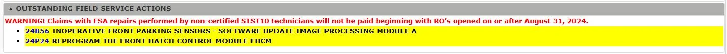

I’m still trying to sort out the camera fix. Had the update. Remote tech came out and when I looked over his shoulder it said the parking sensor update had not been applied.
What were you looking at? Was it PTS? Or something in FDRS?
If it was the PTS screen that shows the open FSAs for your VIN with yellow highlighting behind the text...then yeah, that will still be on the PTS screen until they process the action in the dealership showing it's completed. It's not an immediate thing in most cases.
Here's an example of the PTS FSA block:
Ford F-150 Lightning CSP 24B56 - Inoperative Front Parking Sensor(s) - IPMA Software Update for Certain 2022-24 F-150 Lightning Trucks Outstanding_FSA
But again, I don't know what you were looking at.....

I’ve had such unfortunate luck overall when taking trucks in, to the point that this entire past year on my lightning I’ve avoided the shop completely so far. I am encouraged enough after reading others experiences overall with Ford Mobile service that I’m going try that out….
I’m showing that I’m still due still for both of these CSPs:
——> 23B70
——> 23B56

I just did this, took 5 hours or so just for this update. One of my TPS sensors didn’t work and needed reconfigured.
On the app, it didnt clear this CSP. So I don’t know if it was actually done or not.
Clearing the FSA on the FordPass app or on PTS is a function of the shop signing off the repair as completed in the system. Many shops don't get around to doing that 'cleanup' administrative stuff until days or sometimes weeks later. I wouldn't worry about.
I do my own updates. So my outstanding FSAs for those issues stayed in the system for many months after I did the updates, until I asked my service advisor to sign them off when I went in for the 10K (AKA a tire rotation). It means nothing to see those FSAs still showing up if you know the work has been done and there aren't any issues.
How would I know the work was done?
