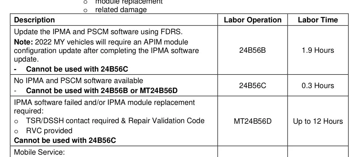

Do you or does anyone know how much the shop get's for "time" on this or other updates?
In other words, if they're paid an hour for an hours direct attention, then they better watch the pot boil, not juggle a brake job and two oil changes, but if that's how they're operating then pay very close attention.
The script enhancement should include an audible alert to draw their attention to the situation.
Looks like 1.9 hours from the dealer bulletin. If they screw it up they can get up to 12 hours.
Ford F-150 Lightning CSP 24B56 - Inoperative Front Parking Sensor(s) - IPMA Software Update for Certain 2022-24 F-150 Lightning Trucks IMG_0622

Disincentivized to do a good job?
