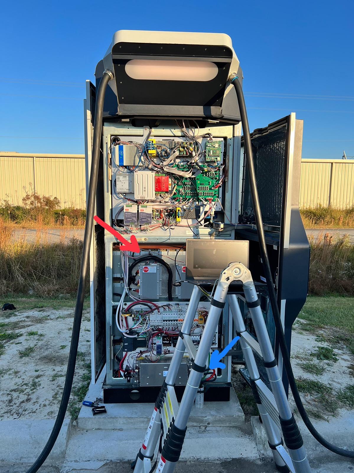

Is one brand of charger only using batteries or any that never use them?
Some Electrify America stations actually have Tesla battery systems. Tesla and others make grid level storage systems that can be integrated into any charger system or used to level demand or provide backup for any other load.
Freewire chargers all use batteries that are built into the dispenser. The picture shows the inside of a Freewire charger that was being installed in eastern NC. The red arrow is pointing at the batteries in the lower portion of the cabinet. The blue arrow is the power coming in and it appears to be just one phase of 208V circuit coming from the gas station so it’s probably only pulling 40-50 kW but it can deliver 200 kW.

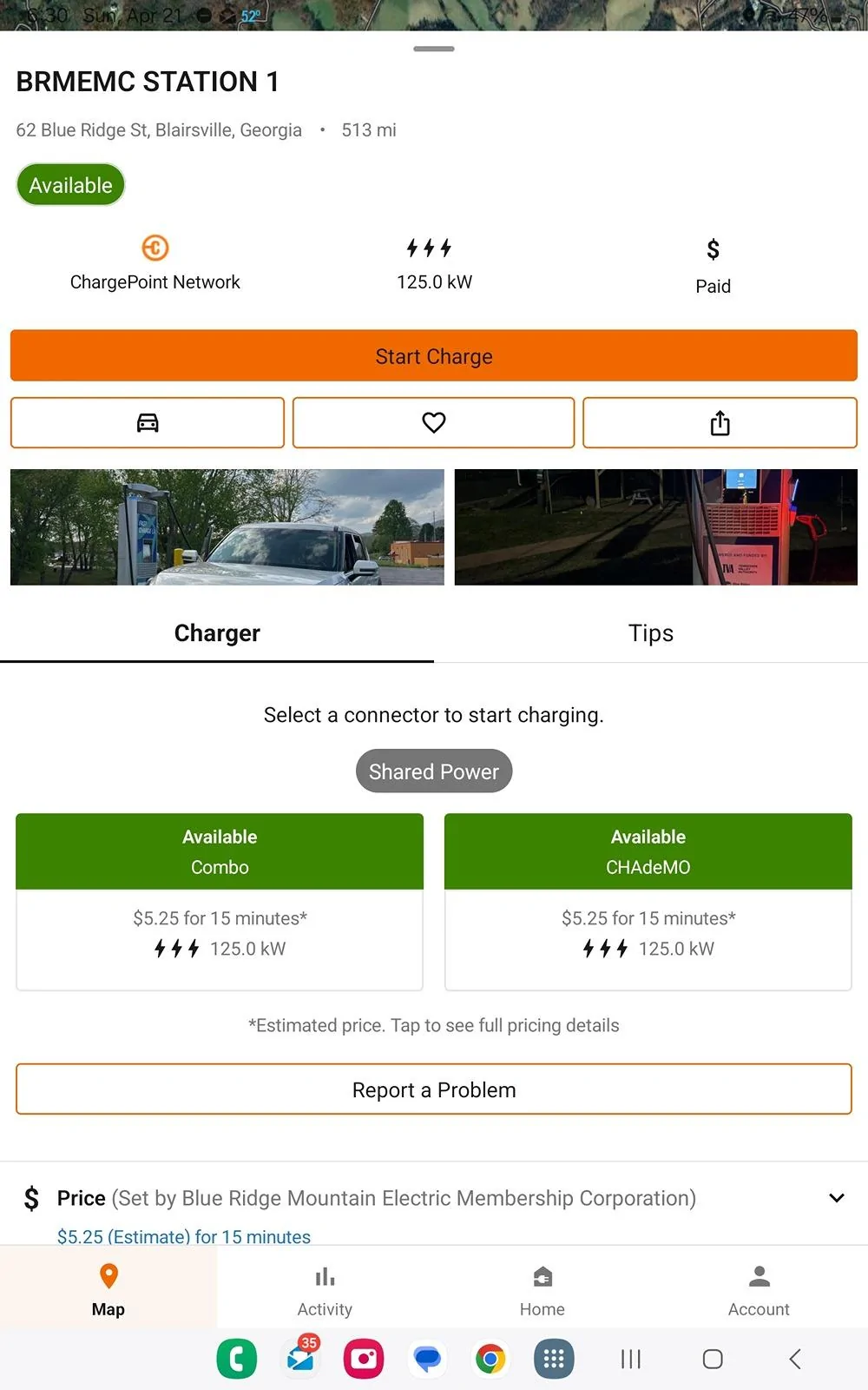

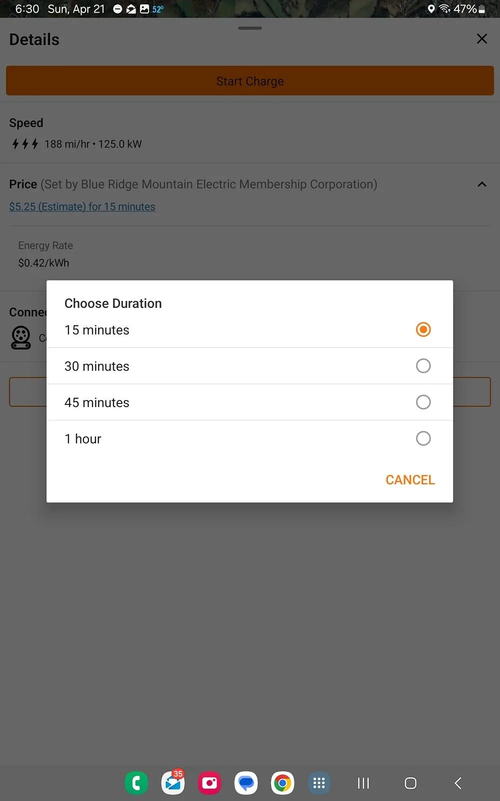

You don't 'have' to ask, because with few DC Fast Charging options in many areas, you don't have a choice.
but, the other side of the equation is simply lack of CLARITY about how your are charged EVEN IF you wanted to 'compare' one versus the other... the Chargepoint app certainly doesn't help, as it many times states 'per kwh', when you are actually charged by the minute, or vice versa. The units themselves also are hard to ascertain their 'real' charging type, as the second unit stated '$5.25 per 15 minutes', as though THIS was their charging profile, and yet, NO, it wasn't.
As stated, and while it is annoying, we really don't have much 'choice' in these things, anyway - it's not like you can just 'pass by' a DC Fast Charger when there is no other option.
87
5,539
7,431
If you already knew what I type below, sorry.
On ChargePoint, they calculate the rate for that summary. You can change the time period. And it is an estimate.
But if you simply click on the charger, it shows the actual rate, which is 42 cents per minute. I always ignore the estimate.
