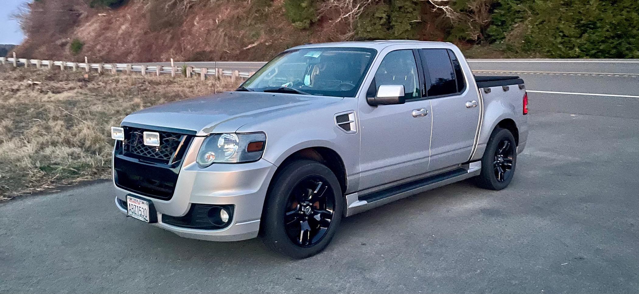

So we traded ours off at 160 K miles and it was picked up by a collector in NY who got a hold of me a year later and WOW he really is “restoring it!”. 4.6 3-valve V-8 w/slightly under 300 HP and torque. AWD with auto 6 spd. A really fun useful truck that we drove the pants off.
I added driving lights to avoid elk.

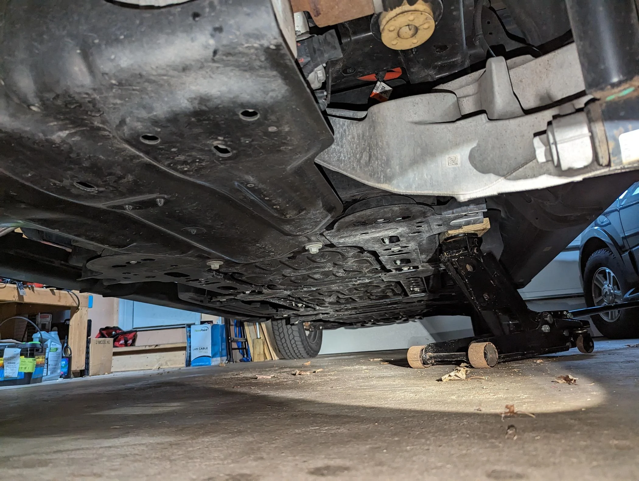

Had the dealer out today on a mobile service for a 30,000 mile service (aka tire rotation). Tech only used one jack in the middle of the frame between the two specified jacking points and it slipped off while jacking up and the truck fell down. Sounded like a bomb went off when it fell. The wheels were still on. They then proceeded to try to do it again on the other side and it fell again (I did not know anything about it until I asked about the loud sound at the end).
The dealer is picking it up tomorrow to do an inspection in the shop, but what should I keep an eye out for, especially due to the drop twice and the fact that it was jacked up from the middle instead of the designated jacking points Ford calls out for.
The first thing I'd check for is another dealer within 100 miles. Only if I didn't find one would I bother to check to make sure the tech was fired. Doing this once was dumb. Doing it second after dropping the truck was mind-blowingly stupid. That could have been very da gerous for him and, if it happened with wheel off, damaging to the truck. That sort of next-level stupid manifests itself every single day. Either the dealer sent this guy out to do service in your driveway without ever having seen him work in the shop or they already knew he was dangerously stupid. Either way, the dealership itself was being recklessly stupid itself.
As for damage to the truck, as long as the wheels were on, it was jacked on the frame, and the jack didn't poke into anything delicate as the truck tipped off it, it should be fine. This is an F-150, not a a Ferrari or a piece of fine crystal. Jacking points matter on a unibody vehicle, but there are no parts of a ladder frame that are prone to easy denting. It's a very robust vehicle and the impact of being dropped a foot onto its wheels at 0mph of forward motion is pretty insubstantial in comparison to hitting a pothole at speed.

Look in the manual for tire rotation. It tells you to rotate the back tires to the front, and the front tires CROSS to the back. There is no "rotate back to front and front to back". Therefore, you CANNOT do the tire rotation with one jack, unless you use the spare tire also.
F-150s have existed FOREVER. There has never been one jack point for the truck to lift the entire side. This tech needs to be FIRED.

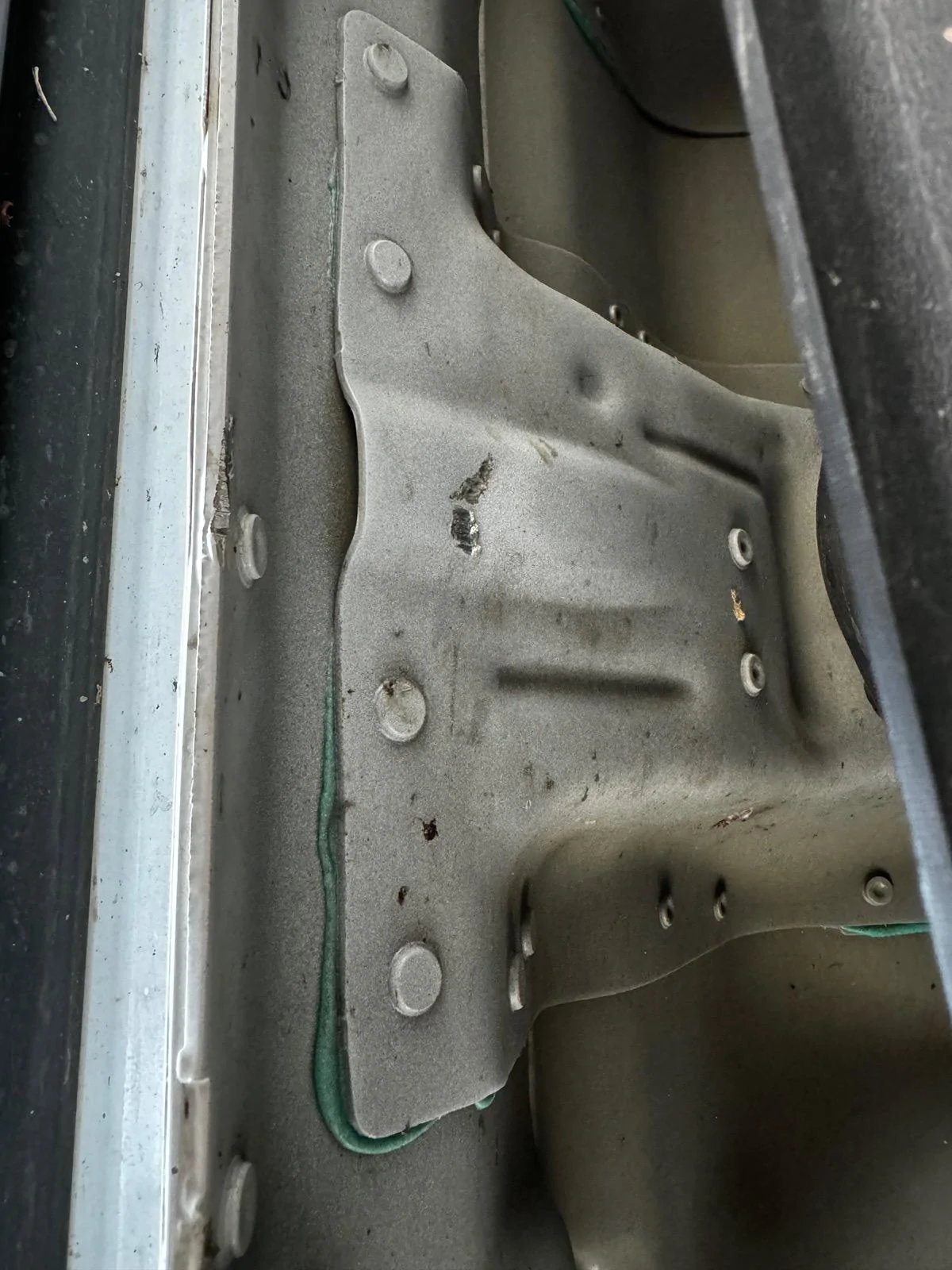

Can anyone recommend a shop in North Jersey to do an inspection? I got the truck back from them and I might be blowing it out of proportion, but they completed the inspection without taking the plastic cover off for the frame that the tech took off to use the jack. Looking under the truck, this clip looks like where the jack hit as the truck fell once it slipped off. Im sure it’s fine, but it is dented in so I would like to get it checked out by someone else just in case.
And to make matters worse, they rotated the tires wrong while the truck was up in the air!
