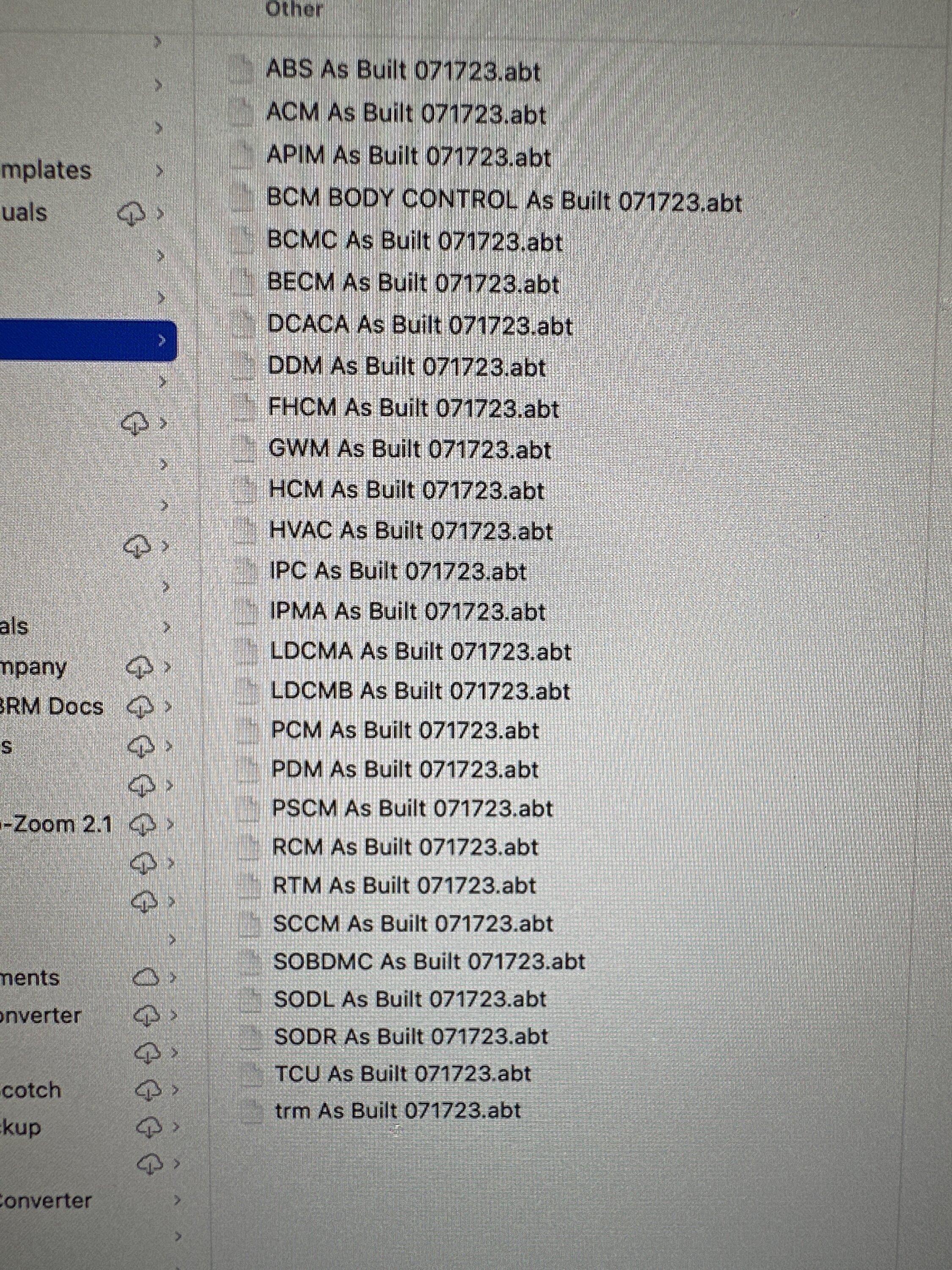

hi, I just responded to you in your other thread. I 100% have the ipma module as you should too. In addition since my last comment I also verified that the PSCM module also appearad.
I went through and backed up all on my modules one by one. Here’s a screenshot of the ones I backed up.

You need to have a compatible OBD cable.... I had to buy another cable because the one I had wasn't listed on Forscan's website to able to complete the programming for my ACC install. I ran into the same issue of not being able to access those modules with my older cable that had used for my 2018 F150 to program the speedometer with larger tires in Forscan.

Ok, I got it now. Thanks for @grantmethepower for his suggestion to not load a saved profile in FORscan. Now I have all the modules and made a full backup.
