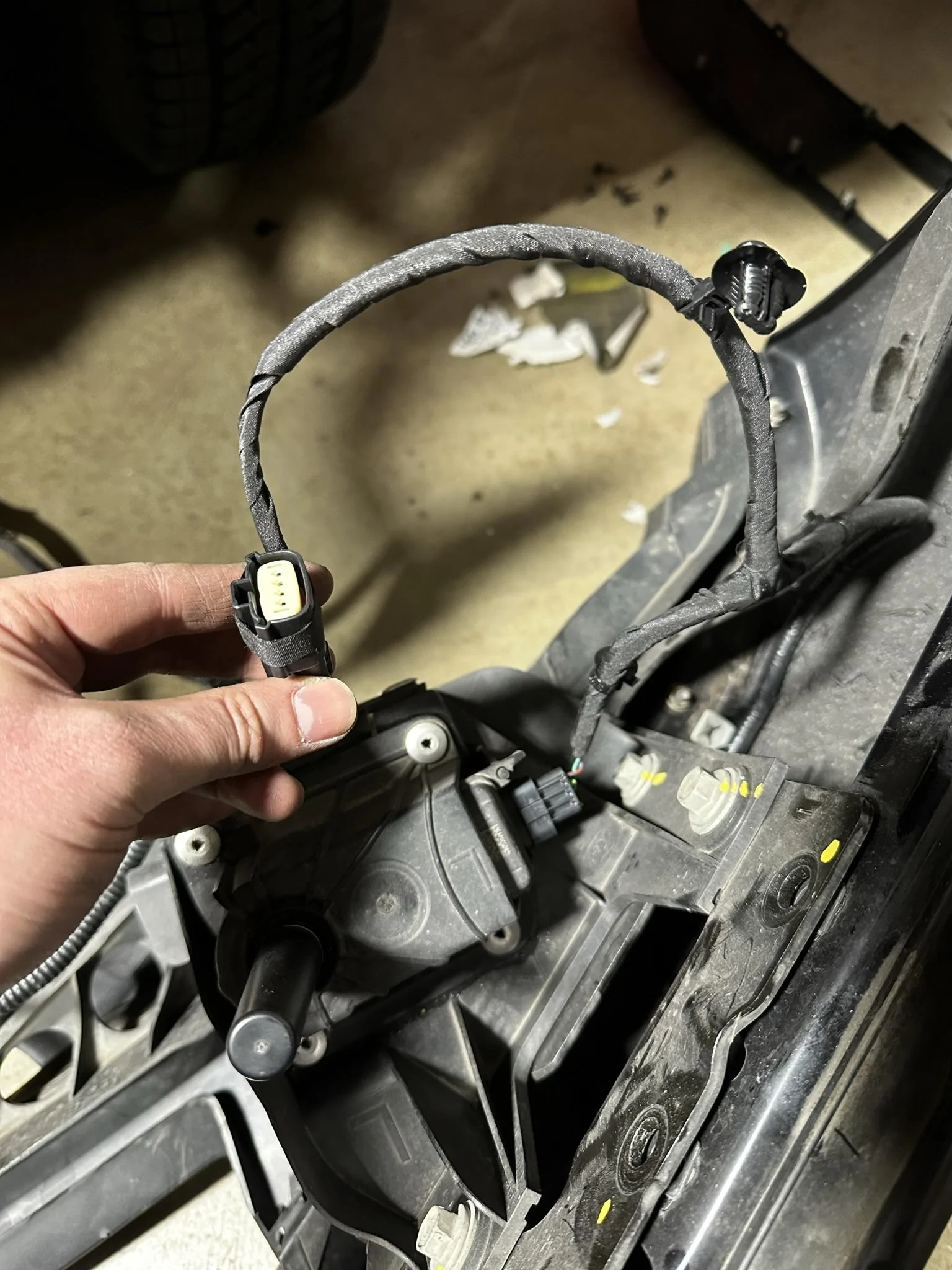

These are the parts I bought. I used Tasca website to get the first three parts and the steering wheel buttons from eBay
  • Sensor Assembly: ML3Z-9E731-G
  • Mounting Bolts(3x): W720714S450B
  • Wiring Harness: ML3Z-15K867-NA
  • Steering wheel buttons: ML3Z-9C888-D

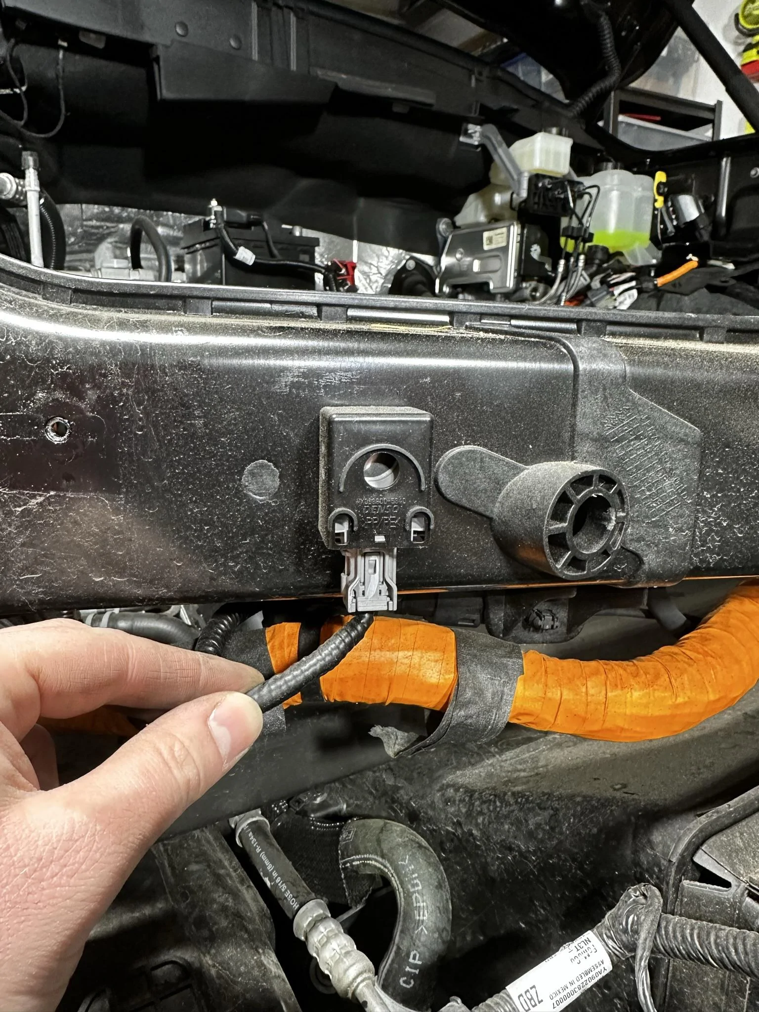

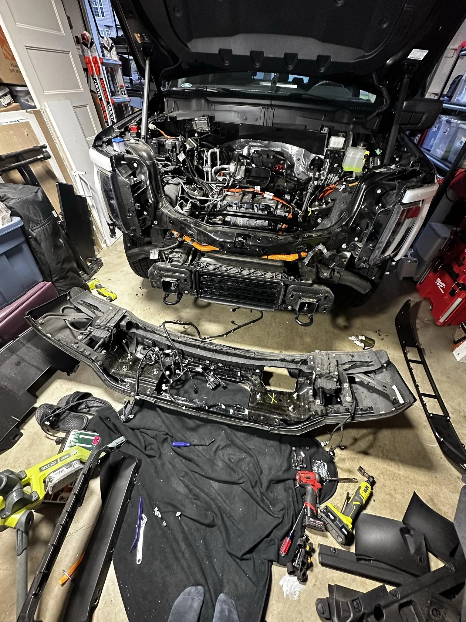

Disassembling the bumper is what took me the longest. I plan on making a video on this when I help my friend do this mod to his lightning. For now, heres a quick overview. Before starting anything, unplug the 12v battery. This is necessary before removing the airbag in the steering wheel.
Basically you remove all the bolts holding the frunk tub in. There's just one connector providing the power and lights to the tub so its pretty easy to remove. After that, remove the bottom three screws in the wheel wells that hold the trim on. You should be able to start popping trim off until you get to the bumper itself.

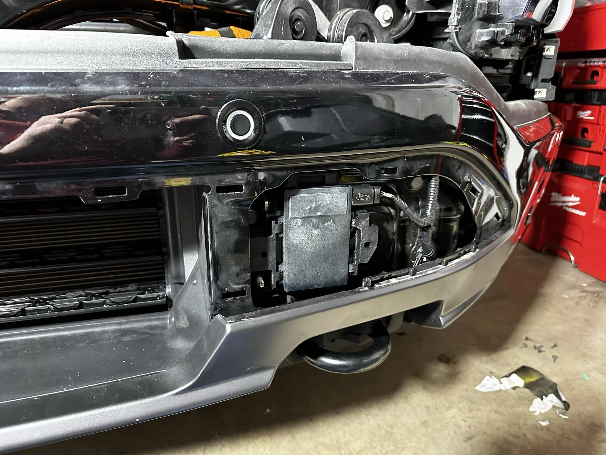

The bumper itself actually was easy once I figured it out. There are only 6 21mm nuts holding it to the chassis. Once those are removed it comes right off.
The new harness has an extra plug on each end that is used for fog lights. My XLT does not have fog lights so I just taped them off.
Well I had the bumper off, I unplugged the speaker for the frunk.... Unrelated but a nice mod.

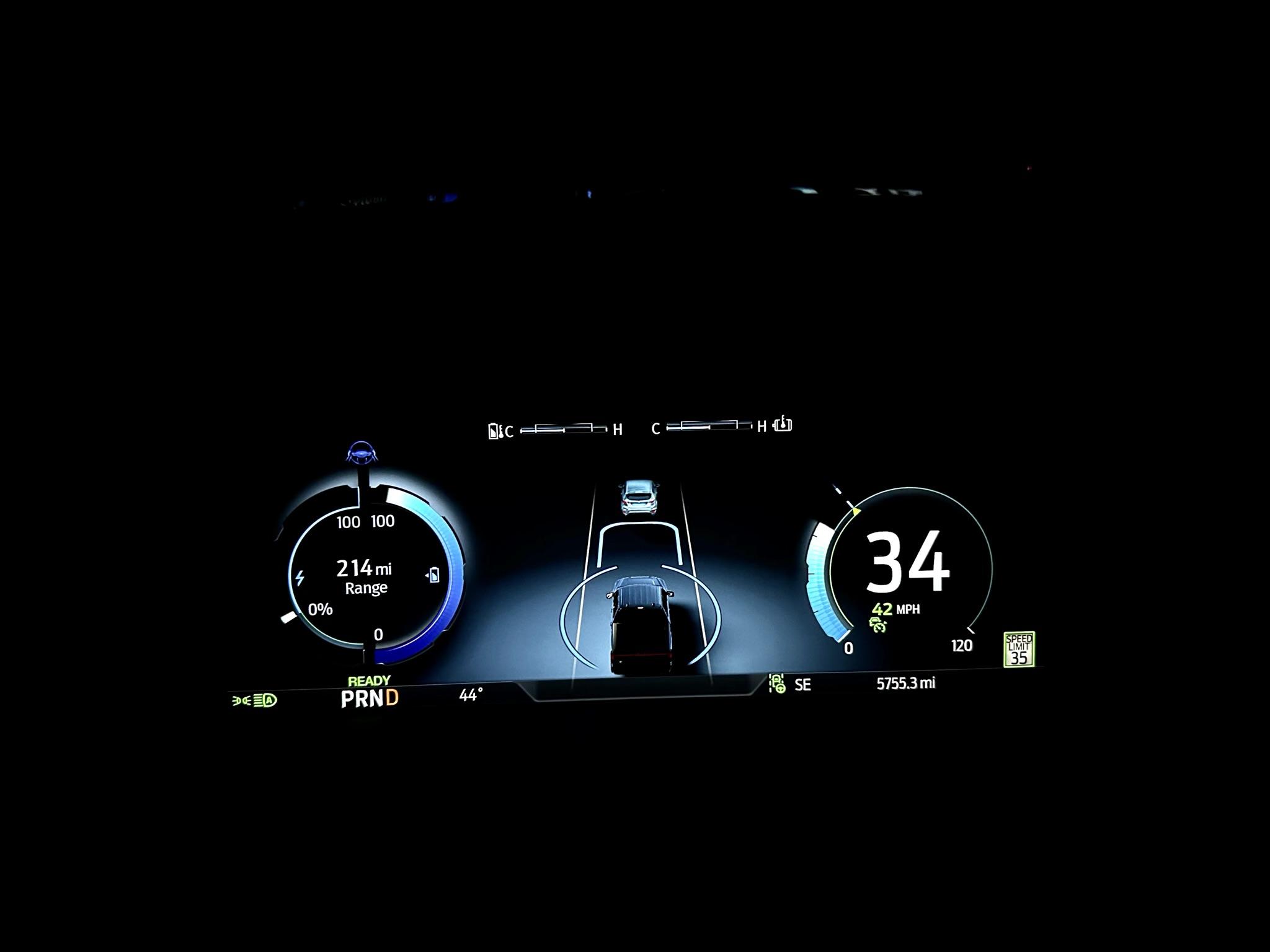

Bumper back on with the radar installed.
The steering wheel buttons need to be replaced if you want to be able to change your follow distance. Otherwise its locked to level 3 I believe. Its not much more work so I recommend it. Pop the top trim of the steering wheel column off, tilt the wheel to an angle, then use a screwdriver to unlock the airbag. Watch a video online, its hard to explain. Once that is done, there are two screws holding the trim on. Remove those and pop the trim off to access the button. FYI the new button wont work till you reprogram the truck with Forscan.

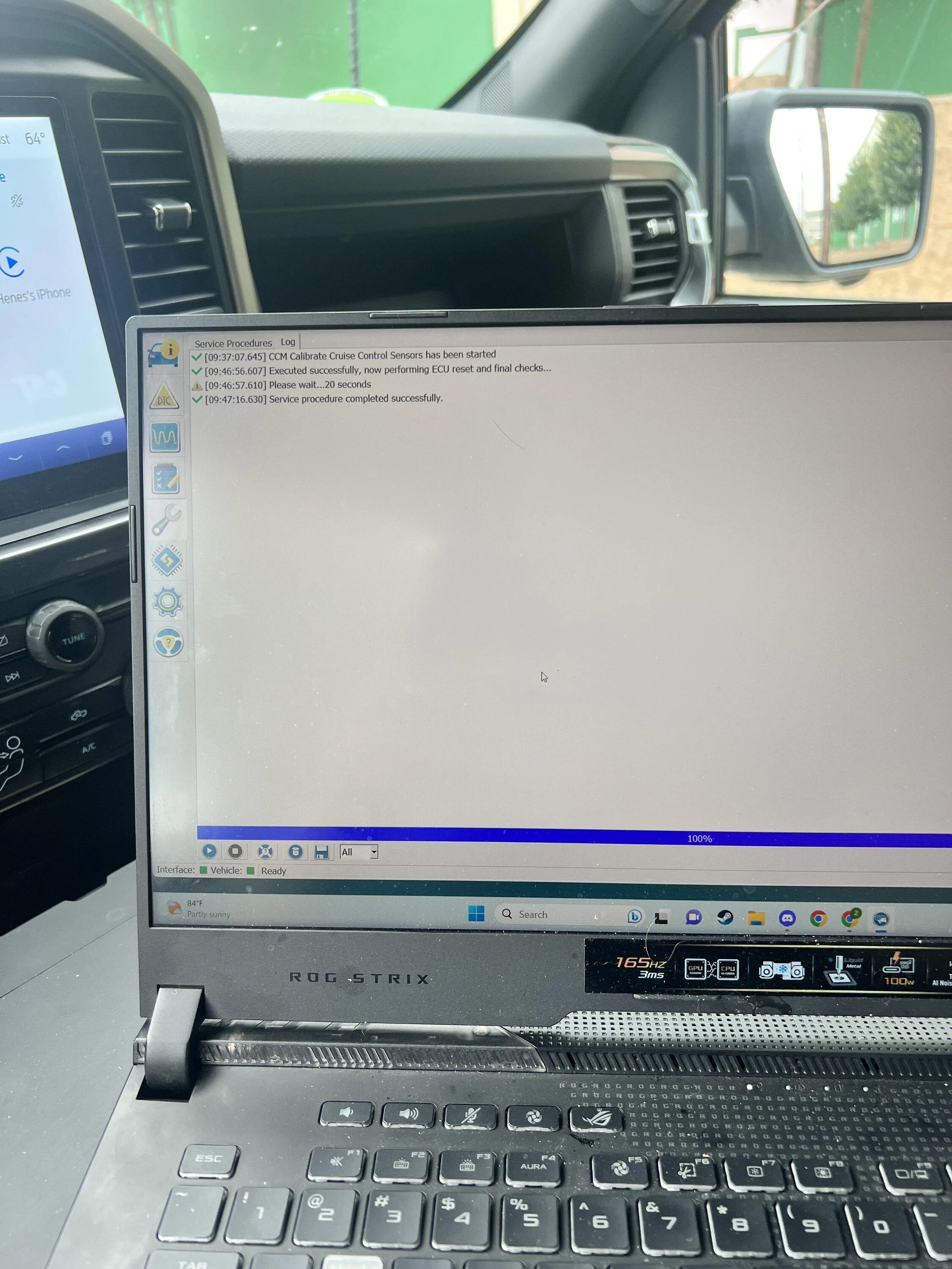

Okay, once again disconnect FORScan and turn the truck completely off, then back on. Reconnect FORScan BUT do not use the saved profile. Let it rescan for all modules. Once the scan is done, go to the DTC button on the left and CLEAR ALL DTC. This is very important. Cycle the engine after doing so.

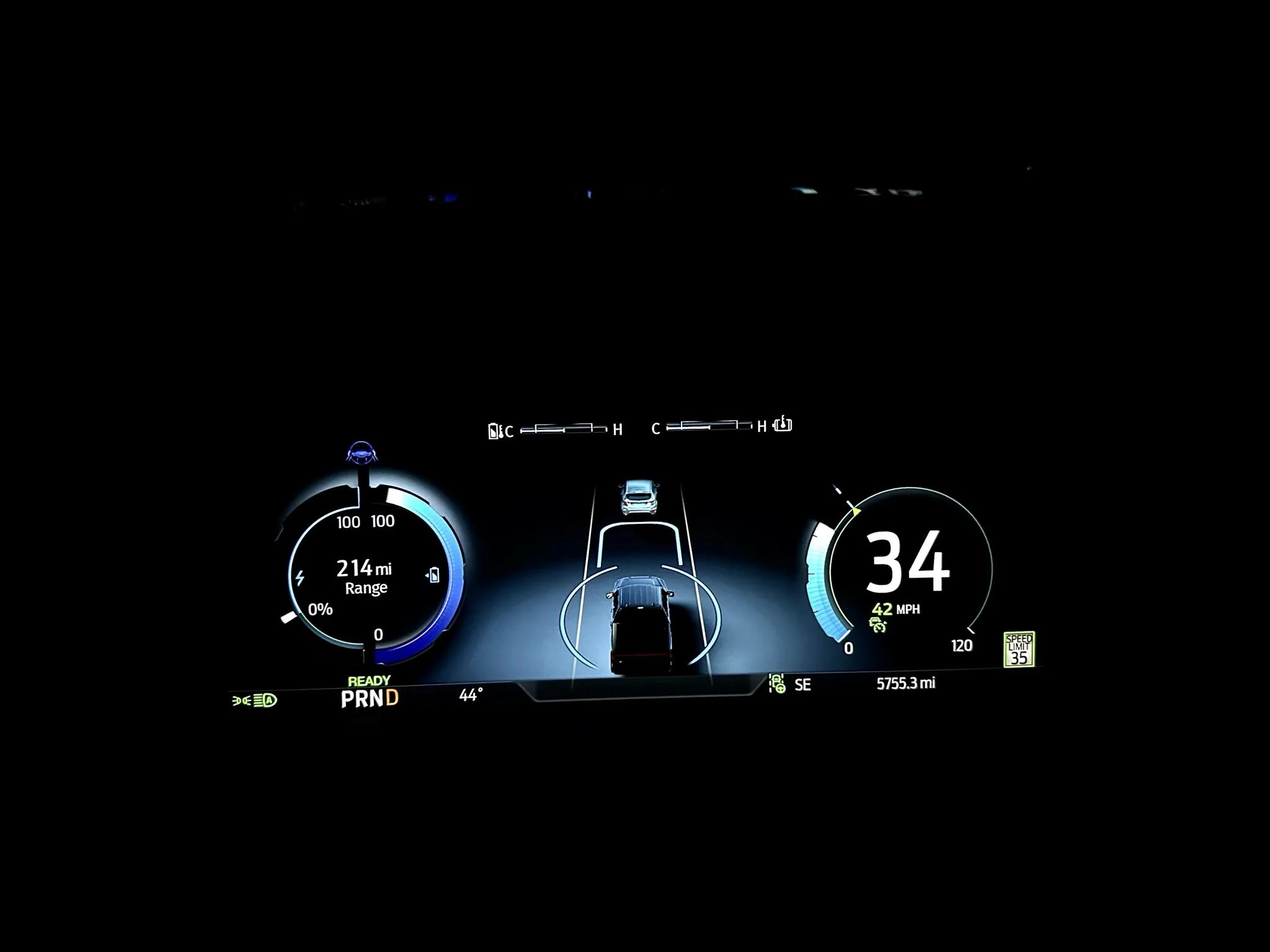

Theoretically you will have a few errors on the screen such as front braking disabled or something like that. These are all related to the radar not being calibrated. You will use FORScan to calibrate.
-Go to the wrench icon on the left to get to the service menu.
-Select C-CM Calibration.
-You will now need to drive around in traffic while following some vehicles and let the truck calibrate.
-Once calibration has finished, the errors on the screen should disappear after a power cycling.
-Theoretically everything should be working. If not, post here and Ill try to help.

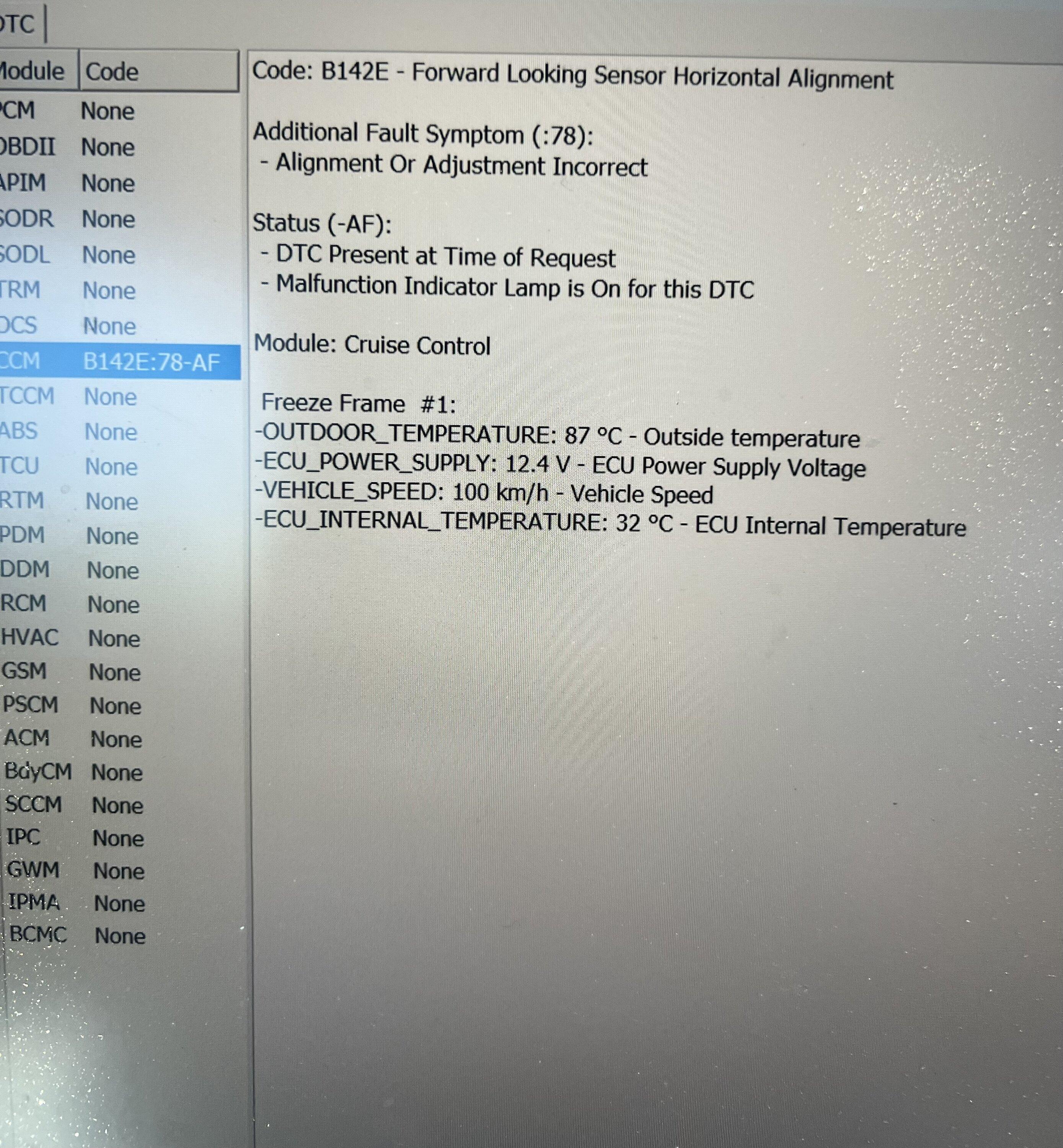

I’m having an issue with my install where after I calibrate the ccm it says that the horizontal alignment is incorrect. Any ideas
did you Clear/Delete all DTC's?
do that, which will probably clear any and all 'faults', as these are just part of the process when installing new equipment... I cleared mine, had none afterwards, and just pulled my camper to the beach and used ACC and LC much of that time...

Yes I have cleared it many of times and it will still come up. And I have calibrated it a total of 7 times

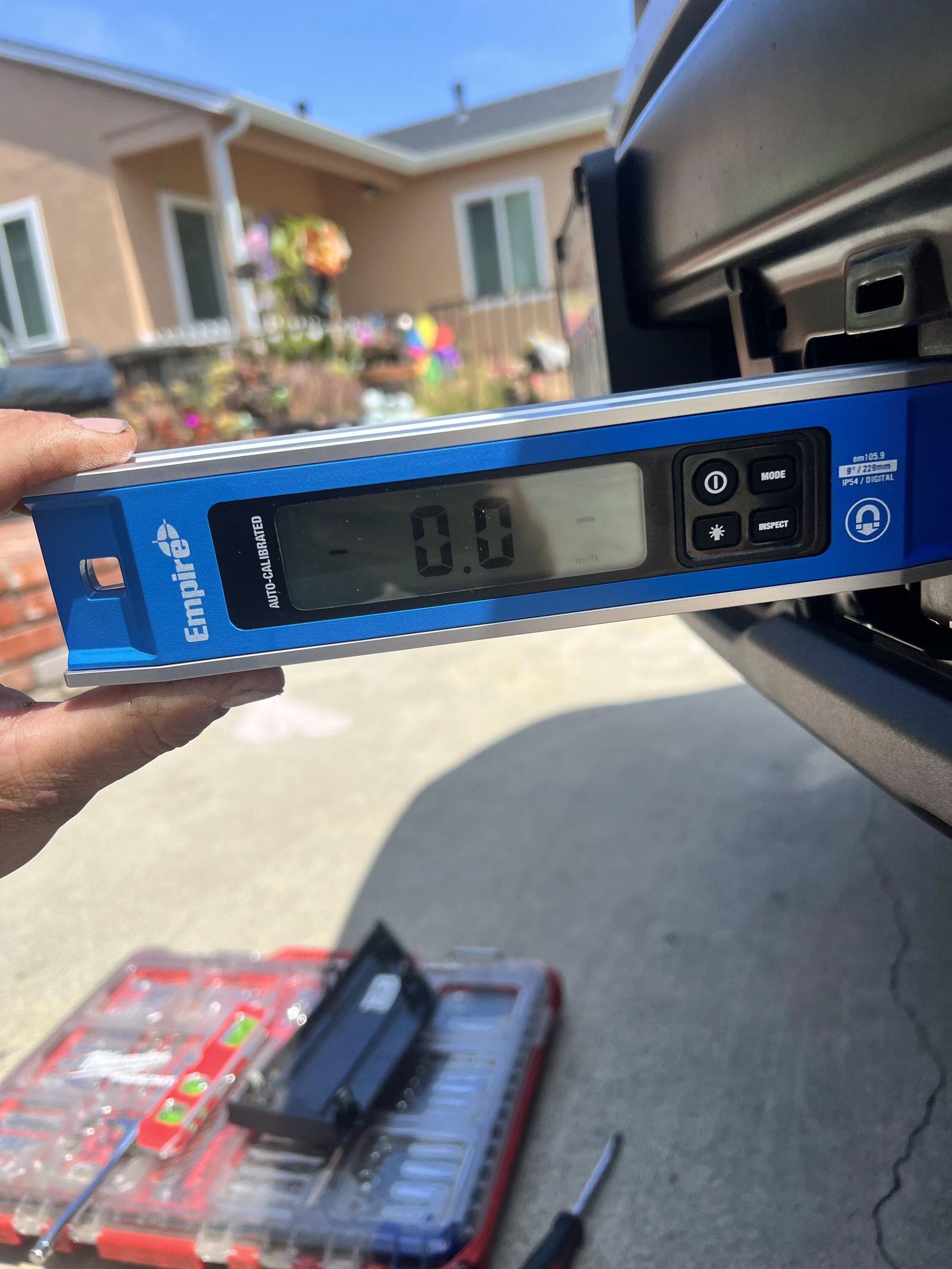

Humm, this is odd, by "horizontal" id think that would mean left to right which is not even adjustable if I remember correctly. the only adjustment available which is done with the screw is the vertical adjustment which you are using the level for.
Maybe a Ford mechanic can confirm. Do you still get the messages " not calibrated " on the IPC?
hturnerfamily
1,968
2,408
rural Georgia
Owner
I just tightened my three screws down, didn't know there was any 'leveling' involved... I don't think that means the radar device, itself... sounds like some other issue.

No the only thing that’s not happy on the dash is the pre-collision is unavailable because of the ccm. Yeah I can only change vertical alignment. The software calibrates the horizontal
When my truck didn't like the programming I changed I reverse all back to stock and went through all the changes one by one. I wish you luck
