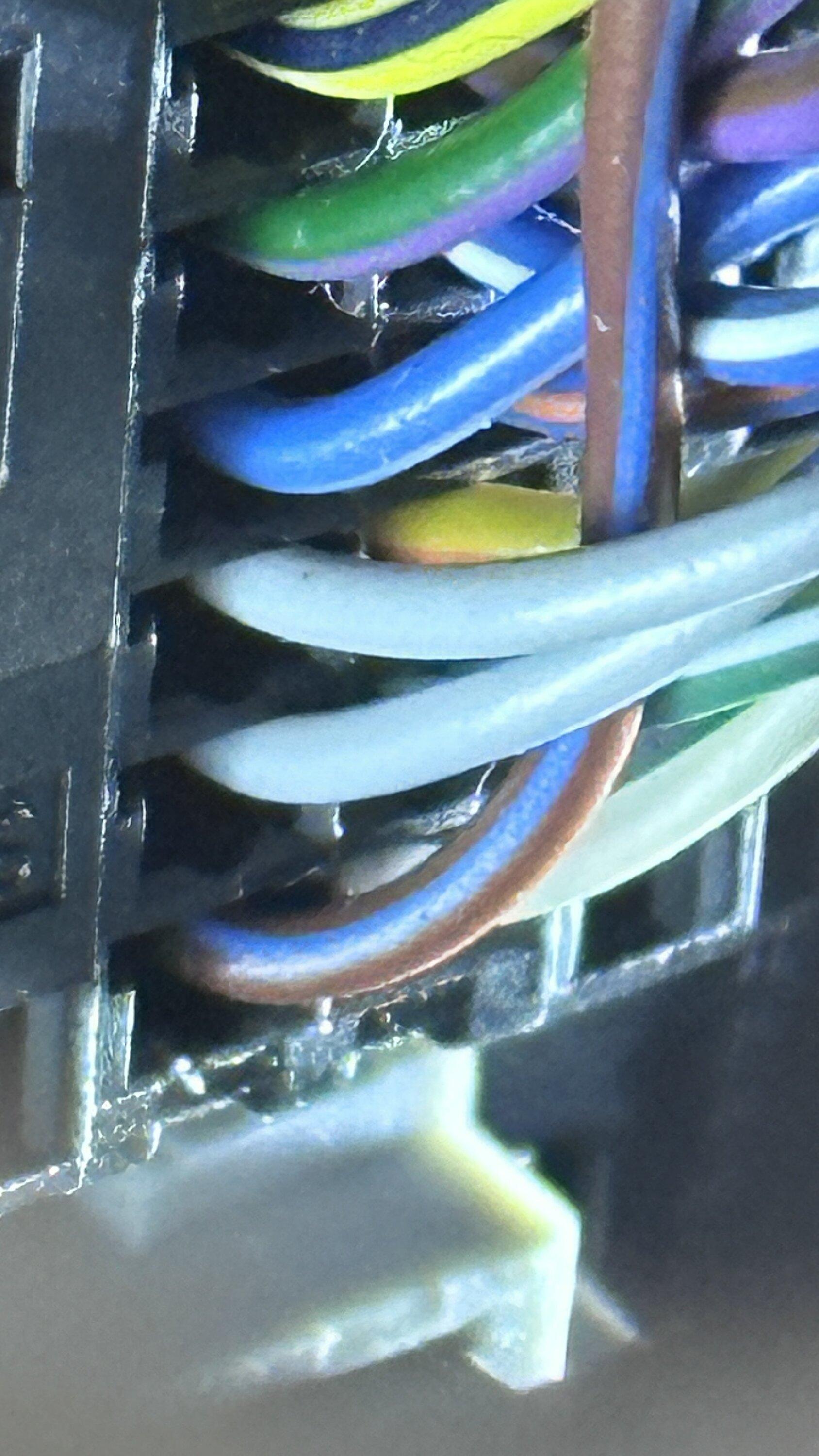

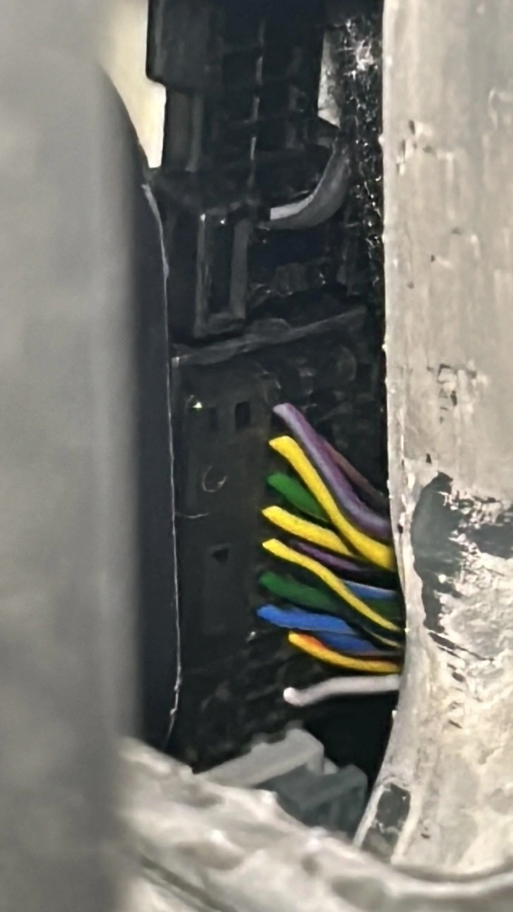

Hi all! I had planned this for my second big project but I'm now 99.9% sure I do not have the required wires in my 2023 Pro and I'm beginning to wonder if it's too challenging. The FORScan stuff ive now gotten pretty comfortable with. The wire harness and the rest, no prob. But those damn wires.
Here are the pics from my driver side access and under the glove box. Can anyone just glance and verify I'm looking at the correct missing wires?
Ford F-150 Lightning DIY: Installing ACC (Adaptive Cruise Control) and LKA (Lane Keep Alert) to 2022 F-150 Lightning XLT IMG_1837.JPG
Ford F-150 Lightning DIY: Installing ACC (Adaptive Cruise Control) and LKA (Lane Keep Alert) to 2022 F-150 Lightning XLT IMG_1841.JPG
Unfortunately, you don't have the wires. In either location.
I'm not even sure anyone's done it missing the Wires on the Drivers side.
But, I didn't follow the no-wires people enough as If I didn't have wires, I wouldn't do it :)

Is it still possible if I do not have the wires in either location? I did not see them through the driver side panel OR the dashboard location. Someone just said that without the wires in either location it isn't possible.
I haven't seen that any of the lightnings were missing the ipma wires, are you sure you looked at the correct plug?
Ha! No, no I'm not sure. This is what I saw that looked like the other images but seemed to be missing the wires. This is through the little view in the access panel so it's certainly possible I was looking at the wrong one.

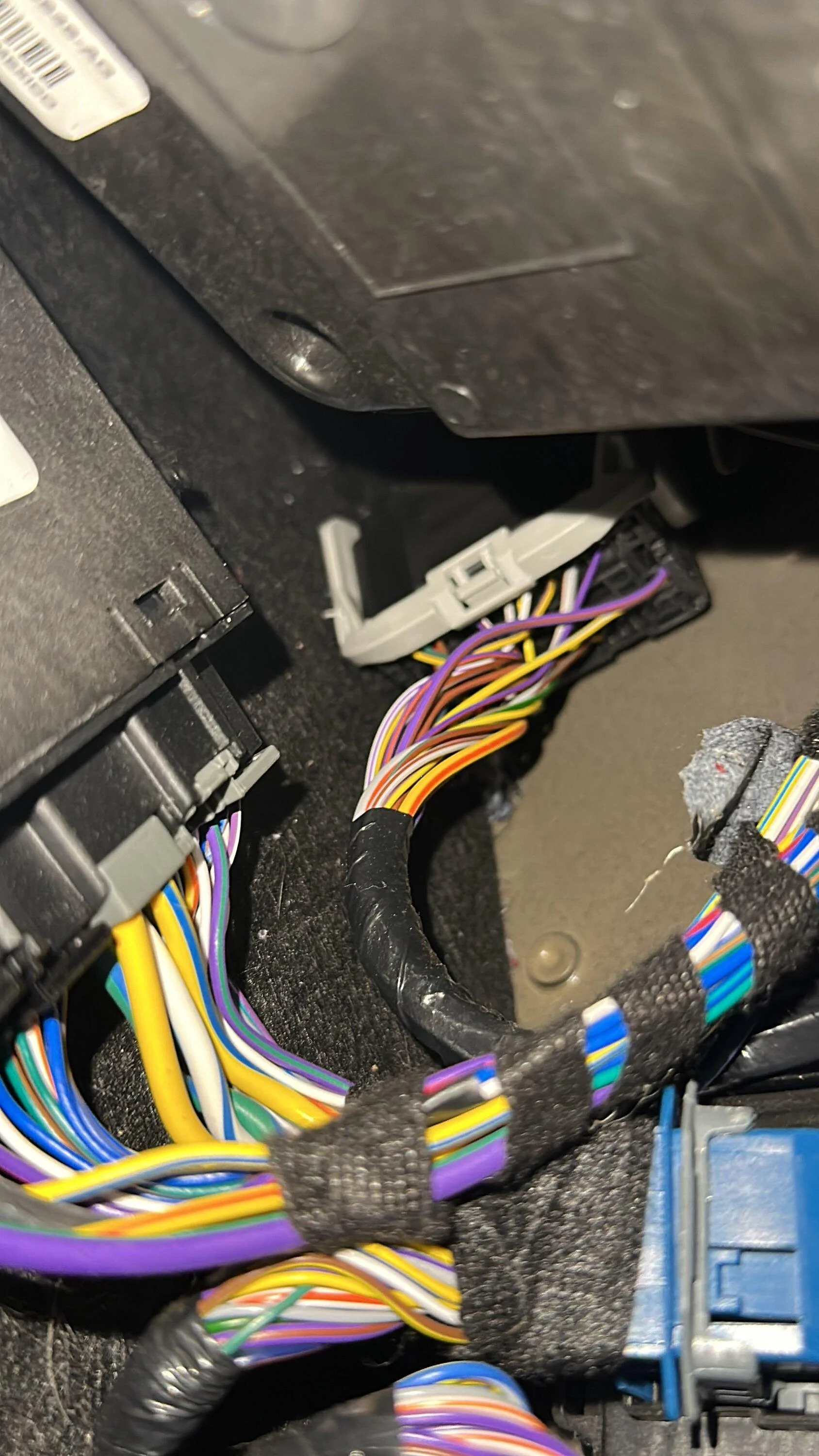

I'm pretty sure that's the plug underneath the one you need to look at. I think the ipma one is grey

This is the one you are looking for at the IMPA
you do not have them, and you can compare your 23 PRO with my 22 PRO with Tow Tech...
Ford F-150 Lightning DIY: Installing ACC (Adaptive Cruise Control) and LKA (Lane Keep Alert) to 2022 F-150 Lightning XLT Confirmed driver side HARNESS pre-wired
