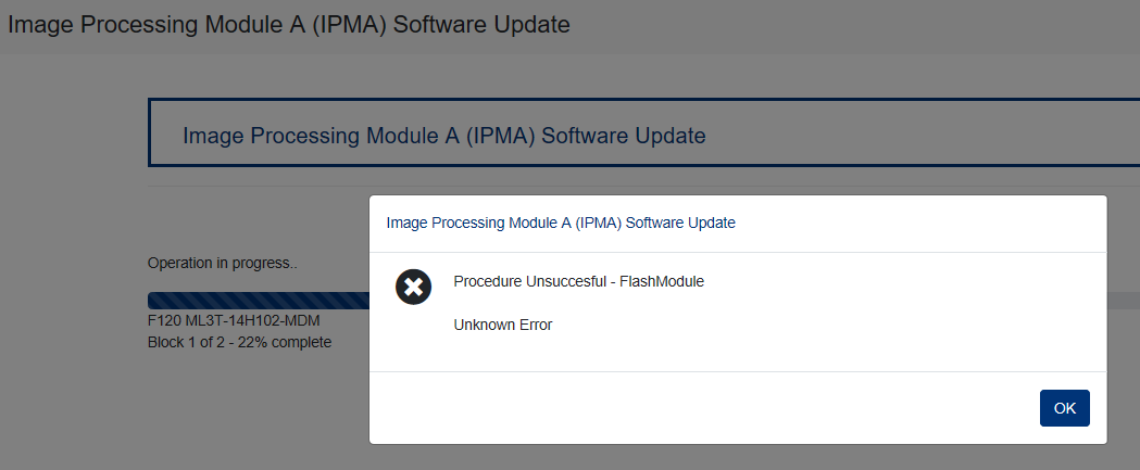

I've gotten everything installed until the IPMA failed and now I have DTCs like a Christmas tree. I've tried to run it again and it appears to be running but still fails. Attached is a PDFs of a print out of all of the DTCs now.
Those are t really odd. When a canbus update goes it cuts comma to everything. Let me know if you can’t get it I can fix it so don’t worry like you didn’t something you can’t recover.
I’d suggest to chill tonight and try in the am
Thanks. I’ve stopped for tonight and will try again tomorrow. Everything has gone smooth until this last one.

Ok. Well we can fix it if you can’t get it handled just let me know

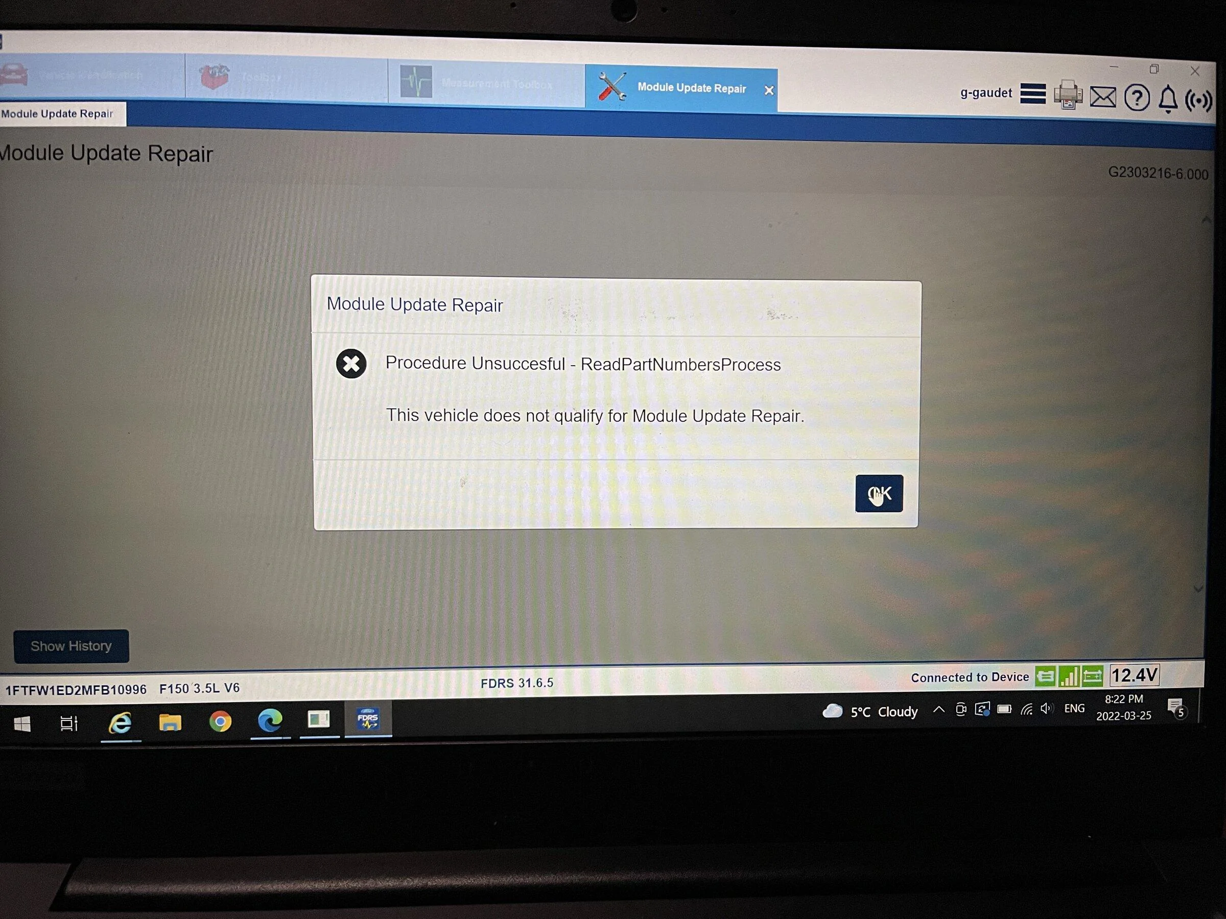

I tried the TSB 22-2117 OTA fix today. Didn’t work for me. I’m wondering if it wasn’t happy since I’m already updated past 1.7.1.
I suspect there are 2 parts to this “fix”: one applies the APIM repair to allow for easier updates where we all struggled at 1.7.1 and the second is Ford fixing the server side to allow the failed 1.7.1 data to clear on their servers and to allow new updates to push.
That is only for people with 21146 and a greyed out uodates options page. No one else
