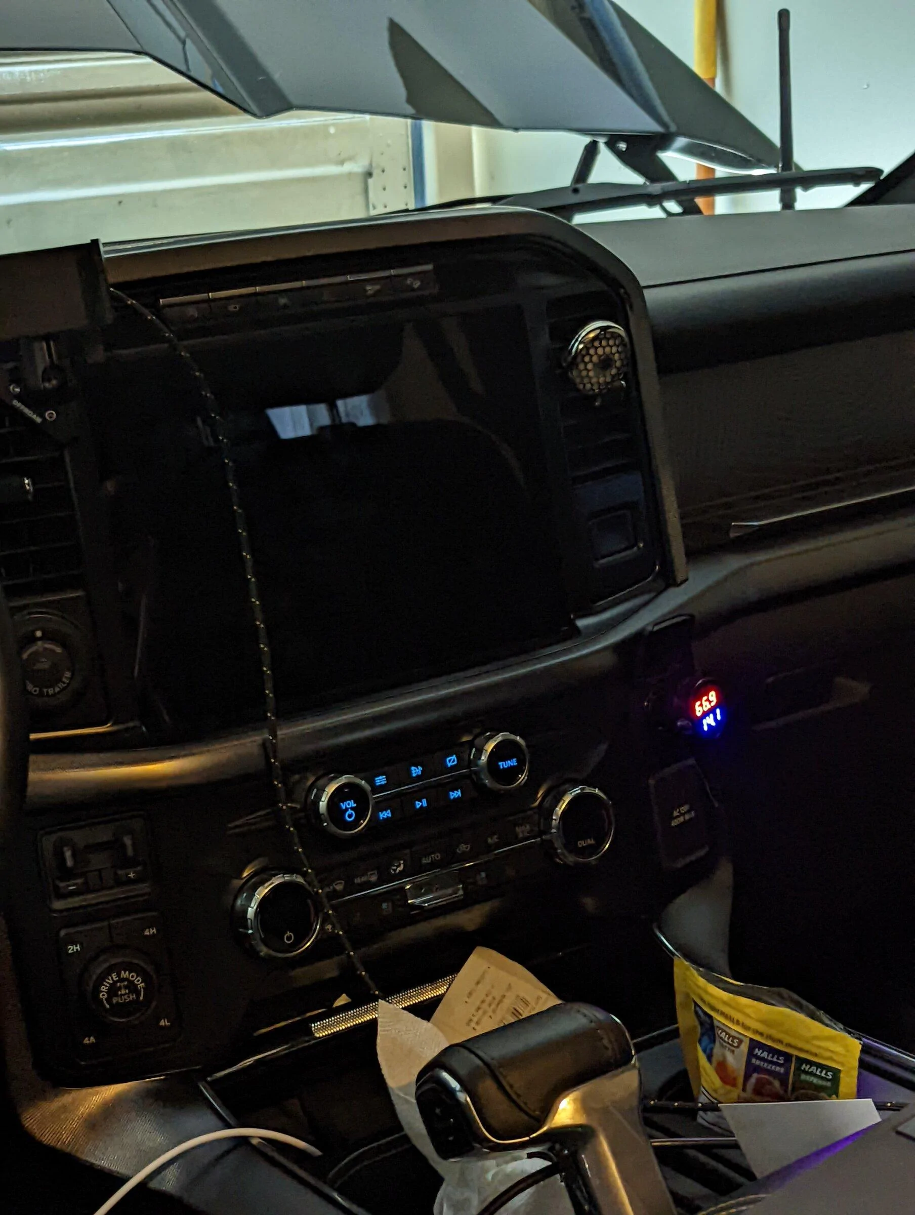

Battery voltage is ~13. Charger has good connection. Here are pics of what I'm seeing taken through open back window.
I get the same 5hing
Same thing happened during CCM, ipma, and pscm last night completing updates. The truck shuts down during the CAN update but those stay lit up. I am using the suggested charger in the post in PS mode. FdRS showed 14.6 vdc. I did not encounter any issues during g or after install. No DTCs in any module...
That is something different. During an active update, the truck behaves electrically differently. It’s really not telling you anything to monitor that stuff. What @dougbillings was talking about is what he was seeing during the shutdown period after the USB update had completed and before the truck was restarted.
