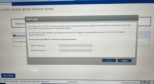

I have been doing a number of updates using FDRS over the last few days. I started to do the BCM and got this message. Why can't I update the Body Control Module?
Has anyone else seen this message? I could have sworn I updated BCM when I first started using FDRS.
Any more updates on this? I still see this message for the BCM update.

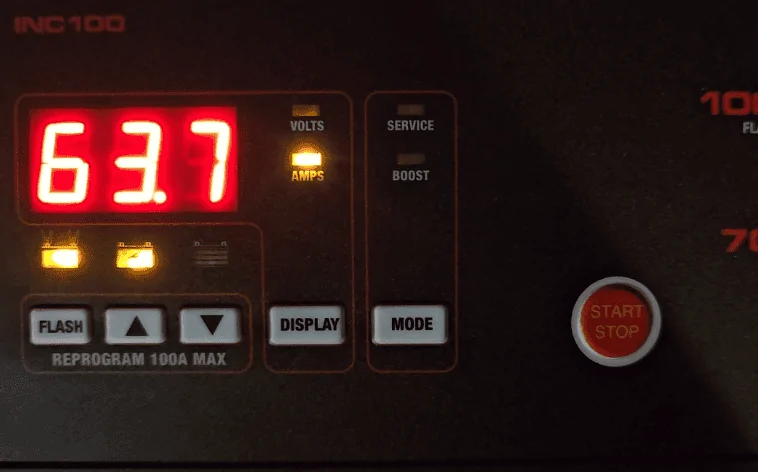

I don't know if anyone has posted this before, but I wish I had known how much current is actually used during an update, because, had I known I probably would not have tried to take some shortcuts / skimp on the power supply.
Granted, 64A is on the high side, it hovers around 50A quite a bit, never above 70A that I saw and never below 40A. But lets say the average is 50A, that means that anything less than a 50A power supply and you're eating away at the 12V LVB Battery which is only 35Ah.
For example, if you do two Clore 20A in parallel (for 40A total), you're now using up 10A over what they can supply, so your 12V battery will (in theory) last about 3 hours (IF, big IF, it's in tip top shape and fully charged when you begin) before things start getting really sketchy.
The update I'm doing right now (IPMA module) took about 2.5 hrs and supposedly there are others that take even longer.
So yeah, having seen this I probably wouldn't recommend anyone using anything smaller than 65-75A

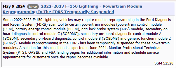

This just in:
....June is a bit further out than I expected the response to be though.....
Hey @Mike G I was just wondering if you heard anything about Powertrain Modules starting back up in FDRS. Just curious as I'm sure my truck needed one but of course couldn't do it right now due to the suspension. So I was just curious, and again thank you for all your awesome help.
Mike G
Jan 6, 2022
1,766
2,577
N. AL, USA
Not as of this morning.
