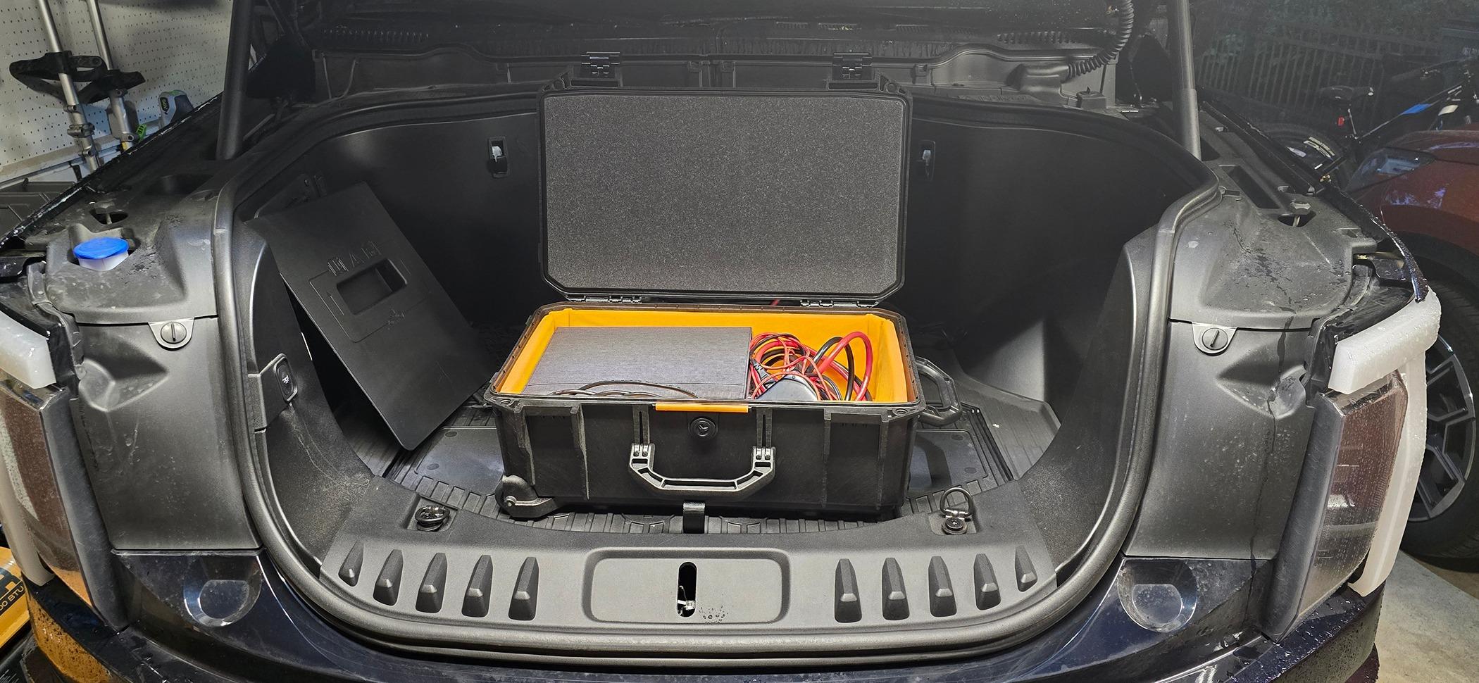

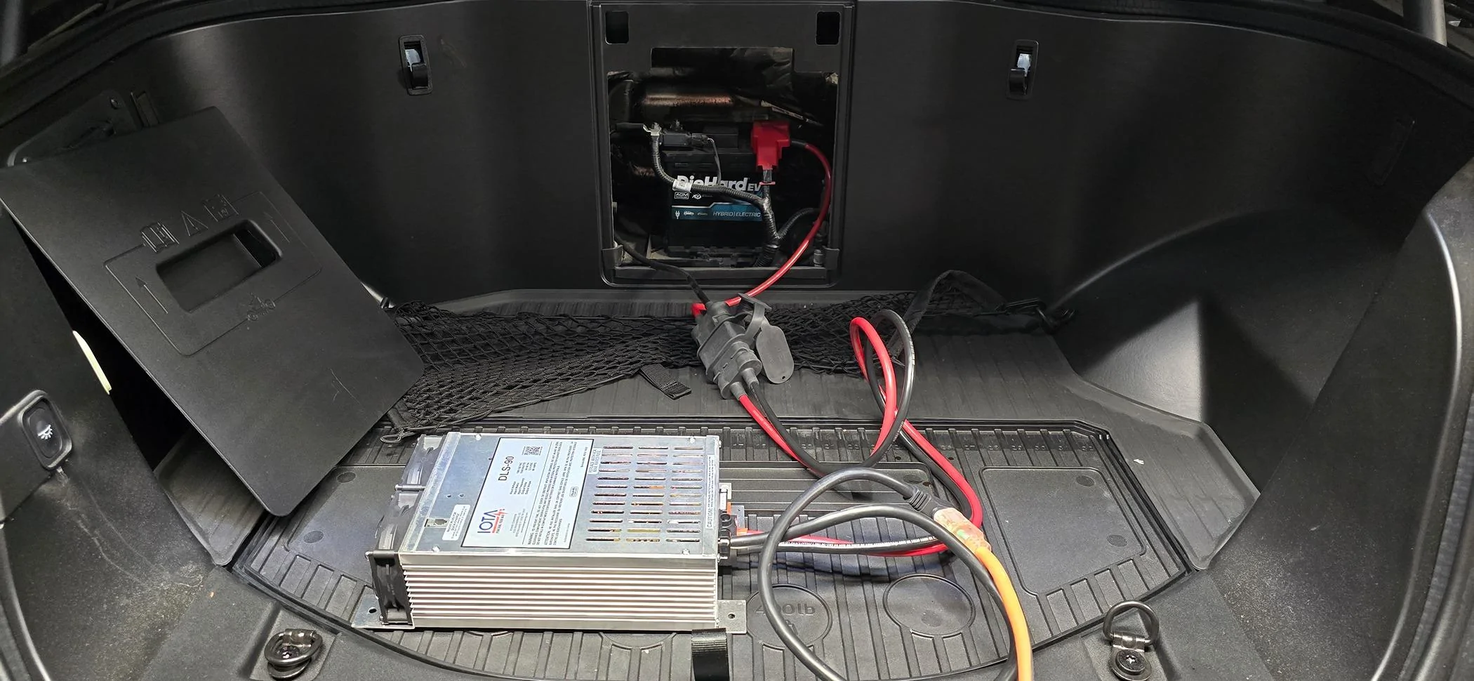

I haven't had a chance to test mine due to the "hold" on powertrain updates
So, I ran what few updates I had pending this morning (door modules and HVAC) so nothing super long, but the IOTA did it's job just fine, held voltage (per FDRS) at 12.8-13V (as mentioned in previous post, I left the IOTA "stock" at 13.6V and didn't use the "boost" jumper).
Pics of my "update case" and the IOTA setup (which takes a full 5s to plug in).
Ford F-150 Lightning ECU module programming guide using FDRS 20240517_061532
Ford F-150 Lightning ECU module programming guide using FDRS 20240517_061743

Today I had partial success getting updates applied, but some modules didn't install. The GWM, TCU, IPMA, and a couple of others installed just fine. Then I tried to update the CMR module. It ran for four hours and seemed just to be recycling through the same commands, though there aren't any indicators of its progress.
I thought my power supply would keep the battery in good state of charge, but it wasn't able to keep up, so I had to cancel the update. After I cancelled the update, I get the purple DTC indicator, so that module seems to be offline right now. Unfortunately I have a trip this coming weekend and I don't want to drive with an offline module.

Is that an 8ga connector set? Or is it 6ga?
