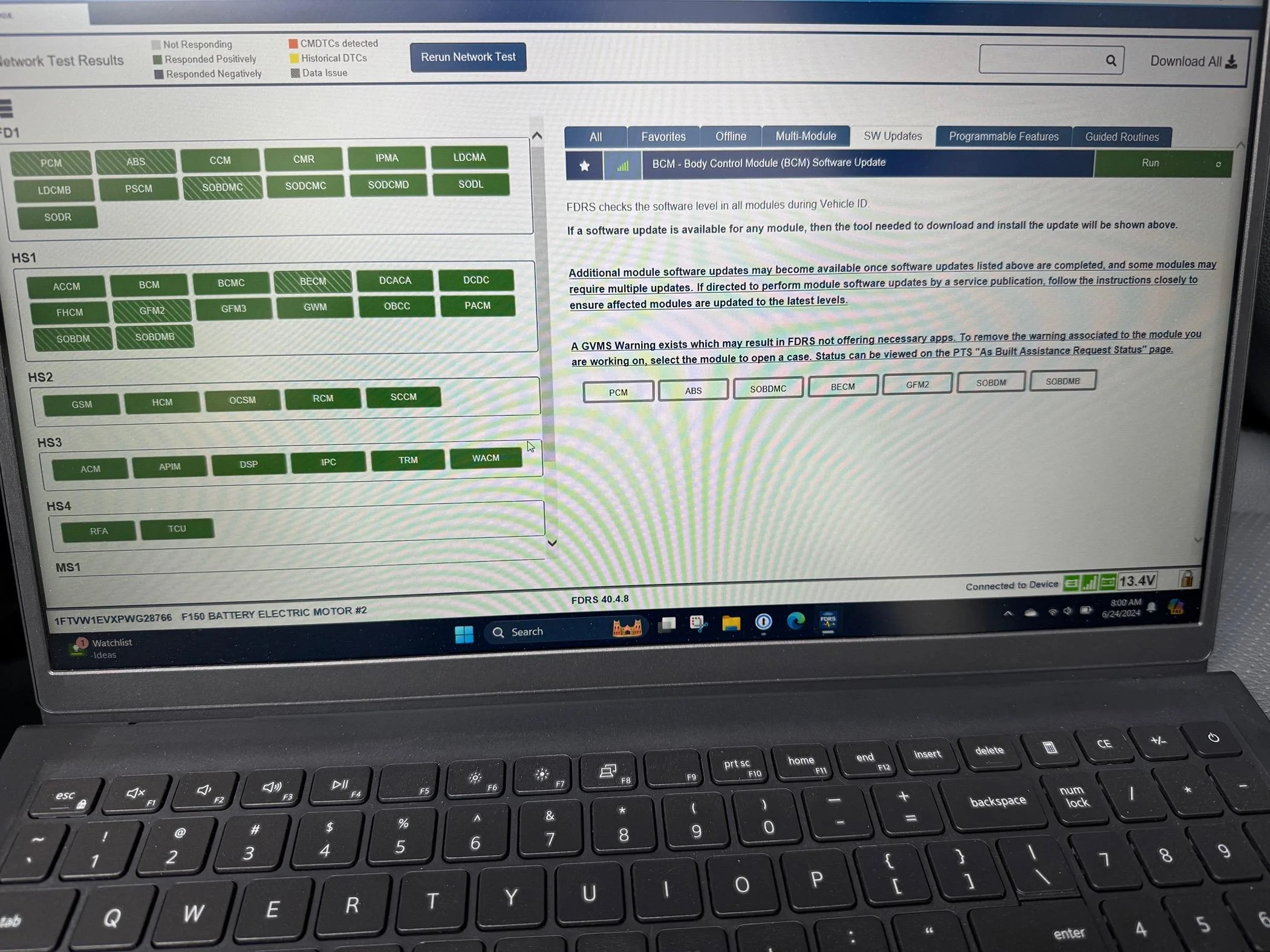

I have a 23 that got a recent gateway update. Ran FDRS this morning and didn't see any available APIM update, BCM still shows due to the need for a user id.
What I did notice is the last sentence saying " A GVMS Warning exists which may result in FDRS not offering necessary apps. To remove ...." see capture below. You can see the listed modules have a green striped box, not a solid green one on the left!
Anybody else seeing this and if so how can it be resolved?
Documented over in this thread and specifically this post.

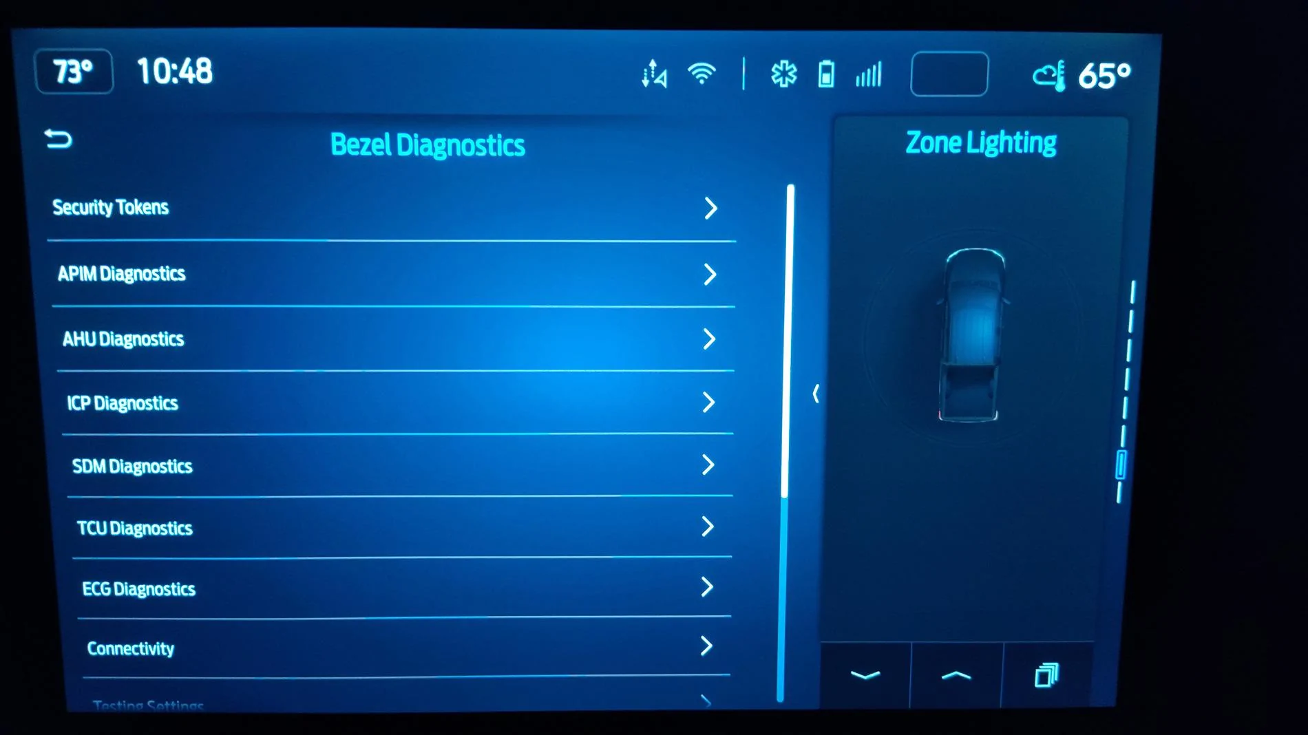

Sorry, have not seen much of the past in this thread, if this has been discussed before, but, for viewing diagnostics or settings or doing tests, how much better is FDRS than the Bezel Diagnostics, which has lots to show?
[to access on 15" screen?] Bezel Diagnostics. turn the radio to AM or FM press and hold volume down and arrow seek left at the same time
[or for my 22 XLT 312a 12" screen w buttons:] push steering wheel rightmost "go forward" (arrow seek right) button and also the Fast Forward button at the same time (of the audio system buttons under the 12" center screen) for ~10 seconds. Does a speaker test first for x seconds or so, then the Bezel Diagnostics access list shows up.)
Ford F-150 Lightning ECU module programming guide using FDRS 1720079641545-8y
Is there a listing of all the menu items available in Bezel Diagnostics?
most people don’t use FDRS as an extremely expensive diagnostics scanner or settings changer — Forscan is usually a more popular tool for that purpose and works with much cheaper cables too.
We mostly use it for updating firmware earlier than OTA offerings and for some tasks like recalibrating and installing specific modules, and bezel diagnostics can’t do that at all.
