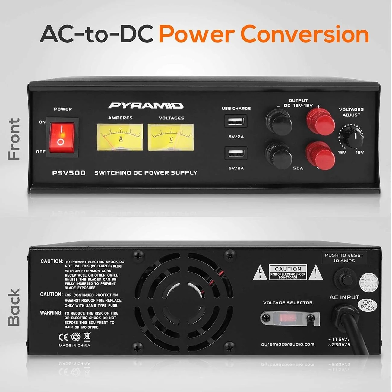

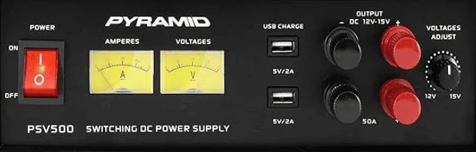

I ordered the Pyramid PSV500 power supply, it should be delivered today.
I assume that I need to hook up the alligator clamps to the bottom terminals (50A) and then set the Voltage Adjust to around 13.6V?
Or do I hook the clamps to the DC output on the top?

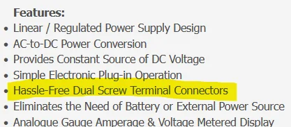

They are the same. Just a way to give you two places to attach.

Oh, well now I feel dumb lol.
But I do the Voltage at 13.6v (or as close as I can get to that)?
It will try to maintain whatever voltage you select. It will start supplying once it’s voltage is above the battery voltage. So as long as it’s set above battery, it’s working.
I’ll be curious your experience with this unit. I have bought and researched Pyramid or Pyle products in the past for audio equipment. They are typically cheaper compared to the well known brands. And sure enough they never seem to deliver on their specs especially related to power output. I think they will use peak instead of sustained.
Not to scare you away because they have made advances with the switching power supplies. But definitely watch your voltage output. Also I’d be curious how long this could output a full 50 amps.
Not to scare you away because they have made advances with the switching power supplies. But definitely watch what your actual voltage output is. I’d be curious how long this could output a full 50 amps.
It worked great for me. I never saw it go above 40amps, and the lowest the voltage of the battery ever got was 12.4V for just a split second and jumped right back up to 13.6V.
