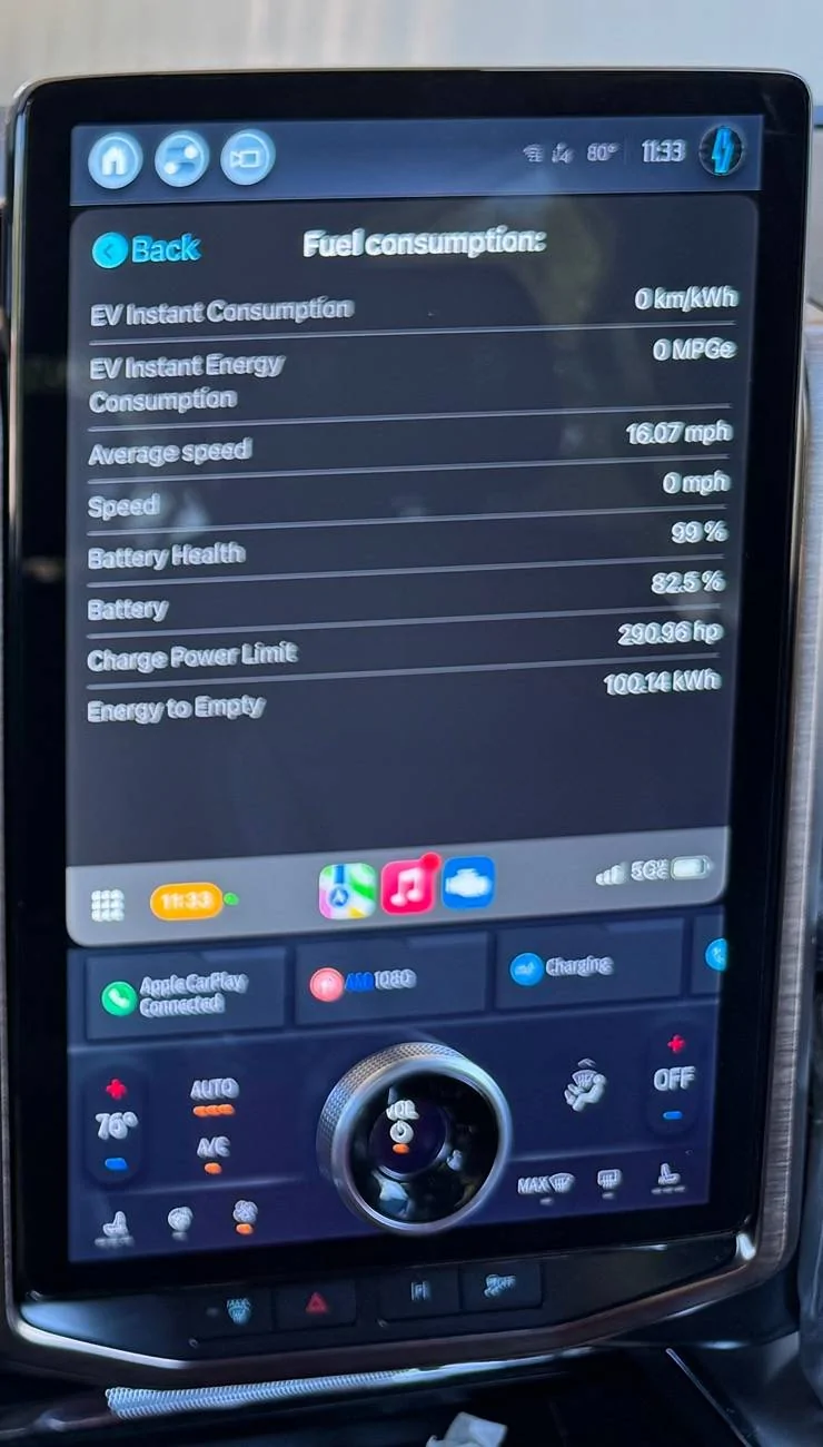

As I stated earlier, it updated something because I had these icons (top left)until the ā€œfailedā€œ update

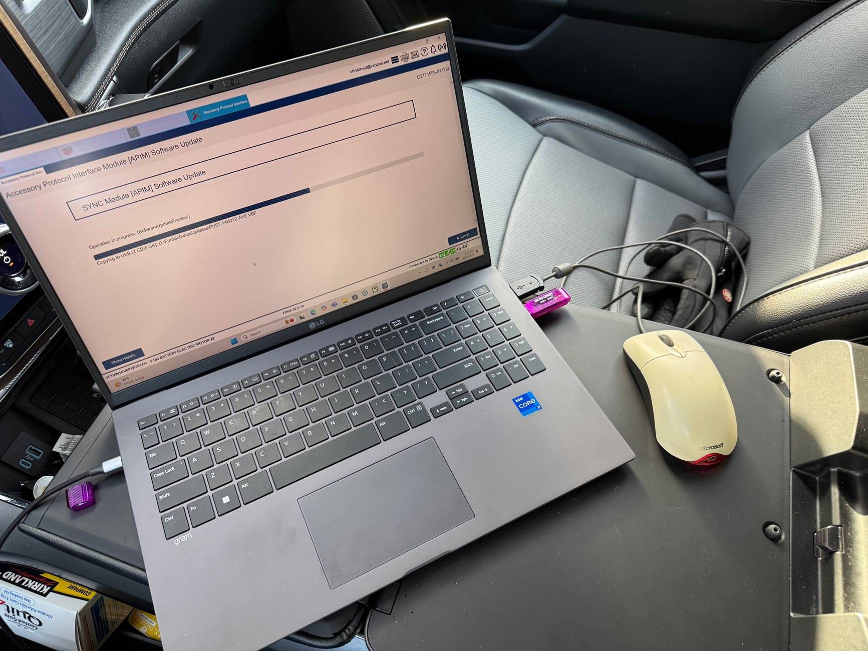

Tried it again and it went through successfully did not change my Sync version though? (What is the current highest version of SYNC?)
30 minutes into IPMAā€¦. Hopefully this one is not as long as the first one, but at least I have the proper power supply this time.šŸ˜“
On a sidenote, I do love my fold down armrest/console for doing these updates.
Ford F-150 Lightning ECU module programming guide using FDRS IMG_1240
I am old school and like a physical mouse!
I seem to click on the wrong stuff when I use the touchpad so the mouse makes it easier!

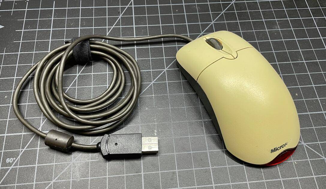

I know what gift I'm bringing you at our next meetup! Two hours ago, I was cleaning out a drawer and decided to throw this away. Not now. It's yours as a backup. Even faded yellow like yours! And PS/2 compatible.

Hahahaā€¦
That is absolutely Hilarious I mustā€™ve laughed for two minutes! I probably still have the PS/2 adapter somewhere! Yes, I am a pack rat!
I do have newer and smaller (better looking)mice but this oneā€™s great to just throw around. If I drop it in the driveway or something, itā€™s no big loss.
I just thought about I could put under my frunk to scare away the real mice-so if they try to move in again, they will realize itā€™s already occupied!
