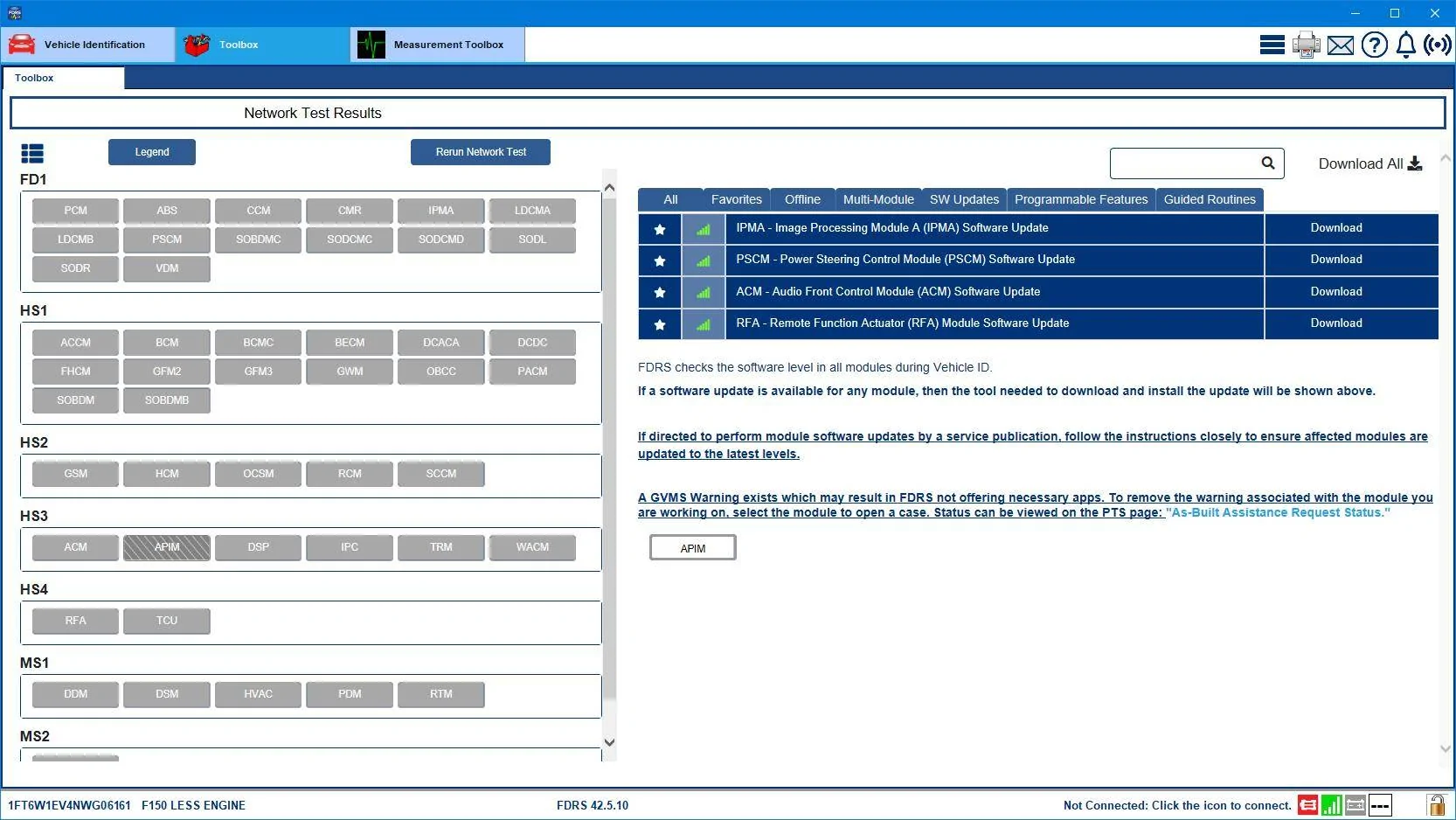

I think this must have been released yesterday because at least one other member found this and did the update already. I had it pop up in my available list this morning, a new IPMA/PSCM combo (along with the "usual suspects", the ACM and RFA).
It's raining here, and will do so for the next several days apparently, so I may not get to this update until Thursday.
Ford F-150 Lightning ECU module programming guide using FDRS Lightning_IPMA-PSCM_9-Dec-24
Yeah, I still have that APIM GVMS warning. It may be related to me enabling glare-free (adaptive) headlights...which I won't apologize for. They're awesome, out here in the woods especially!

So I did the IPMA and PSCM update and got rid of my GVMS warning for my APIM.
Had a break in the rain this morning, so I got the gear out and did the IPMA/PSCM and then figured out why my APIM had the GVMS warning.

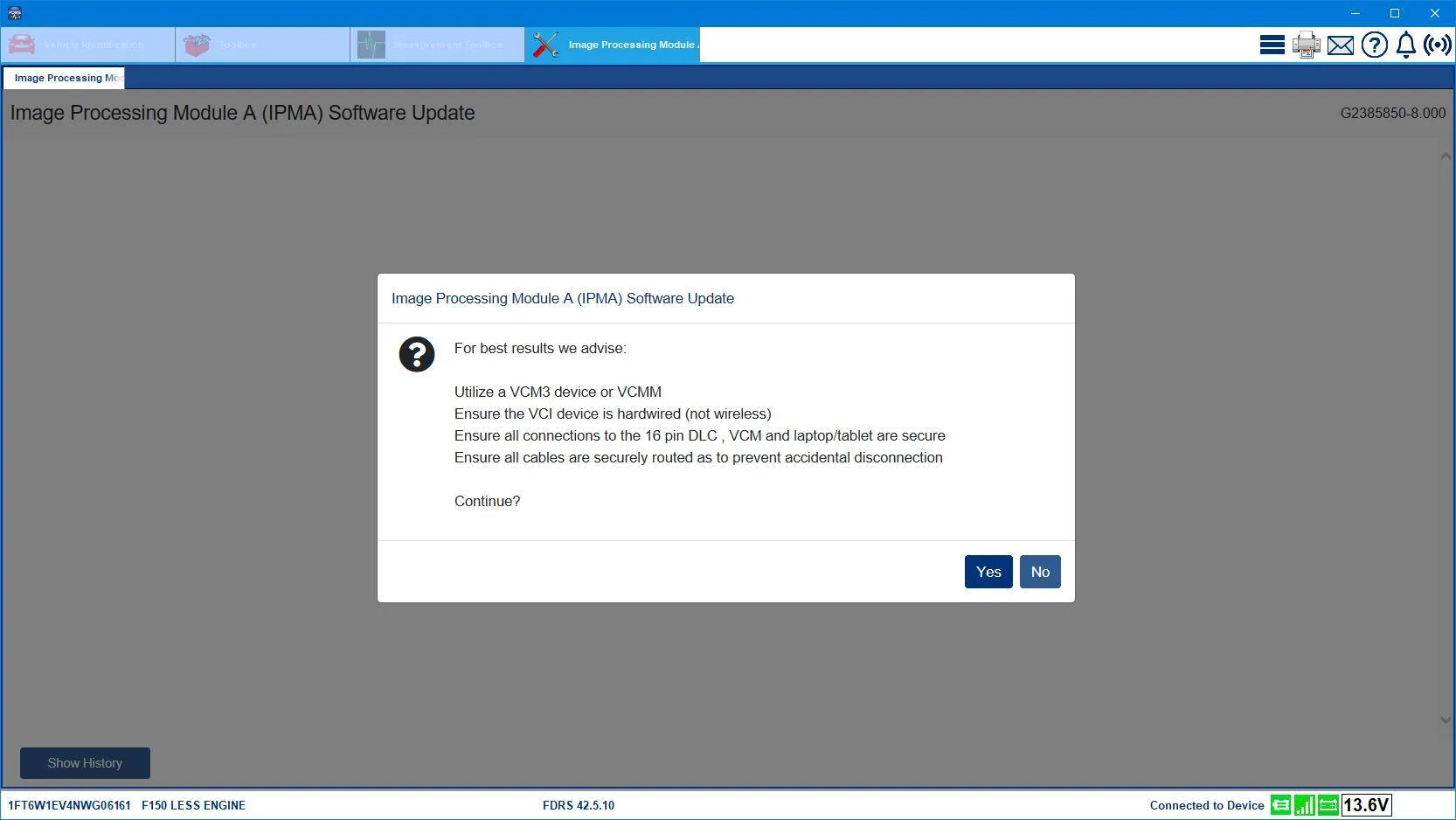

One of the messages I hadn't seen before was this one right after selecting the IPMA and hitting "Run":
Ford F-150 Lightning ECU module programming guide using FDRS IPMA_Update_notes
I do have a VCM3 (eBay sale from a Rotunda vendor).
I set the powersupply to 13.6 and off we went.
It took 48 minutes to do the IPMA software update. But there was a minor snag that others have run into and that was the fact that after the software is updated the script doesn't clear out any DTCs before attempting to do the configuration phase, and I (and others) got a "Stop Safely Now" and "Pedestrian Sounder Fault", etc. as a result in the interruption of traffic on the network. So the config failed. I was asked if I wanted to retry, I said yes, it failed again, so I said no the second time it asked, and we moved on to the PSCM. That took 5 minutes, and this time it did look for and clear DTCs before doing the configuration step.

So to figure out what was going on with the APIM GVMS warning, I decided to attempt a config of the APIM to see if I could put the cloud stored asbuilt values back into it. So I ran the config tool for the APIM and got a message that it failed because some of the values weren't actually on the server, they were missing. :unsure:
So the way to put asbuilt values back onto the cloud server from the vehicle is the tool called "Read the Configuration Data". So I ran that and got a "Successful" at the end...and now my GVMS warning is gone.

So if you do the IPMA/PSCM, be ready for your IPMA config step to choke due to DTCs, but don't worry, you can always go back and do the config as a separate action to sort it out after your PSCM gets updated. Don't exit out of the script just because the IPMA config step failed, let it keep running and do the PSCM, and then circle back to run the IPMA config as a separate action.

IPMA programming note: Ahem......., as a side note you will have to put back the asbuilt value for glare-free headlights (IPMA value only) after doing the IPMA update if you enabled that previously. Those who live in the US and have enabled this...youknowhatImean. :wink:
