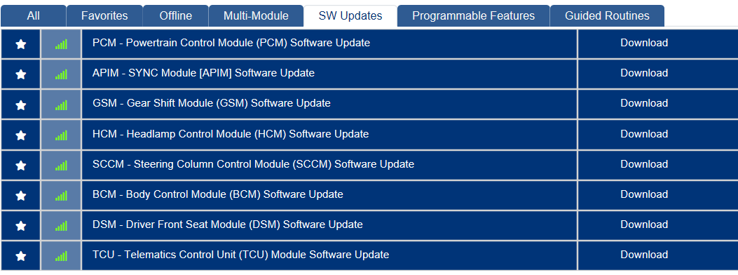

You have a chance on screwing it up just doing the updates so does it matter? PMI is easy, you'll be tricking it into thinking you replaced the module when in fact you didn't. Just follow the prompts as if you did replace it.
Remember, you're doing this at your own risk!
Soo basically I said screw it and was just going to let my license expire and leave the usb in. Had to run to the store quick and ill be damn if the update didn't trigger again. I had to wait in the parking lot at the store for a few minutes to get the restart. Went inside and set a timer for 15. Grabbed what I needed and headed out. Bam update completed. Thank you to everyone for the help. And yes just wait for it (1.7.1). Hopefully you get lucky and it happens sooner than later.
Started updating as fast as I can cause my license expires tomorrow and I have to work so can't do much tomorrow. Got two GWMs updated and then tried the TCU plus APIM. TCU went off and the APIM tried but keeps failing to download this one file. I am guessing a server issue. Hopefully I can try it again tomorrow night and get it go before my license expiries.

Hiya fellas, my VXC should be here in a few days, can someone check my VIN to see what adventures lay before me, TIA
1FTFW1E85MFB79913
Bob_Mac
Bob
Feb 6, 2022
370
231
North Carolina
2021 Ford F-150 Platinum
Cyber Security | Developer
1FTFW1E85MFB79913
Not too bad. Do the Gateway (GWM) first and leave the IPC last.

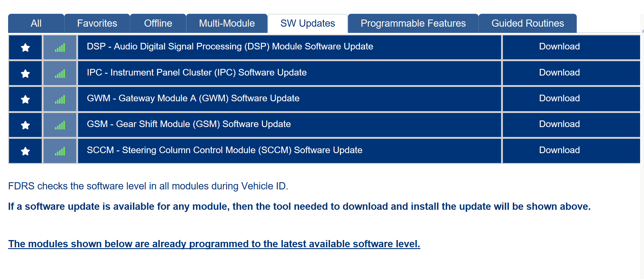

Can anyone with a Job1 that is showing the SCCM update try to track down the VBF files and PM them to me?
I will flash them with Forscan or UCDS
The files are all stored in "C:\ProgramData\Ford Motor Company\FRDS\frds\data\vehicle_software"
you will need to determine which files are for the SCCM
Bob_Mac
Bob
Feb 6, 2022
370
231
North Carolina
I've already been through the update and although I see this under the STRATEGY folder: ML3T-14C579-AH there's no file extension and it's 194KB in size... it matches as to what FDRS states is the latest Software P/N for the SCCM
