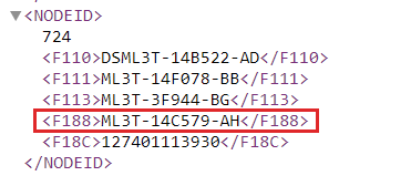

Can anyone with a Job1 that is showing the SCCM update try to track down the VBF files and PM them to me?
I will flash them with Forscan or UCDS
The files are all stored in "C:\ProgramData\Ford Motor Company\FRDS\frds\data\vehicle_software"
you will need to determine which files are for the SCCM
Just grab any Job2 As-Built data, format it to XML, scroll down to very bottom, you will see NODE information there. The SCCM 724 is and Strategy info is F188 field. That should give you a pretty good indication what to look for.
Here's your info:
@tonesto7 here you go then...

Looks like my SCCM is already current
SCCM - Steering Column Control Module
Part number: ML3T-3F944-BG
Calibration level: ML3T-3F944-BG
Strategy : ML3T-14C579-AH
Here's mine
Part number: ML3T-3F944-DG
Calibration level: ML3T-3F944-DG
