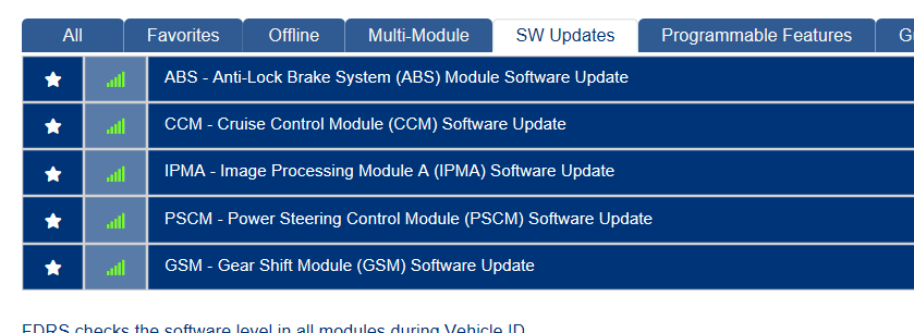

Now that I have my APIM unstuck, if anyone gets an opportunity can they please check and see what I now have available? I had GSM + ABS when I last finished.
Now that the weather is starting to warm back up and I got over 1.7.1 I'm looking to get back on that horse again. Still would like to see an OTA in the meantime but I'll likely splurge for a month of FRDS this time.

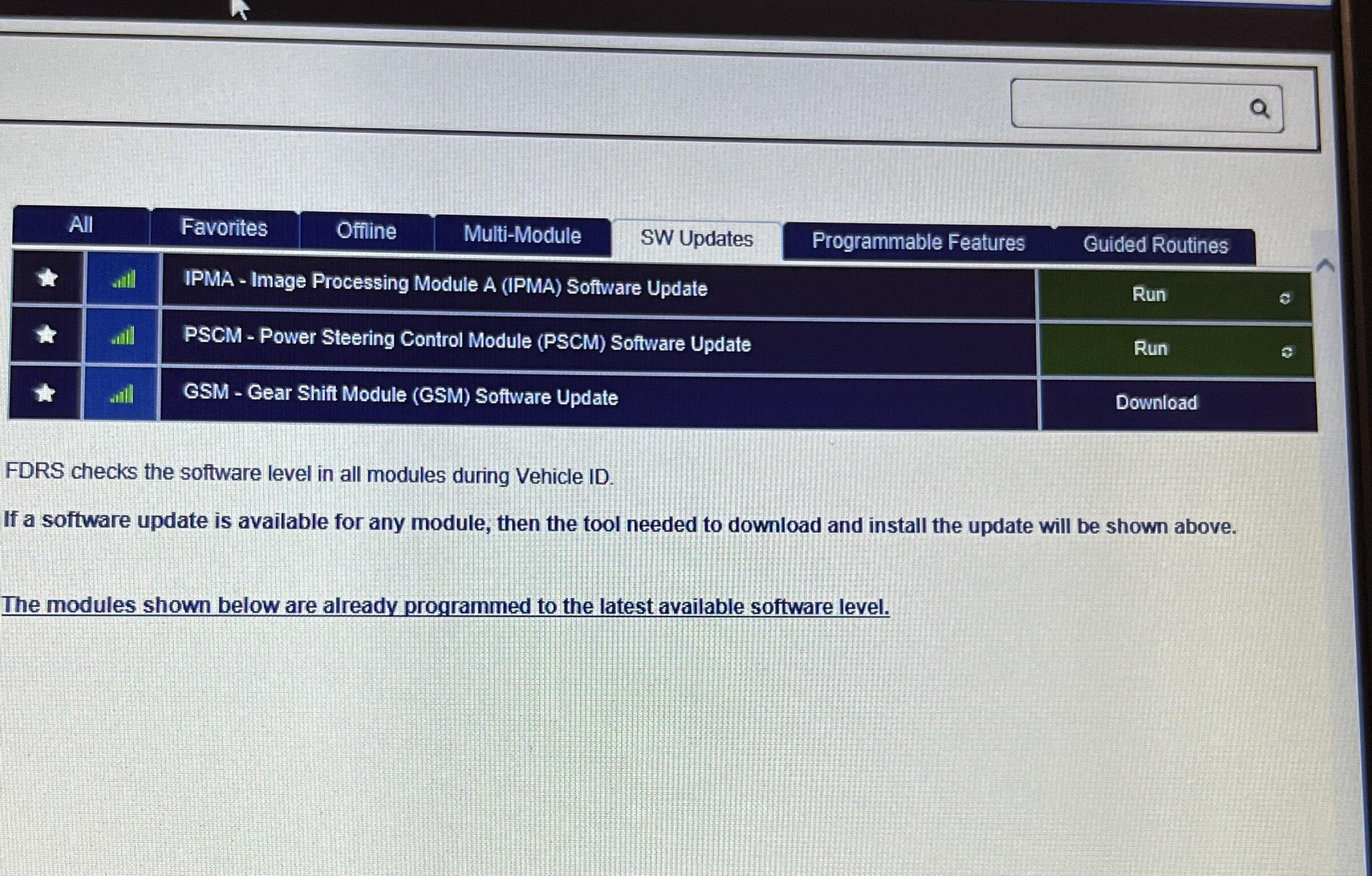

So I finished… it all went successfully as far as I could tell. Ran network test on mongoose and the IPMA still says update along with the PSCM.
Instead I’m going to leave the truck off for 30 minutes, drive it. And see again later.
So like 4-5 hours from start to finish?
