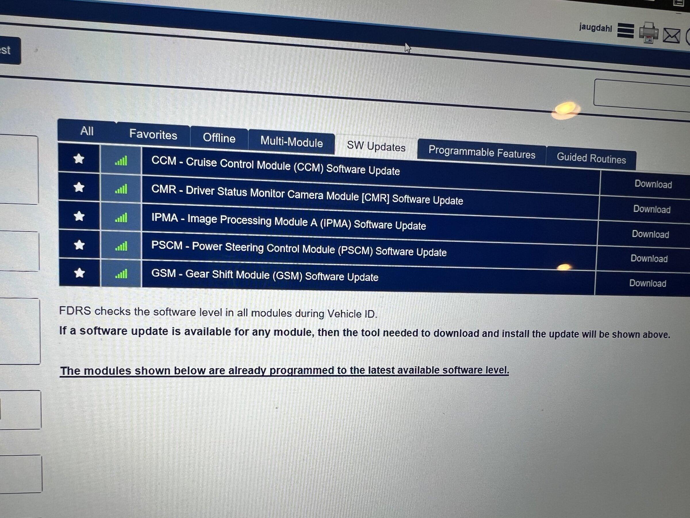

No need unless you have a problem. The last-known configuration will reload automatically when you update the module—or at least it’s supposed to. If it works, don’t fix it.Thanks @JEB for the reply, after I updated my IPC, I did not run the configuration tool, should I have or only if I have enco7ntered issues after the update? I have not noticed any problems and it has been about 2 weeks since I updated it via the CANBUS. Thanks again!
But check for DTCs. If you have U2100, use the PMI function. If it doesn’t work after a few tries, then you might have to reload the as-built data to complete the configuration.
