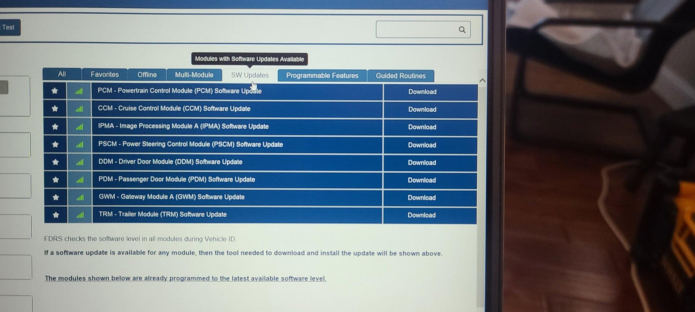

Minute by minute…
Cruise control module, done.
Power steering control module, done.
Driver status monitor camera module, step 2000 of 16430… literally. This will be a while. It
@jmm3807 I see in your most recent pic you have FDRS showing 13.4V. Is that from running of the recommended charger? Whenever I have mine plugged in I hover right at 12.6 to 12.7. Just curious how you got the higher volts that's all.
Well… umm I was worried that maybe my voltage was too low on last updates. So during this one I’ve kicked up the battery maintainer to 20 amp. Don’t know if that’s the best idea but… we’ll see.

The ipma update is the one that will bring it to job 2 /22 camera operation

Also if I recall right these updates didn’t show until I fixed the DTC on my IPC update from yesterday. The mongoose fixed that easily today vs trying with nano yesterday. After that I ran network scan again and all these showed up. Don’t know if it’s all related but I recommend checked for DTCs prior to trying network scan on mongoose.

Minute by minute…

On the IPMA now, 45% done. I think I’ve been on this for 20+ minutes now.
The CMR is complete and takes a long time. Including once it’s done with all 16000 steps. There’s that initializing period at the end where it just sat for at least 15 minutes with nothing happening on the laptop screen.
