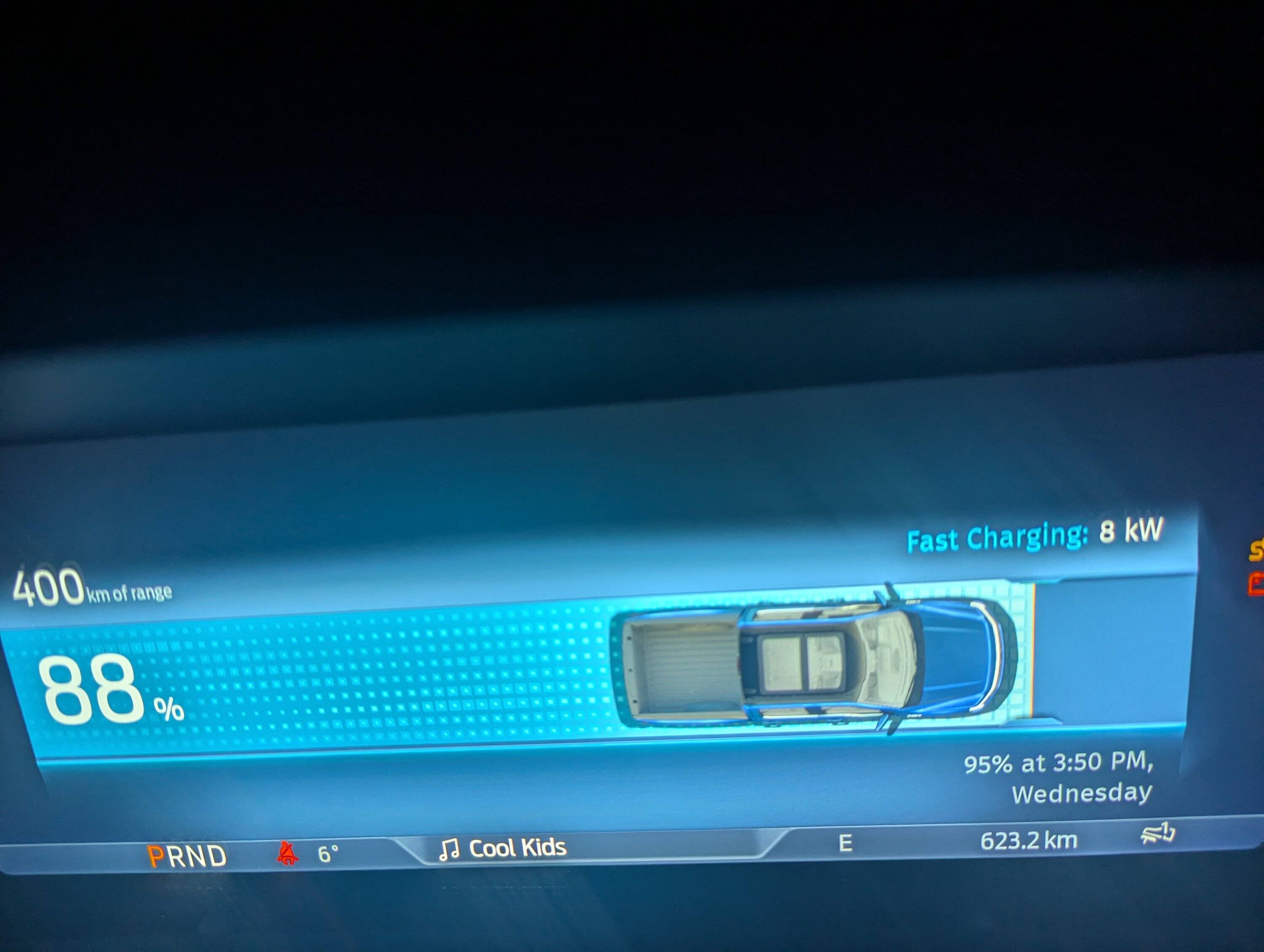

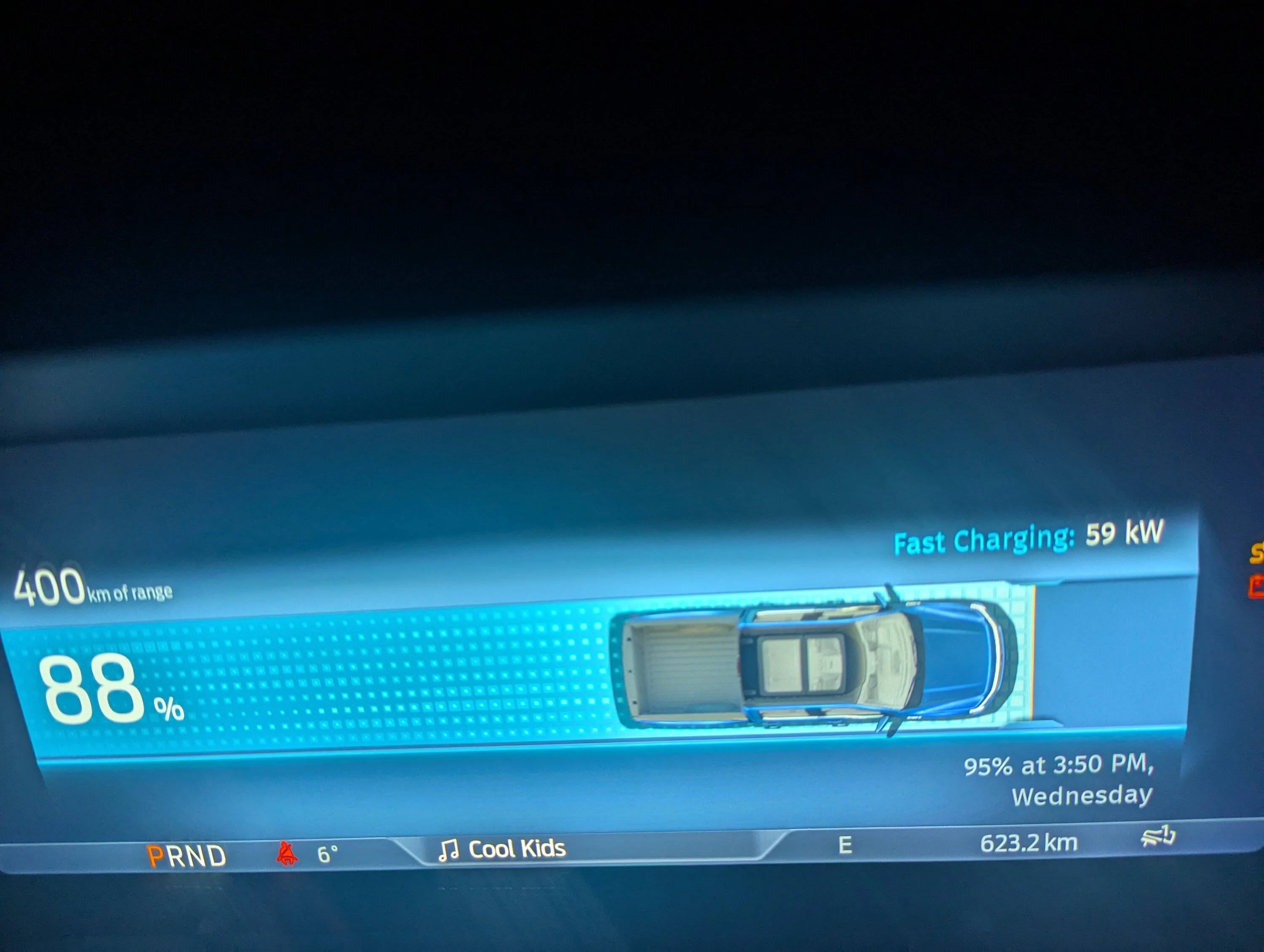

What was the SOC when you picked it up at the dealer? How many KMs on the truck? It can be the battery pack may be a bit out of sync from sitting and inconsistent charging, or from a number of things already mentioned.
If the pack is a bit out of sync from sitting or just because it is new, it should settle under normal, regular use.

They charged it to near full for me, I think it was at 99% when i got it.
Glad to hear posting this that no one else had seen it before. These EV forums are pretty handy sometimes when dealers don't have answers

I saw my 2023 Lariat ER do something like this, though not as extreme when on a 7kW charger, one time. I usually don't bother watching it. The Ford app shows a steady number that decreases as the charge state goes up.
I recently was charging at an EVgo and it went quite fast but while I had it set to 100% the charge stopped at 97%. I suspect the truck said "enough for now" and the charger shut off before the truck said "i'm ready for more". When charging I hear fans going to cool the battery.

As for the original question. I have not seen charging rates jump around like that. My 23 XLT ER drops suddenly to 55 kW or so at 80%, then flat up to 89% or so, then tapers off again after that. I'd be interested to see what the truck and charger are telling each other while it's behaving erratically. Car Scanner might offer some insight. Maybe some strange interaction with that particular charger.
