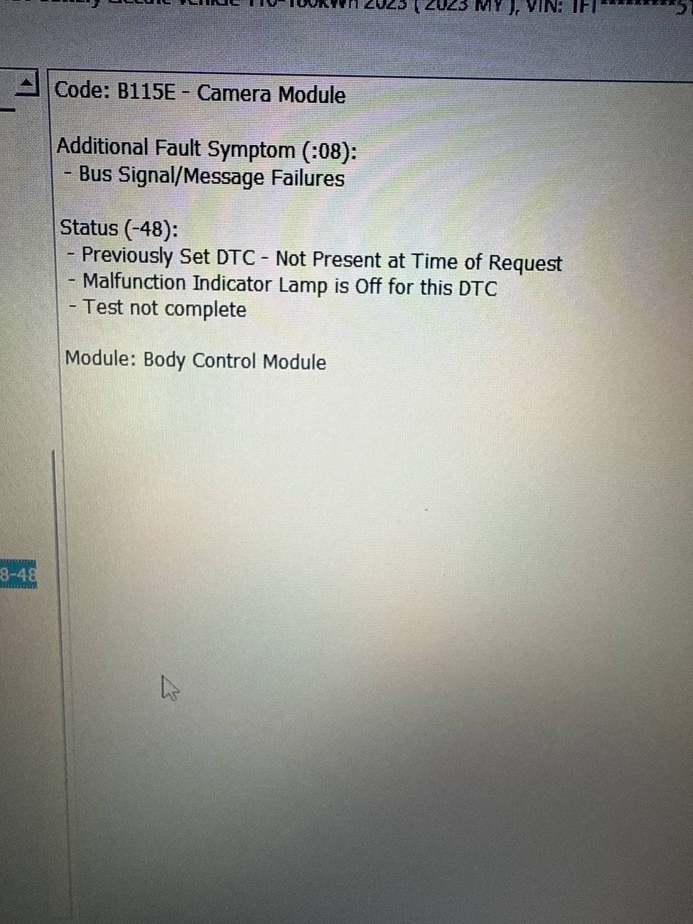

Anyone know what I need to do to fix this?
43
2,225
3,100
I got that code once from the IPMA. Since it is not currently present, just clear it. Mine didn't come back. Communication errors seem to happen occasionally between modules. Sometimes an OTA will cause it.
Do you have any more info like it wasn't present, then you did x, and now it's there?

i have tried clearing it several times. I honestly just now paid real attention to the DTC. I have made a few changes:
glare free headlights
50/50 view
Disable seat minder
Enable camera at speed
Walk away lock
i have noticed when my front sensors activate the front camera does not display at times.

I would undo all your changes. Then do them 1 by 1 until you end up with the DTC or Camera issue. Reset modules after applying changes.
