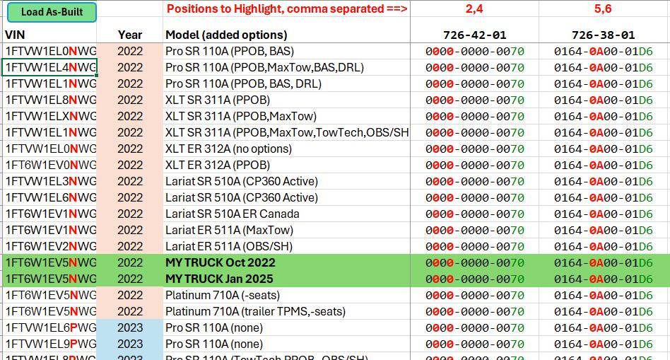

Not a database per se. I have the .ab files and window stickers that I have slowly accumulated. I then built an Excel spreadsheet where I can enter any parameters I want (with the highlighted byte/nibble) and a macro loops through all the As-Builts (plus a few ICE) and shows me the values.
Here is a sample:
Ford F-150 Lightning F150 Lightning FORScan thread - Version 2 1745532540882-l8
(VIN column clipped to mask VINs)
I've built databases in Access, SQL, SAS, etc. in my career but for things like this I still love Excel and VBA. Quick and easy.
