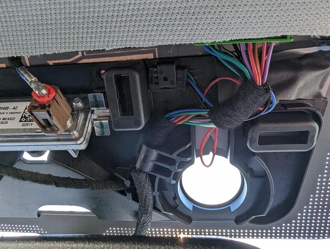

Got my rain sensor in today, plastic protector came off in shipping at some point so the top of the sensor got a little marred up, hopefully doesn't affect anything.
But the good news is they must've just used the same wiring harness for the trucks as my '23 had the plug clipped in as previously mentioned in this thread. I initially didn't see the Rain Sensing option show up in the Wipers menu, but once I Pulled the negative terminal off for a few seconds and restarted the truck, it appeared.

Pulling the negative battery can be avoided by resetting the modules after you program it in Forscan.
ADD must've kicked in while in FORScan since I forgot to look for the reset options. ?‍♂ I even thought to look for it after changing the codes.
