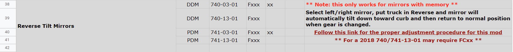

Has anyone tried the "reverse tilt mirrors" from the old 2015-2020 ICE FORScan google doc? I had this setting on my 2016 and 2018 F150s and it was a game-changer for parking along curbs.
Here's the settings from the 2015-2020 community google doc I used in the past successfully:
Ford F-150 Lightning F150 Lightning FORscan thread 1677770745579
3,751
4,814
Reports from several months ago were they have been tried and no one was successful at making them work.
I tried several months ago, with no luck. Not a big deal, just reversed all my changes.
Shucks... really is the most useful mod I've done in the past.
My current workaround is I have my driver-side mirror reverse tilt saved in memory #2 and passenger side saved to memory #3. Not ideal, but it's better than nothing, I suppose.
Hoping someone finds a solution to have it work the way it does for the 2015-2020s

I also tried the reverse tilt mirrors. They do tilt but do not stop at the bottom of the range they keep going and start clicking. I read on a machE forum you have to set where you want them to stop but that didn’t work either.
