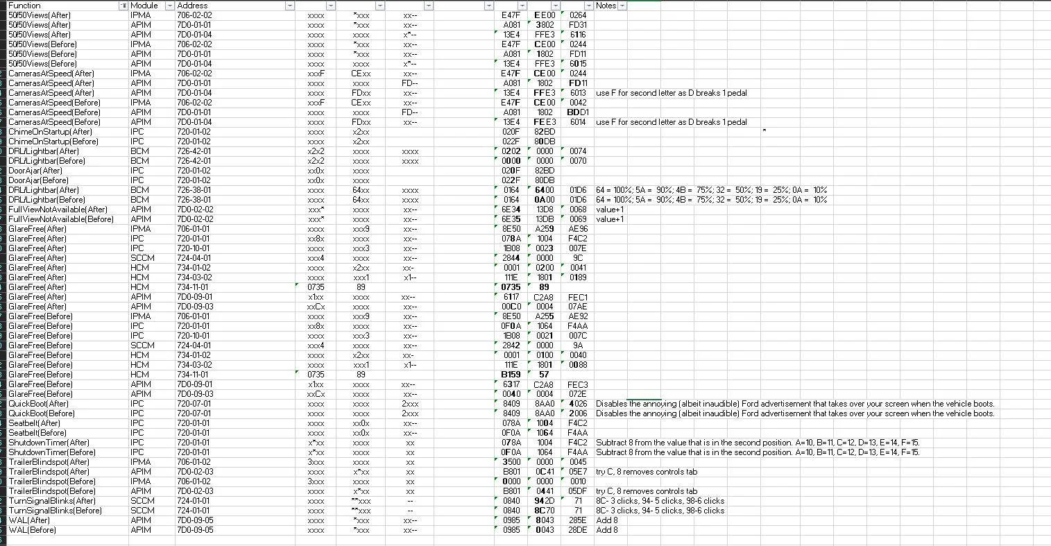

I have a Canadian 23 Platinum and don't have it either. So I don't think it's a trim thing. They must have been caught from some Canadian authority and told to turn them off here too.
I would really love to have the matrix lighting too but I don't want to mess around with software considering we get OTA updates. My truck seems to be very stable compared to issues many others report they have with software. I would hate if there was some sort of future conflict and then when I bring it in for service, get the "You changed the settings which caused the problem so here is a huge bill for us to figure that out". I must be getting Old... I would have definitely done the change by now when I was younger. Guess I've gotten wiser from messing so many things up. lol
Just back up the modules before making the changes or make note of the existing values. Then you can easily change it back. I have a whole spreadsheet for the values I've modified.
So do you change them back before you apply every software update? If Not, how do you know if Ford's update is not making some of the same changes that you already applied. If you have a problem and switch everything back, then those settings would now be wrong too because you are turning things off that the update turned on.
Not trying to discourage people from doing it. I understand that (if you some level of competency) it's relatively easy and safe to do so, and the chances of what I said above are slim. BUT, this isn't some throwaway device that you can go, oh well and toss if things go bad. They are expensive, and still under warranty. That means I will be forced to deal with the consequences (bricked truck) and costs to get it fixed. There is a low level of risk involved that I am not willing to take so early into ownership. Once the newness wears off and I have no more warranty, I would be willing to take more risks by playing around with these settings.
Those of you seeking strangers to do it for you is even a worse idea. First of all you have no clue what they are doing so if they mess your truck up, then what? It's not that hard to do. You are way better off doing it yourself and keeping records as PJnc284 does. That way you know how to do it and you can undo things should down the road the community says to make sure you undo your matrix light setting before accepting Fords latest OTA update.
