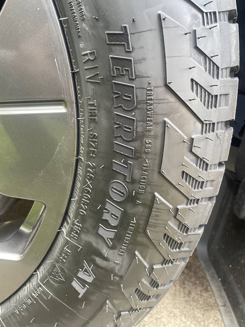

The Goodyear WRANGLER TERRITORY AT 275/60R-20 come on the new Rivians same weight capacity as the grabbers. It’s a EV tire. Quiet as grabbers and getting initially the same average mi/kwh as well. Got them from Discount Tire. Good price as well not sure how long they will last if I get 25000 miles I’m good I chirp the front wheels all the time and that will affect wear.
My 23 XLT came with these tires from the factory. So far so good - no complaints!

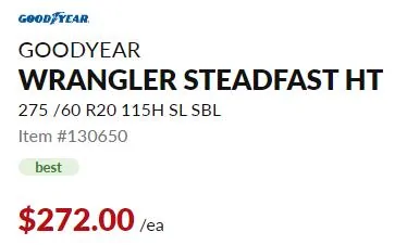

What is the Goodyear tire that Ford is now using to replace the all season General?
(Found a picture - it’s the Good Year Wrangler Territory HT tire.). Does anyone have any experience with this tire? Is it as good as the Michelin Defender? Is it more or less efficient (range wise) than the Michelin?
Discount website says the Territory is discontinued. It came up with this as the closest match:

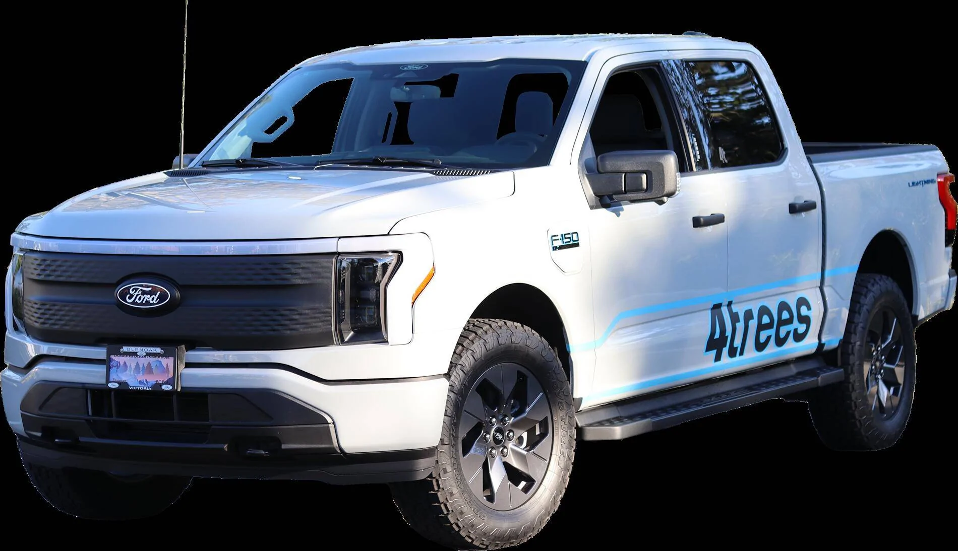

I'm at 2 years, 30k on my 2022 and my OEM All Season General Grabbers need replacement. (I Found this tire wear to be in line with what I expected from an OEM tire, EV truck, and my fairly aggressive driving)
I am struggling to narrow in on a selection and need to do so ASAP because these tires are shot and winter is coming! Any help / input is appreciated... below are my considerations.
- Considering both All Terrains and All Seasons. I've never had All-Terrains on any this or my last truck but am considering it. Maybe I'd love it!?!?
- OEM Grabber all seasons were dissapointing in Winter so not considering them. Winter driving is important (Wisconsin)
- Off-roading is irrelevant. Pavement princess.
- IMO, Trucks look better with all-terrains on them.
- If going All terrain, I'm concerned about how bad the range would be affected, but it's not horribly important because I generally am not going long distances where I am pushing range limits.
- Minor concerns about road noise, if going All-terrain? Should this be a concern or not? My kids are likely way louder!
- I dont want to switch between all seasons, and snow tires, I want 1 tire year round... seems like big hassle to swap twice a year.
- On my Nissan Titan I had Michelin DEFENDER LTX (all-season) tires and those seemed to perform well.
- Obviously a tire known for good tread life is important. I would like to get better than 30k out of a non-oem tire.

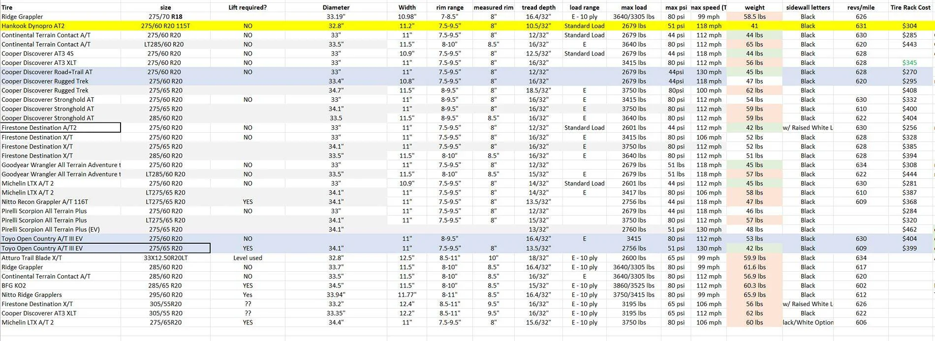

I did a bit of research and had settled on the Toyo Open country A/T III EV's, but put on a level kit and wanted to see how that impacted range for a few thousand miles prior to swapping out the tires.
Interestingly enough, so far (1,000 miles in) the Eibach level kit (part #E60-035-61-01-10) has increased efficiency from 2.3 Miles/kW to 2.5 Miles/kW according to the trip guess-o-meter. That is at the 2" setting on the Eibach's, they can go up to 2.5". They also got rid of the floaty feel of the OEM shocks.
But back to tires, I put together this handy chart, which has a lot of information, most of it from TireRack:
Ford F-150 Lightning Help: Can't Decide - Tire Replacements Capture
The OEM Hankook's are in yellow. The main ones I was considering are blue. Interestingly, the Toyo Open Country A/T III EV in the 275/65 R20 (a 34.1" tire) are lighter than the same model in the Lightning stock 275/60 R20 size (a 33" tire). It is also worth noting that the amount of tread on the taller tire is less than the stock tire, so maybe that is why its lighter? If you can't read the pic PM me and I'll send you the Excel document. Also note the 34" tire might not fit if you aren't willing to install a lift/level.
