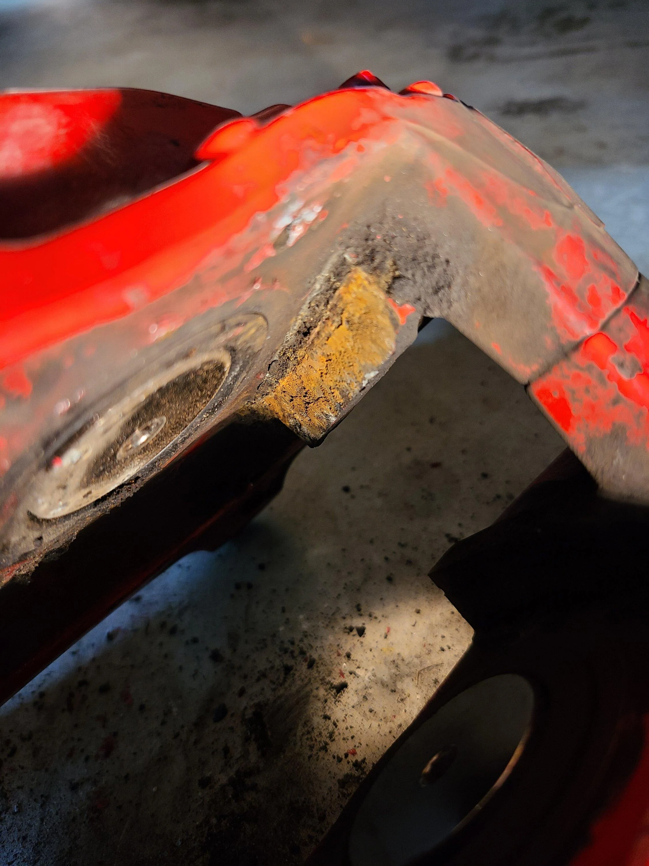

I replaced the front brakes on my Model S at around 50k. The pads were seized in the calipers and the rotors were grooved. Braking performance was terrible. If you stick to regen as much as you can (and you should!) then the brakes don't move much. However, this movement helps keep them free from grime that can cause them to corrode and rust. Here are my brackets during service.
Ford F-150 Lightning I Don’t Miss the Brake Dust front brake bracket
Not sure if this is indicative of all EVs or if it's just a Tesla problem, but it's worth keeping an eye on, especially if you're in the rust belt (my car was originally from Chicago).
+1 on ceramic pads. I use Bosch QuietCast ceramic on both my Model S and Ridgeline and they've been great.

On a regular basis, and after washing the vehicle, simply shift to N while driving and gently apply the brakes a few times to clean the rotors and ensure everything is moving freely.

I dry the pads after washing by driving up and down the driveway and shifting to N.
If you wash the vehicle and then park it, and you use Autohold or 1-pedal, the pads may stick when you first start moving the next day. That's why I dry them.

You guys bring up an interesting problem - pads rusted to pistons. I never had this problem because the pads were never on more than 2-3 years, even less on my wife’s car. Will have to watch for this now.
