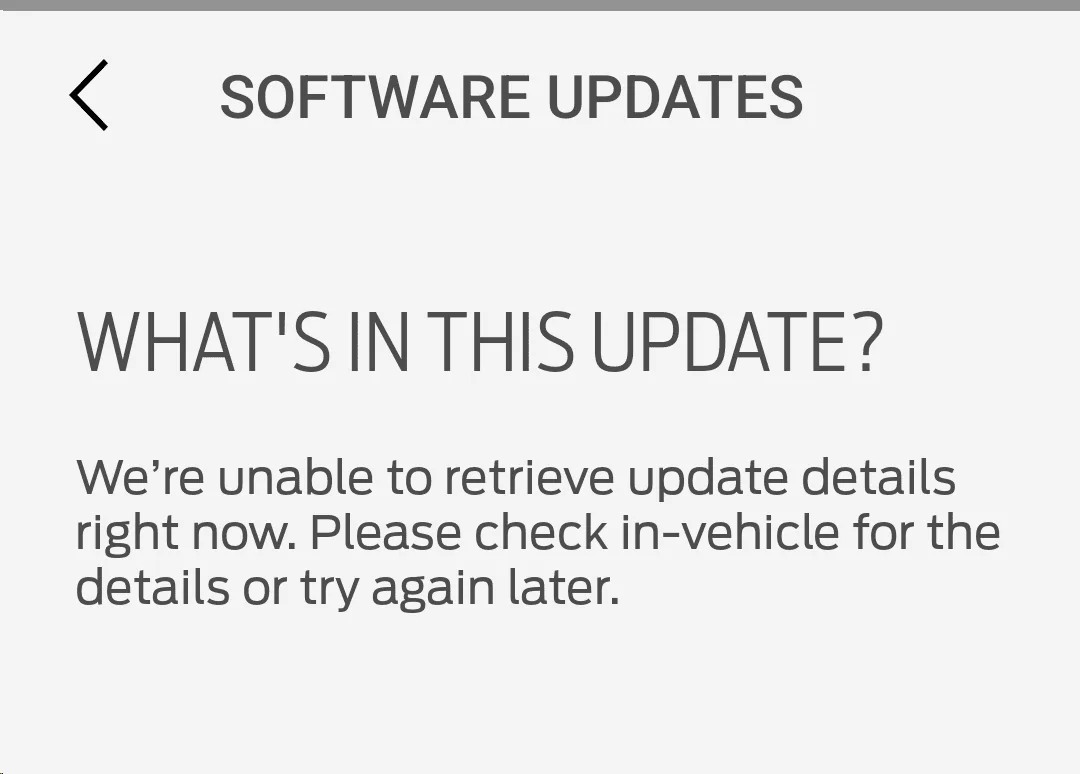

This update has no revision number. That's why they call it "Voldemort". Update details are in the box in the middle of the screenshot below.

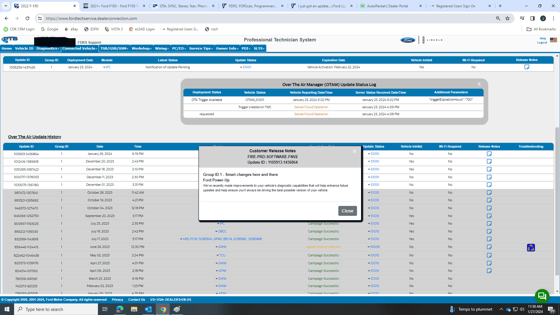

@Lytning That's weird. I blacked out the VIN for your privacy, but the attached screenshot shows the OTA trigger was created for your truck on 1/23 for 6.8.0, the no-name update OTA was sent after this one and went through while this one was sitting in the queue.
Do you understand the update ID? Sometimes the number on the right goes up when the number on the left goes down and vise versa. Do those numbers mean anything?

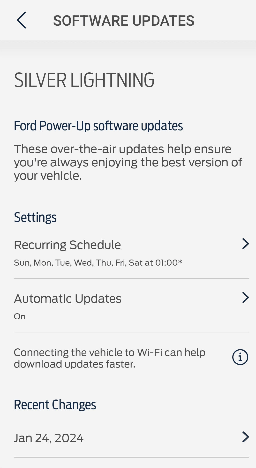

Many of us nerds, keep an eye on every update, logging them for historical reference.
See my signature below for recent updates.
Fordpass / Vehicle / Features & Settings / Software Updates / Recent Changes / > / shows most recent posting.
Keep track of that this point forward. We customers do not have direct access to the complete manifest of received updates but our Ford technicians have this information.
I'm not seeing the "Recent Changes" option, anybody else in my boat? Also, while I'm at it, is anybody else's WiFi turning off by itself in the vehicle?
Once you get an OTA it will appear, briefly .... the details are no longer visible .
